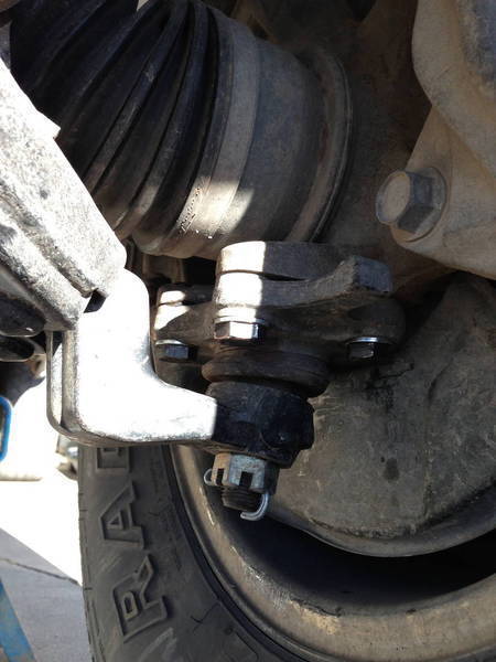

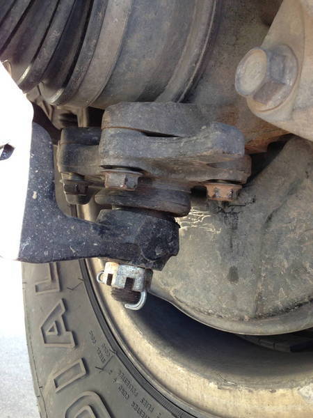

    Got them fixed! Blue Loctite and a large torque wrench.
    Old:
    New:
