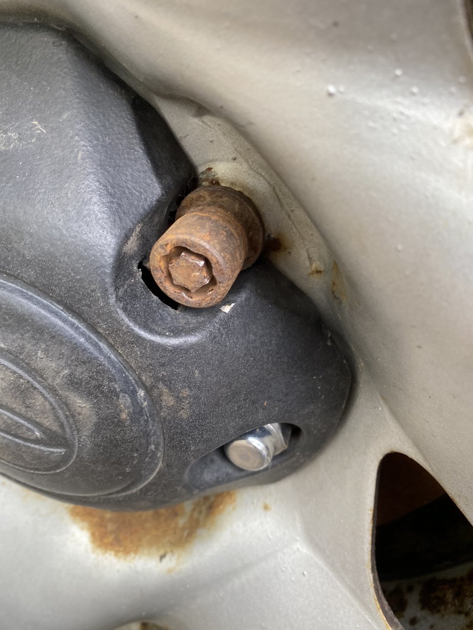

    My locking lugnut key stripped out…any ideas. It’s a McGard. Going to just get rid of the these damn things at this point but I’ve got no way of getting them off now

    Weld a nut on if you have a welder .
    Take it to a friend with a welder .
    i swear those things are more of a pain

    I use an air chisel, which isn't standard fare for most guys at home.
    There are extractor sets, but honestly just take it to a tire shop and they'll bust them off for you quick.

    Then I bought a set of Twist Sockets (https://www.amazon.com/gp/product/B076WQMSVB?ie=UTF8) you bang them on with a BFH, and then spin them off. Worked on all four of my properly torqued locking lug nuts. No welding, etc..

    Welding should not be required for removing locking lug nuts, you can use the correct tool twist/turbo sockets or you can hammer on normal sockets that are a hair smaller then remove the socket with the lug nut and beat it out the socket

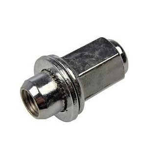

    Anyone got a link to a set of lug nuts I have no idea what I’m even looking at. I believe mine are OEM

    Those locking ones I linked to are the same style as OEM...
    OEM look like:
    at least for this model wheel:

    Just hammer a 19mm socket on to the lug nut. it should be tight enough to loosen the nut. before you unthread it all the way wiggle the socket off the lug nut and then do that 3 more times.

    a ‘ burp gun ‘ an air impact wrench with a socket that will fit tightly over the Lock Lugnut
    can most times loosen it up
    takes a whole lot o wrong to strip 1 out ........................

    extractors work if you have some that big.

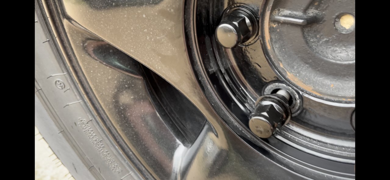

    EOTH 24PCS M12x1.5 Black Wheel Lug Nuts, 13/16 Hex 1.87" 47mm Length Mag Washer Style Black Lug Nuts for Tacoma/4 Runner/SR5/TRD/FJ Cruiser/GX460, OEM+Factory Replacement https://www.amazon.com/dp/B08MQDD6QV
    Went with shorter ones

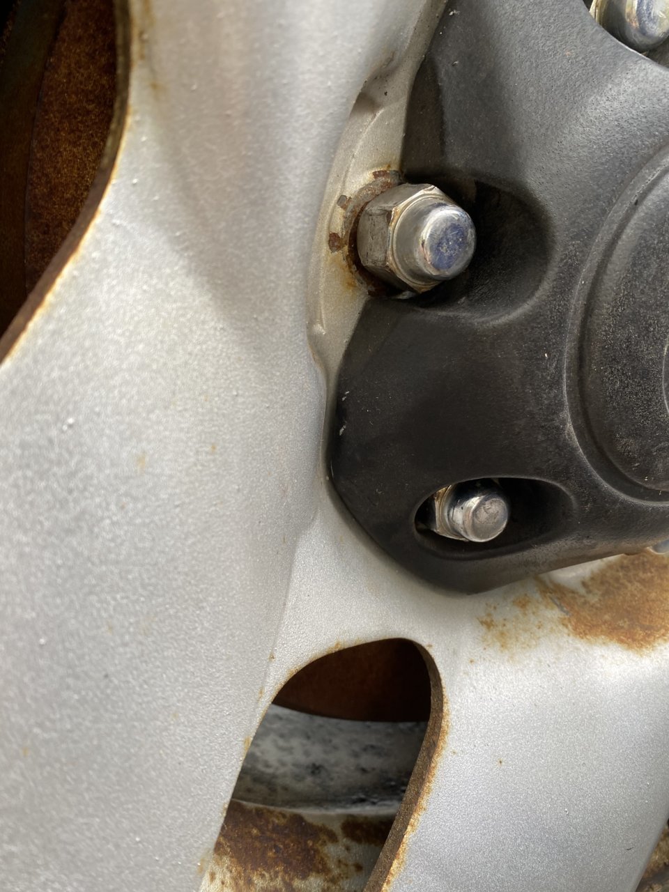

    These look absolutely nothing like mine, but I guess I'll give it a shot

    I think if you saw how rusty the locking lugnuts were it'd be apparent why there was an issue. They weren't stainless, chrome plated or anything, just lots of rust and they've got 160000 salty miles on them

    Those are steel wheels those don`t use the short shank lug nuts like the aluminum wheels that everyone is linking to

    grind out a little of the outer ring and make the center more of a hex that will fit a socket :)

    Just beat a 19mm impact socket on it and take it off, you'll have to beat the locking lug out the socket then move on to the next locking lug. I've done it many times without issue on that style of locking lug.
