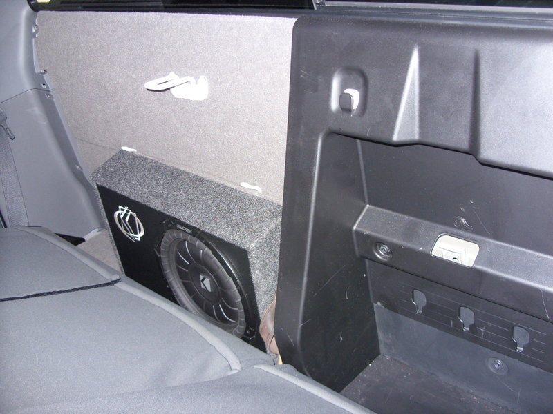

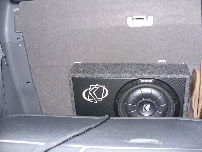

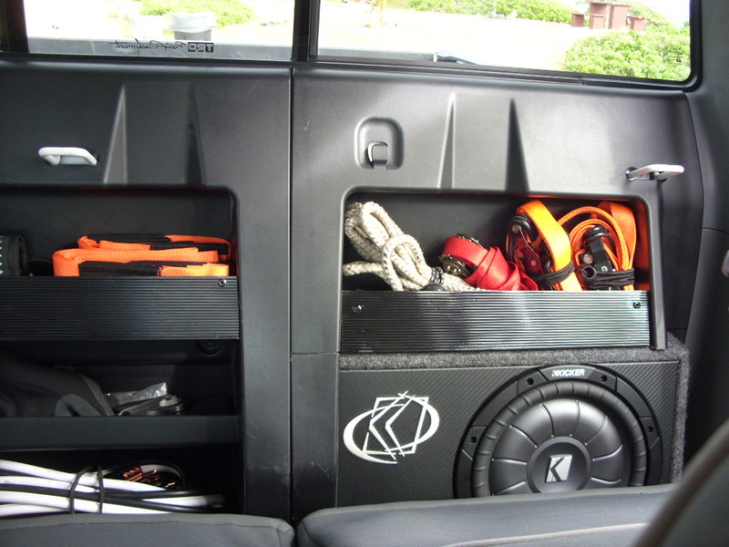

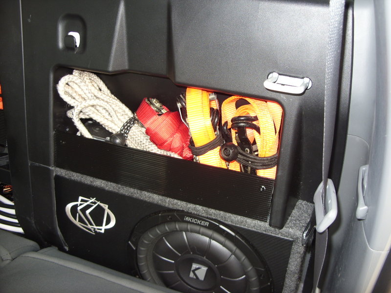

    Got the slim box in mine .Had plastic storage out but ended up trimming driver side and mounting sub back in.

    That looks great! Is that just the comp slim box ?

    No not the comp one . Was on crutchfield and the comp one is slighty smaller so should work. Think mine is the 10TC104 one .

    Wont fit with plastic bin . I had to cut drivers side bin to fit. You can just take out drivers side and leave pass side one . The comp one seems like the better one. Going off Crutchfield site mine is 21 3/4 W x 15 H x 7 11/16 lower depth and 4 3/4 top depth.
