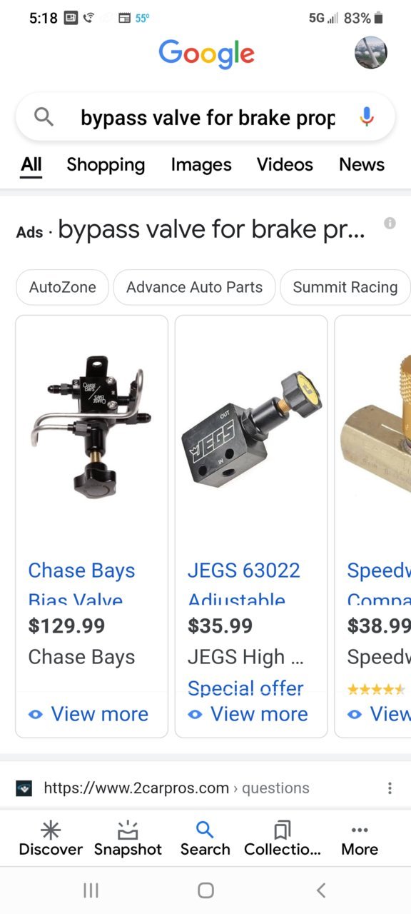

    Return the brake proportioning valve and order one of these...... I have the jegs Screenshot_20210330-171804_Google.jpg on my 96
    Ritchie likes this.

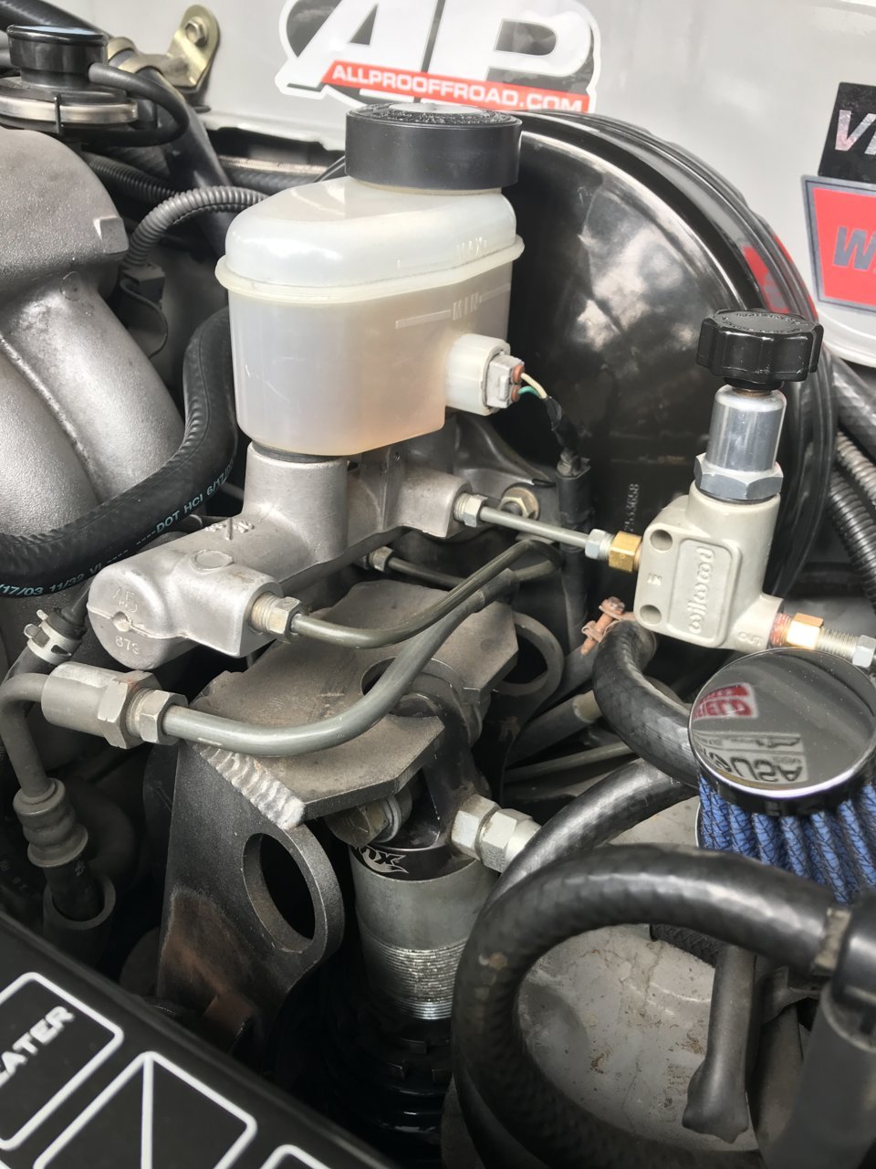

    Get rid of the LSPV and go this route with a Wilwood unit.
    You can dial in where the rear brakes come in also.

    It is definitely not a ‘bypass’ setup.
    It’s like the Ronco oven, set it and forget it. Works like a charm.
    It did take me about an hour on a dirt road to dial in.
    My truck stops on a dime. Others that have this may chime in as well.
    After I did my solid axle conversion, the Diamond axle didn’t have provisions for ABS.
    Once I did the rear Diamond axle swap with discs, same thing, no ABS provisions. This didn’t bother me as I had previously researched what I would implement.
    Once you dial in this Wilwood unit, there is no need moving it.
