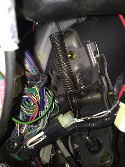

    This is the best I can do for ya.
    There's a tab behind the lower dash panel that the spring connects to on one end. The other end connects to the outside of the clevis where the cotter pin goes through.
    This is on my 98, YMMV.

    Those are good pictures. I've never seen that tab - only felt it. As I said, I've got a wire bundle running across in front of it.

    Thanks, Madjik Man. Those pictures are perfect. Now I need to go lay underneath my steering wheel for a bit.
