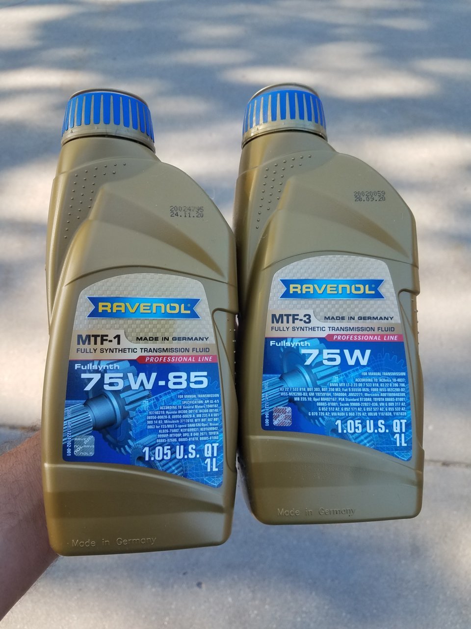

    I used this flavor in my 2017. I haven't done the front differential or MT yet, waiting for next oil change. You far from Nebraska City?20210822_180620.jpg

    It's not that difficult of a job changing the differentials and transfer case oils. I'm right outside of Nebraska City if you want help changing them. I think as others have mentioned the regular variety of 75w-90 gear oils would work. I just bought this particular oil because it was way cheaper than Toyota name fluid. I just change mine because it's cheap and easy to do myself. Neighbor/coworker burns oil to heat his shop so disposal of old never a problem.
