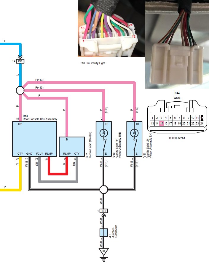

    I have a 2017 AC utility model. I have added a sun visor with mirror and lights. Want to power lights from overhead console. Need help identifying a 12 V Hot and ground in the single connector to overhead console i. e. wires to map lights any help? IMG_0356.jpg IMG_0355.jpg IMG_0352.jpg IMG_0350.jpg IMG_0352.jpg

    Do you have a Meter, that would help identify Power, Accesorry Power, and Ground

    Some vehicles will still have a factory plug taped or glued to headliner even if it' not used. You might check under your headliner.

    Also, if you cant get good contacts in small connectors, try sticking straight pins into the slots and measure off the pins without letting them touch each other.

    Damn YOU Toyota! Found two wires with 12+ volts in only harness in the overhead (pictured in 1st post.) However when the vanity lights grounds the circuit, either the overhead or map lights up, only about but 85% lighted. but do not want to stress anything so for now NO Vanity lights by the mirror!

    Im looking into adding this to my truck as well. could you explain how i would tell the difference between power and accessory power? im not sure what that means new to car electronics.

    Power is constant 12 Volts, Accessory Power would only have 12 Volts with the key in the "On" position.

    Tap into the pink #15 and the white with black runner #12
