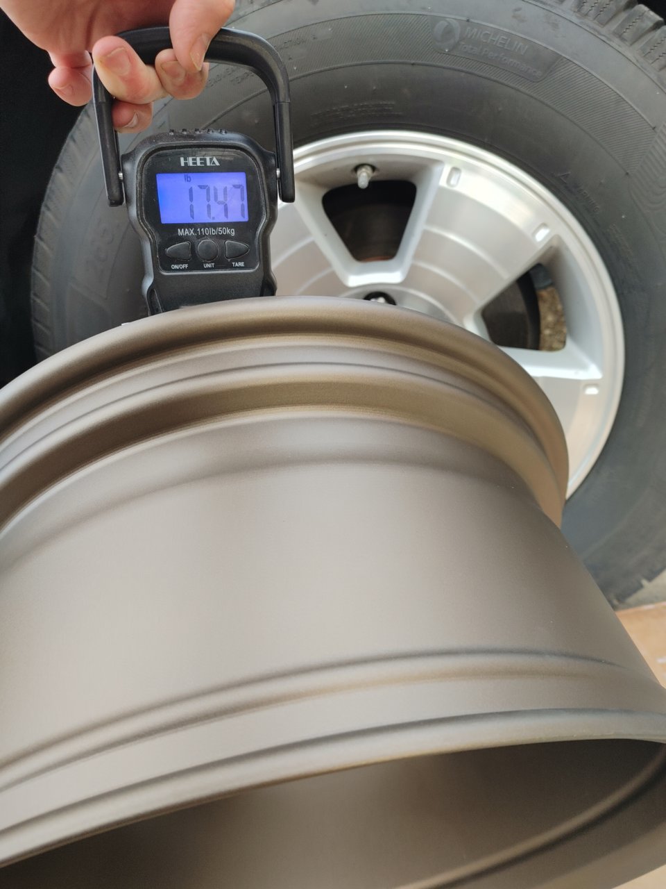

    I have the same OEM wheel currently paired with a 265/65r17 Michelin Defender ltx m/s. Approx weight of this setup is 64.5lbs.
    Will soon be replaced by FSW Pro Style 2020 measuring 16"x8" and weighing in at 17.4lbs.
    https://www.tacomaworld.com/threads/finally-bought-some-wheelz.758415/#post-27032502
    Not sure which tire it'll be paired with in the end... I got my eyes on a couple different 265/75r16 A/T's. The new tire could weigh in at 47lbs and it would still match the current OEM setup.

    KY Joe
    KY Joe Well-Known Member
    Feb 2, 2022
    #389121
    63
    Joe
    Louisville, KY
    2014 AC TRD Sport
    Wheels are in... Just waiting to get the tires.
