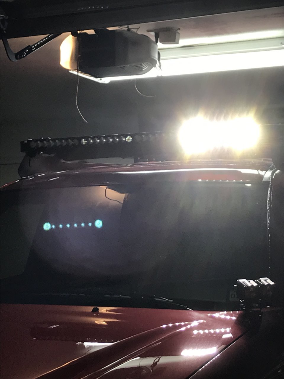

    hello everyone. I was hoping someone has ran into this issue before, or had some insight.
    This morning, I installed a Baja Designs S8 40” bar on my front runner rack. The bar is being installed into a Switch pro 9100. Due to the Switch Pro, i make my own harness, which is just three wires into the switch pro. All the wires I am using 12 gauge wire.
    I installed the light bar this morning, and everything worked great from the Amber backlighting to the entire bar. When I got home from the grocery store, I was double checking everything and now only one section of the 40” bar lights up, while another section is dimly lit, and the remaining is not lit at all.
    Also, the amber backlighting is only active on 25% of the bar. I double checked my connections and I re-installed the three prong quick release connector (not sure what these are called but are included in Baja Designs boxes) and still nothing.
    Anyone has any ideas on what to do? I did check my add a fuses and it is intact. All other lights and accessories tied into the switch pro are working fine.

    No worries... it would seem there is a short leading to those leds.

    It’s not getting enough power. When I hook up any light to a 9V this same thing happens, so I’m guessing that may be your issue

    Light is being wired from my 31m Northstar battery if that matters. Switch Pro says I have 12.24V.

    run some wires up to it direct from the battery. if they all light up then you know the wiring is the issue. if its still bad then it could be the light. if its still not lighting up, i would pull the bar and wire it direct with shorter wires just to make sure its getting full power.
    now if it still doesnt light up, you can wait to hear back from BD or you could pull the lenses and see if any of the jumpers came loose.

    Well finally have an update. Waited till it was not as hot (even though it’s still hot) and I removed my bar. Placed the bar on my hood and the 12 gauge cables are about 20” in length. Don’t want to cut the connection on the bar, so just shoved the wires into each designated hole. Wired the bar directly to the battery and nothing else is running. I’m getting the same results as yesterday unfortunately.

    Most likely there is a ground issue on the circuit boards causing the 3 sections to go out. It's possible the circuit board screws loosened up very slightly. We are happy to take care of this
    Please call our tech support team at 800-422-5292 or email info@bajadesigns.com
    We are closed for the long weekend but will definitely get you taken care of ASAP

    So it looks like one of the jumps came partially out, so fixed that but then got a different result. I think there is just a defective item on the 2nd board causing the issues...

    Keeping everyone up to date. Spoke to a Technician via email this morning and chatted with him over the phone this afternoon from BD. After discussing with him everything we had done similar to the above, he decided that it was something to do with the panel either grounding, board, etc. Since I had owned the bar less than a week, he is going to be sending me a new bar and asked me to send my existing bar back to him with a shipping label provided by BD. Unfortunately, the housings are out of stock, so it doesn’t look like they will be able to make the bar for at least a week, so hoping I have something in two weeks (ish).
