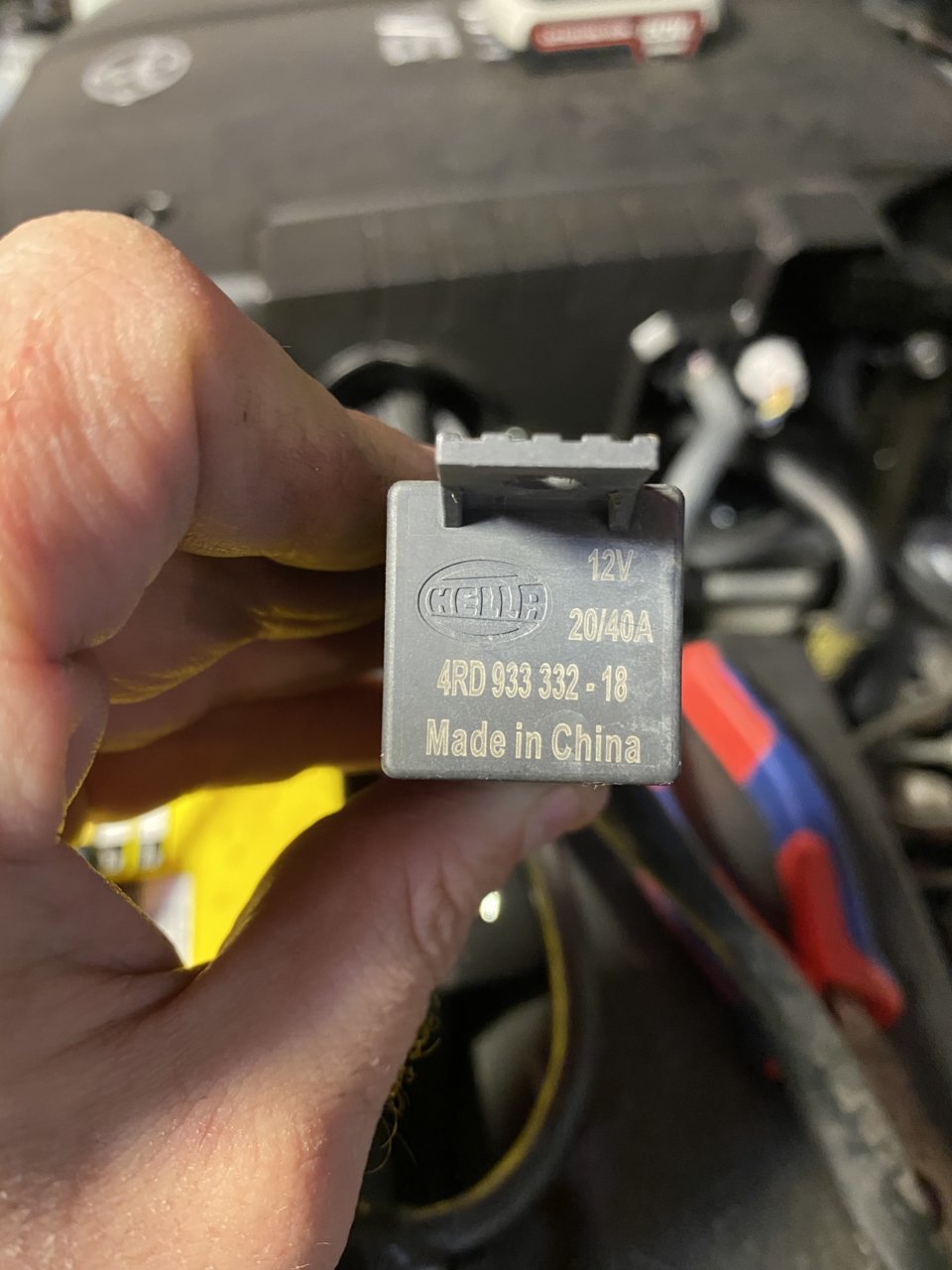

  5. Dec 13, 2020 at 2:25 PM
    Perfuseme
    Perfuseme [OP] Well-Known Member
    Feb 16, 2016
    #178419
    426
    Rick
    this is the relay that came with it...says right there, made in China...maybe that’s the problem.

  6. Dec 13, 2020 at 2:40 PM
    windsor
    windsor Just a guy
    Dec 31, 2014
    #145322
    7,661
    Homeless in Oregon
    2008 Tacoma Super Duty aka Tundra
    Canopy, fitted seat covers, OBA with self leveling air bags, 100w solar, dual Rhino Rack Pioneer platforms, side & rear LED work/FU lights, CB, cell booster. 7x16 cargo conversion, 3" lift, 7'x6.5' fold down aluminum rear deck.
    Open it up and see how dirty/wet the contacts are.
  7. Dec 13, 2020 at 3:32 PM
    Perfuseme
    Feb 16, 2016
    #178419
    426
    Rick
    yeh, wasn’t really and shouldn’t have much reason to be. I hit it with a wire wheel and hit with compressed air. Il probably just order another and keep it off until then. If it’s not the relay it may be something in the switch.
