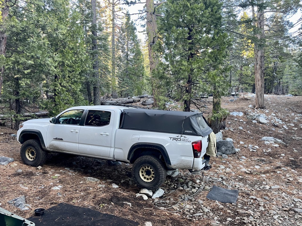

    I had the Bilstein 6112/5160 installed. Heard they have better road quality ride over the 5100 because the front 6112 is larger diameter. A bit more money but worth the extra since the install was the difficult part. Trying to find a shop I trusted and had the experience. The dealer won't do it. Turns out it's simple install any shop can do. With the double cab you can raise it to the 5th notch (not with the short bed); as per the Bilstein instructions. I didn't do the AAL at first because I heard the ride quality is stiffer and I wanted it it leveled without the rake. After install it looked nose high even though the shop assured me it was level. A month later I went back and got the Icon AAL installed. It looked a lot better with the AAL and I couldn't tell the difference in ride quality. Maybe better. Not UCA installed. Replaced the original wheels and tires, plasti dip sprayed the fenders, removed the front air dam and installed the TRD Pro skid plate, tinted the windows. I basically turned the 6 foot bed into a TRD Pro for less money with better quality parts. Love this truck. No way it would have held all my gear with the short bed.
    BEFORE AAL:
