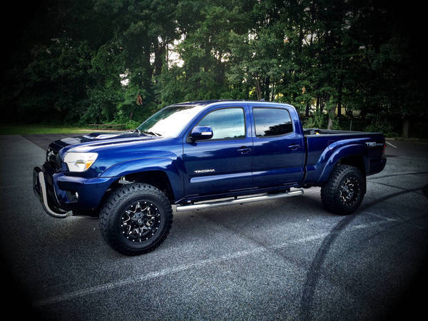

    2014 Blue Ribbon TRD Sport DCLB
    Fuel Lethal 17x9s, Mickey Thompson Baja ATZ P3s, Icon stage 4 lift with billet UCAs, Westin Bull Bar, Westin Nerf Bars, OEM Bed Extender, WeatherTech Digital Fit Liners, OEM Skid Plate, WeatherTech In-channel Wind Deflectors, Fold-A-Cover G4 Elite Tonneau, Pop&Lock Electric Tailgate Lock.
    I just went through all of this. I originally wanted a 6 inch lift and all I read about was problems. Sure, there's always someone who says they're fine and frankly people don't usually complain if there's no problem. There's a good chance if you get a good lift, you won't have problems.
    In my case, I decided to take the money I would have spent on a 6" lift and went with a 3" of much better quality. I ended up with an ICON stage 4. And I put it on a brand new 2014 with less than 500 miles on it. I could not be happier. I have 33" Mickey Thompson ATZ P3s on it too so they give a bit of an extra lift just because of their size.
    The ride is definitely a little different than stock, but it feels like an off road truck. I don't personally mind that at all.
