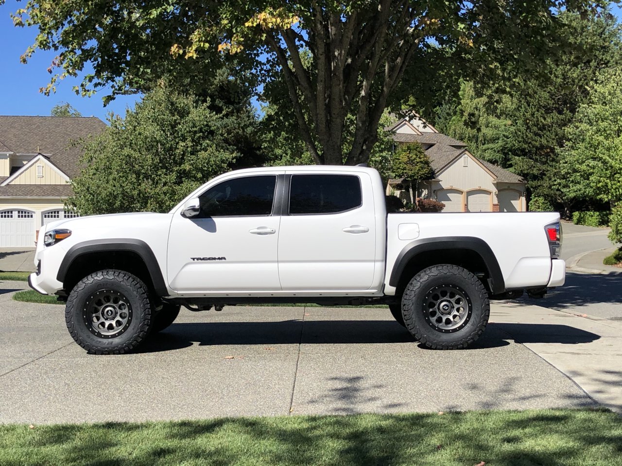

    PNWTacoAdventures
    PNWTacoAdventures Well-Known Member
    Jul 28, 2020
    #335857
    262
    Washington
    2020 Super White Tacoma TRD OffRoad
