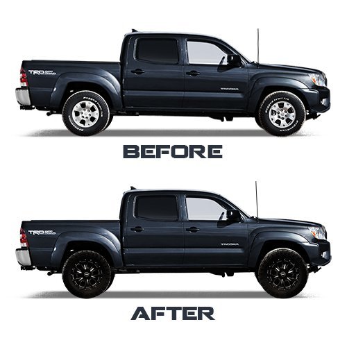

    From the factory, most trucks, to include Tacomas, sit a little lower in front than they do in the rear. The rear sits higher to counteract the weight of a load in the bed. A leveling kit just brings the front up to match the rear. Here's the best pic I could find to illustrate the difference.

    Oh ok.. i xan barely notice the difference on mine.. do you know how much inces is the difference?
    I like how the "after" look already have the wheels replaced too.. haha
