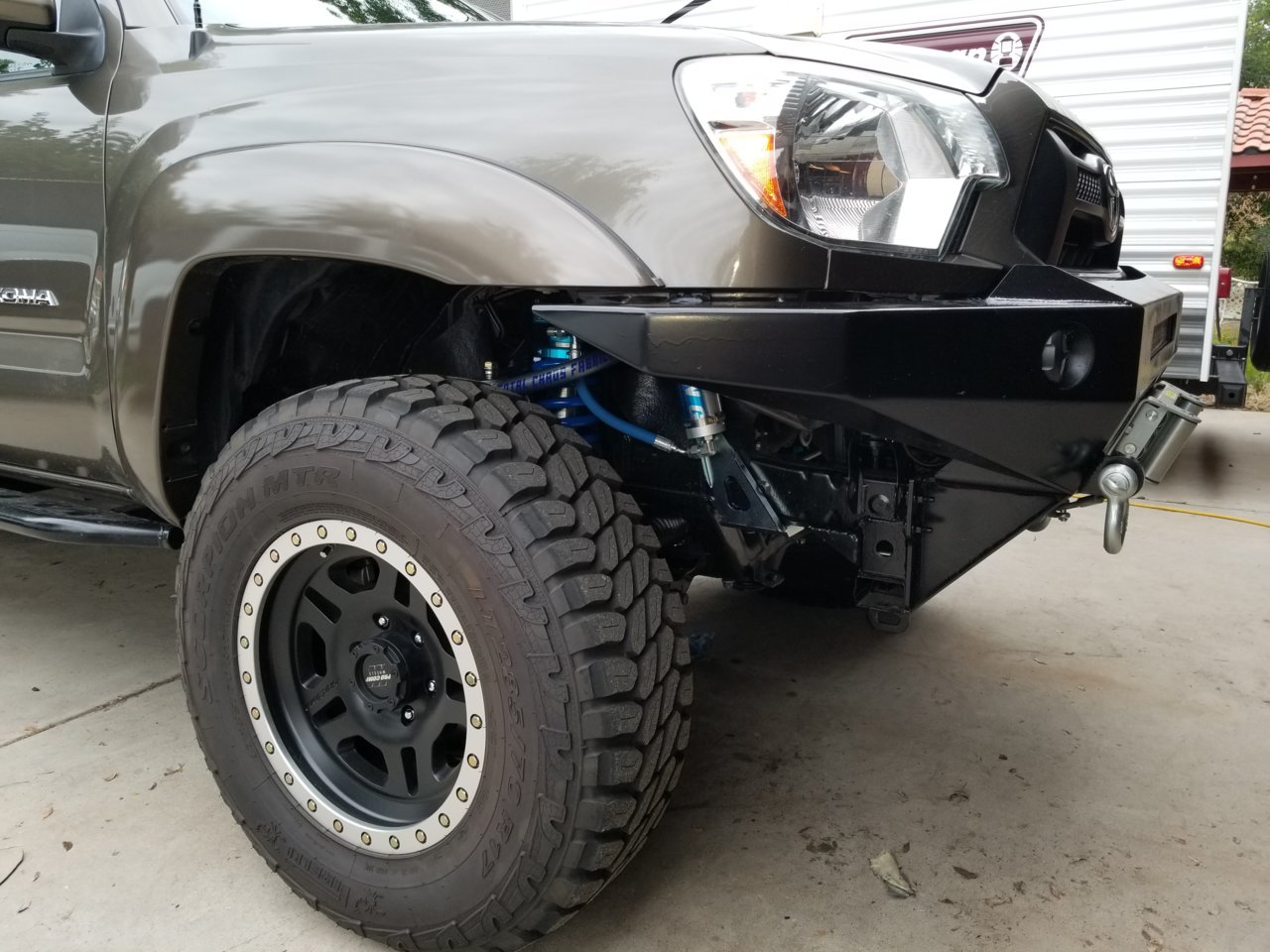

    Go with 285x70x17, a lot less headaches.
    I am running this on 17x8.5 rims and I am under 3" lift. You will be alot happier with the ease of reaching your goal. If you want 35s, 37s, or 40s? Check out Marlin Crawler and go big. Good luck with your truck.
