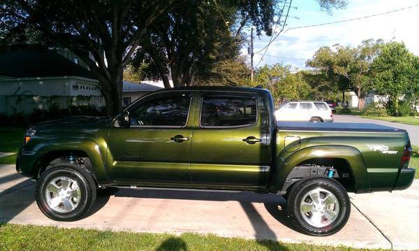

    I installed my leveling kit today........was really easy took me an hour and a half.
    2.5: in the front and 1.5" in the rear.....front spacer/rear blocks.
    This is only untill I get 5100's money issues.

    Nice job. Truck looks nice. What product did you use?

    I got it off e-bay for $125...billet alum spacer and cast iron blocks...Hopefully tires will be on by Sat

    Im planning on also installing a lift kit .would 3 inches in the front and 1.5 in the back be ok or would it leave a bro lean?

    I didnt go w/ the 3" in front cuz i was worried about the wheel alignment not being abe to get bk to spec w/out replacing uca's
    what I really should have done was go w/ a 1"block in the back i still have a rake(higher in the rear) and I wanted it more level but I am happy w/ it.

    How did you do it? Did you have to R&R the coil assembly?

    How much did it stiffen the ride?

    Yea the whole strut and coil comes out ..bolt on spacer then put strut back in ......easy!!
    It didnt stiffen the ride at all....I didnt alter front nor reat springs...rides just fine.

    You didnt need longer studs?:confused:

    The spacer bolts to the bucket, and the coilover bolts to the spacer. No longer studs.

    Looks good, I got my kit off eBay too but I went with the 3" with 2" blocks for the same price. No alignment issues & rides the same as stock.

    Ahhhhh that makes sence now. I think i may look into just the front leveling kit.
