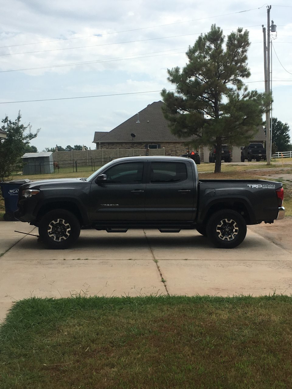

    18334455-3196-4490-8A58-35514256523E.jpg18334455-3196-4490-8A58-35514256523E.jpg My 2019 tacoma TRD off-road is
    1 1/2 lower in the front 20 1/2 front 22 rear all the way around . This is my truck picked up 1 1/5 in the front to level it but I think I’m going 2 1/2 front and 1” rear
