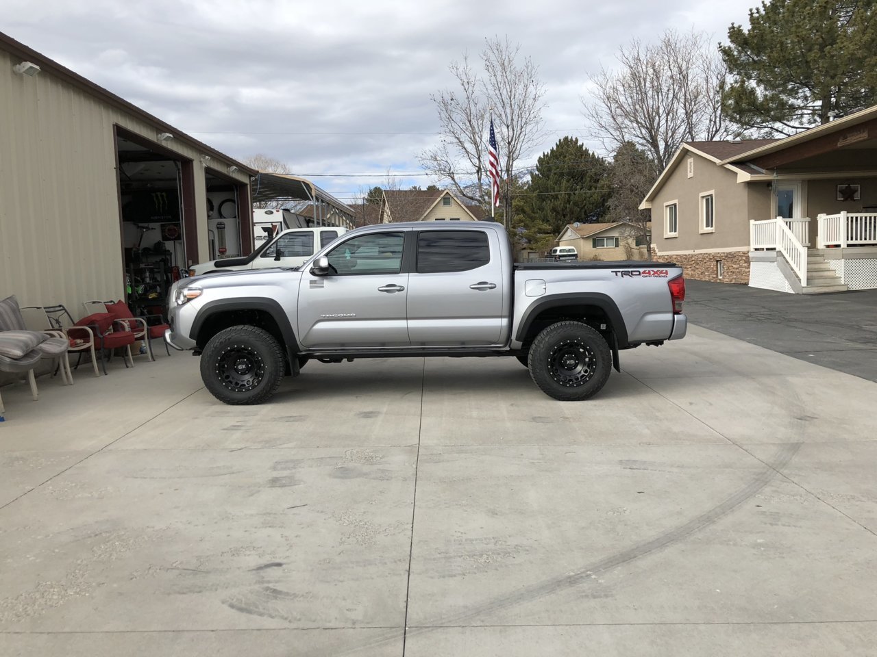

    Just trying to help ya out, but I did a 1” all around. You can kinda picture how 1” more up front wouldn’t make it look.

    Thanks alot for the pics and info. In your opinion, would the extra inch up front make it closer to level or would you guess that may push it just a hair past level?

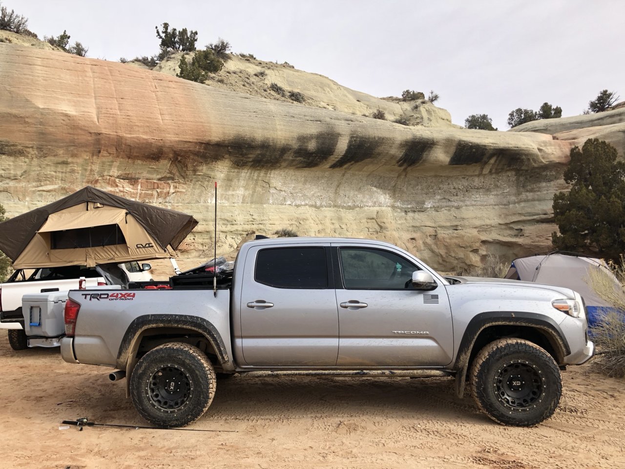

    2/1 should make it pretty damn level.
    I have roughly 1.5" up front 1" in back and the back is slightly higher (which is what I wanted).

    It would level it out because factory rake is 1” higher in the rear than front so lifting the back 1” would require 2” in the front to achieve the level look.

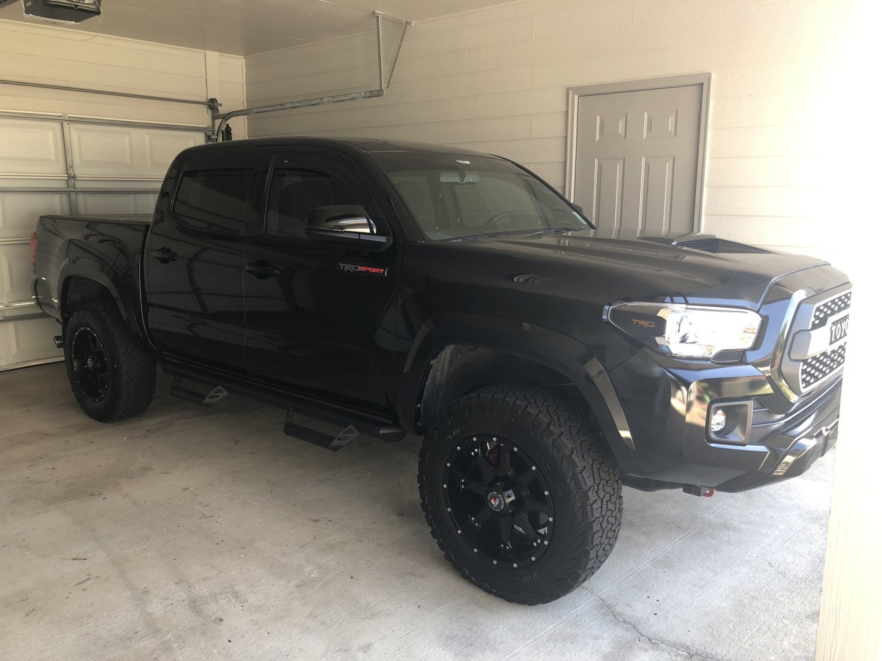

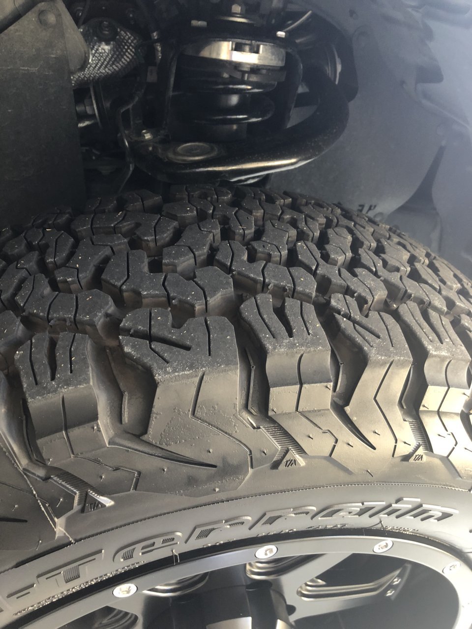

    1" coil/strut spacer up front giving it 2" of lift and 1" block in the rear with the biggest tires i could stuff under it (285/75r17)
    cost lil over 100$

    I’m running 275/70/17.

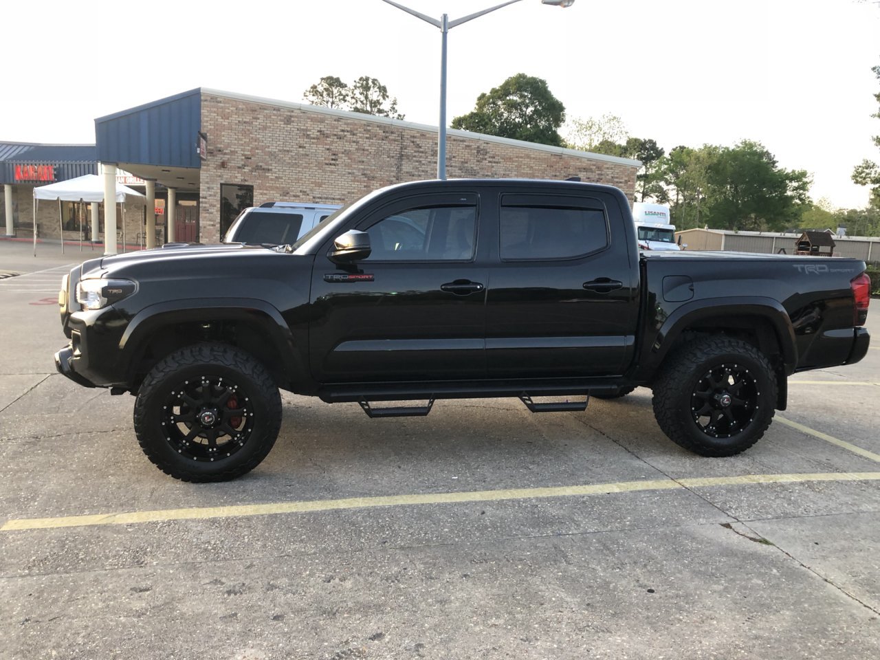

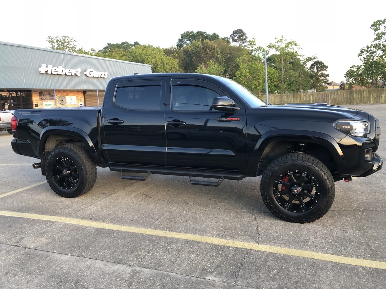

    2/1” lift.
    275/65/18 BFG KO2 tires
  17. Apr 12, 2018 at 6:17 AM
    #17
    Mark_H
    Mark_H [OP] Well-Known Member
    Apr 6, 2018

    Perfect stance...what did you use to attain the 2/1?
    Thanks!

    Spacer in front, block in back. Did it myself, then got alignment at local tire shop. Rides the same.
