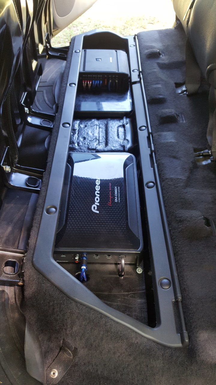

    Does the amp ever get hot in there?

    Never has. I pulled the top covers off of the storage bin and it let's plenty of air get to it.

    Sorry for all the questions but I plan on mounting my amp in there now!
    Can you tell me a bit about what the amp is mounted on and the support underneath? Where did you bring in your power and inputs?

    What is that your amps are mounted on ? Plastic of some kind?

    I initially had it mounted on some 1/2 inch birch plywood. I found some 3/4 black plastic that I swapped in it's place. It took a lot of time to get it cut to fit correctly. I wanted to make one solid piece for both amps, but I couldn't because of the height of the Pioneer amp. The power wire is ran through the firewall and under the carpet to the storage bin. There is enough room to run it under the plastic trim along the edge of the carpet. I drilled a hole for the ground wire to the middle seat belt anchor bolts.

    1/8” ABS. In hindsight 1/4” would’ve been better (stiffer) but 1/8” works. Little bit of a learning curve to cut and bend it, but I’ve always used MDF and wanted to try something new.

    About to put mine in the same spot tomorrow. Where exactly is the ground?

    Where do you get ABS? Anywhere local or do you order it?

    Excellent wiring and terminations.

    Amazon. I already had a couple things in the cart and tossed a sheet of ABS in.
    Fair warning, if you cut it with a jigsaw like I did, keep your speed up or the friction from the blade will melt the damned cut shut right behind your blade. Little bit of a learning curve, and a lot of cleaning things up with a sanding drum on a dremel.

    If you lift the carpet it's just in front of the hump where my wires enter in that pic.
