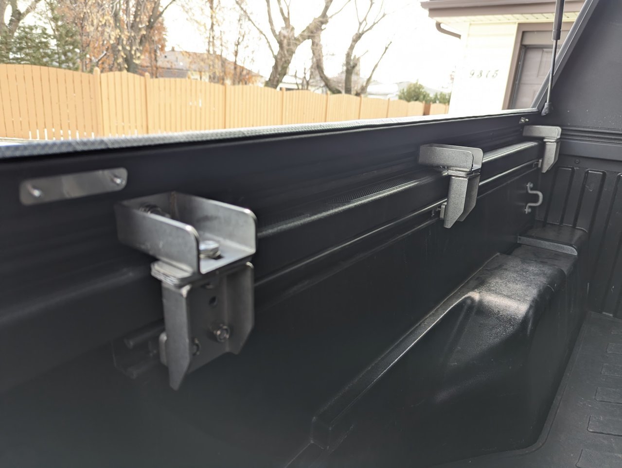

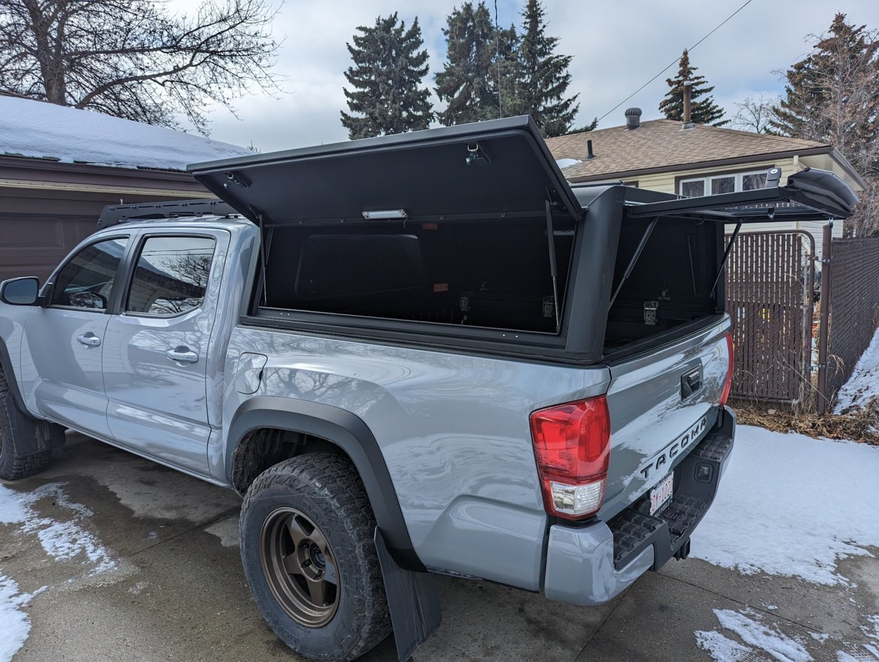

    Anyone able to confirm the gas strut lengths for the gen 3 explorer rear panel?
    Installed my explorer last weekend and the rear hatch only opens about 90* from its closed position and @ 6' tall its just itching to split my forehead wide open when I'm not paying attention. I was under the impression from the images I had seen that the rear hatched would open somewhere closer to the 120* mark.
    Also, is it common for the brackets that you use to secure the cap to the bed with to arrive bare plain steel and not powder coated? the distributer that I purchased the cap from said she had seen this before and that it is normal. Kinda fucked that a $4700 CAD doesn't come with the only part on it that is going to rust not powder coated....
    Additionally, seems like some of the bracketry has changed around. (mine was fresh off the boat, mid march 23). The brackets that attach to the slotted trail rail (whatever you want to call the rail that has the factory adjustable tie down points). Old instructions indicate that its a backing sandwich plate type setup that has the back plate threaded to accept an M8 bolt. The brackets that now come with the explorer have a rear sandwich plate that is NOT threaded now. Instead it has square holes that a 5/16" carriage bolt drops into ( square hole secure the carriage bolt from rotating) and male threads of the bolt now face inwards to the center of the box and act as a stud to bolt the bracket too. I will add some pictures when I remove them to paint them.
    1Zbm7Swg0d-UU1J2BdLYE9xNA5jmJwOIXlwDa4J5_1b27bdcc157bc9a6441ea5f8cbeefdd4127315ca.jpg
    PnUQI8_yS-m1xhZmfk4Svz0d8mLcaPobD40SLxsp_79d4e4d6d2a58f5374c05704b061affc2720dee8.jpg

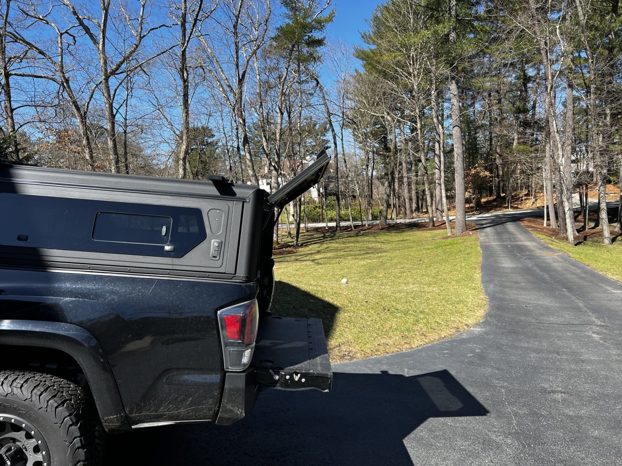

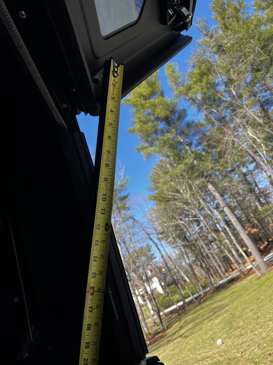

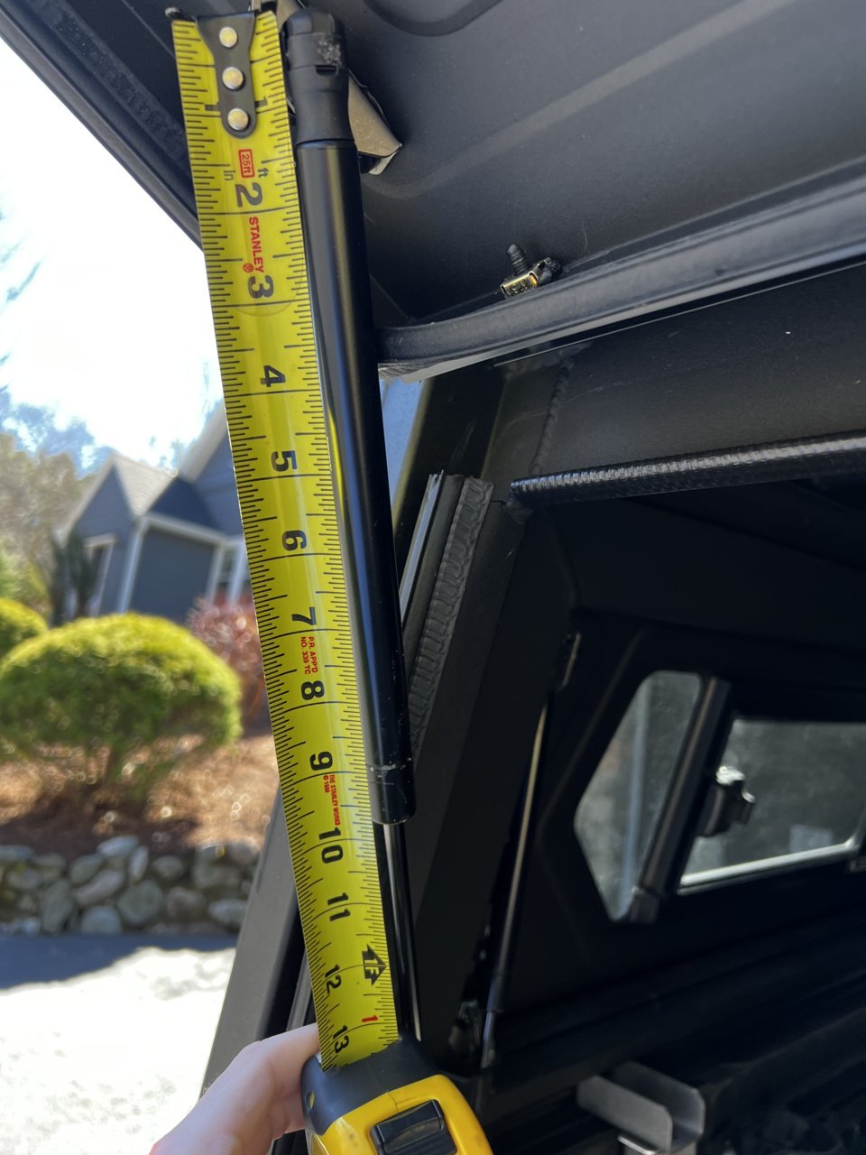

    hard to see but mine are 18” when open. The canister part - whatever you call it - is 10”
    mine def opens to 120*
    hope that helps

    That attachment set up looks like what is in my Contour that I also received in March. The I believe mine are M8 where the Mount attaches to the canopy. Also, my rear door goes up almost 120 regress. @FooManChu Would you like me to get you pictures of the numbers on the struts?

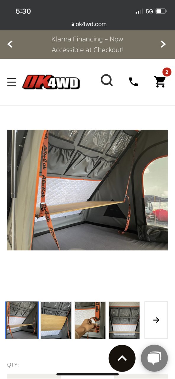

    Oh y’all are talking about the actual table I meant the one that goes in the tent like this. It seems simple enough but I was just curious about mounting and securement for a DIY.
