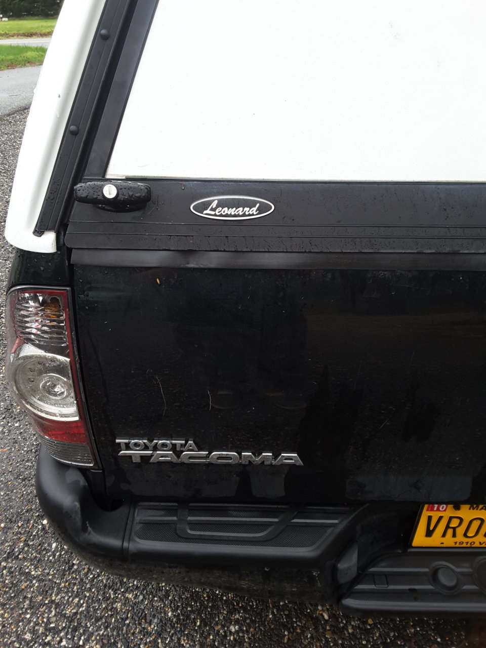

    Is there anyone out there that has a Leonard camper shell that would be willing to post pics of the clamps? I’ve found a shell here local, but it doesn’t come with clamps. I have some clamps for a T-Bar set-up that might work but wanted to see.
    I guess I can always throw a ratchet strap over the top to get it home.

    As far as I know the clamps for all the caps are pretty much the same. It's more a factor of what works with the trucks track system. Also, as far as I know which might be wrong, Leonard is a company that modifies and sells caps made by other companies. My Leonard cap was actually made by Leer.
    This is the style of clamp, that has two options to use in the track system. The style that is threaded into the bolt is the kind I am using for my truck:
    You can find these on eBay or Amazon by looking up tacoma cap clamps, or possibly at your local cap dealers.
    On my cap the bolt is threaded down through a hole in the fiberglass skirt of the cap and into that piece that rides in the track:
    Best of luck!
