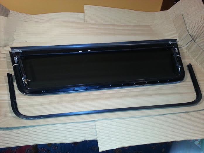

    Got my replacement door from Leer. It was around $330 CAD. It is the door, frame, gas struts, handles, everything. Now I just have to figure out how to change it out. Looks like I have to take everything out, right down to the fiberglass. :eek:

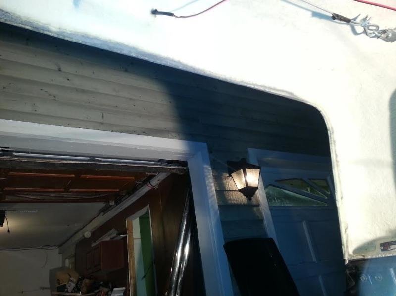

    So I got it done. Not a super big job, but plenty awkward.
    I didn't find anything on the internet that showed how to replace one of these doors so I just started taking my old one apart. Turns out it's not that complicated, but there are a lot of screws involved. There were loads of these self tapping screws holding the inside bracket to the door frame - all of these screws provide the clamping force that holds the door into the fiberglass opening.
    Here I've taken some of the screws out.

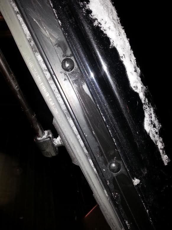

    After I removed all of the screws from the inside bracket, the door was still not moving. So I checked out these rivets. There are two rivets on each side, they are driven in from the outside, through the door frame, through holes in the fiberglass and into the inside bracket.
    I ground the heads off and they popped right out.
    Then the door more or less just dropped right out.
    So here we are right down to the fiberglass.
    The next part was the most difficult. I had to hold up the new door where it is supposed to live and position the inside bracket where it is supposed to live, and drive a whole bunch of self tapping screws into the door frame to clamp everything together. The new door didn't come with new screws so I reused the old ones. I used a 1/4" ratchet to drive the first couple and that was a huge pain, so I smartened up and got out the air ratchet for the rest - that made things go a lot easier.
    Here it is, all done. Well I still have to drill the frame somewhere close to where the previous door frame had those two rivets on each lower side. I am going to use stainless screws and self locking nuts instead of the rivets though.
