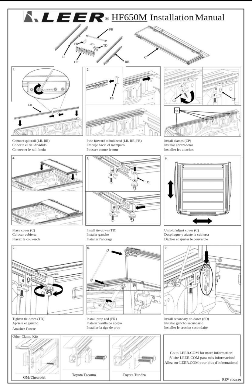

    Here is the most current instalation instructions.

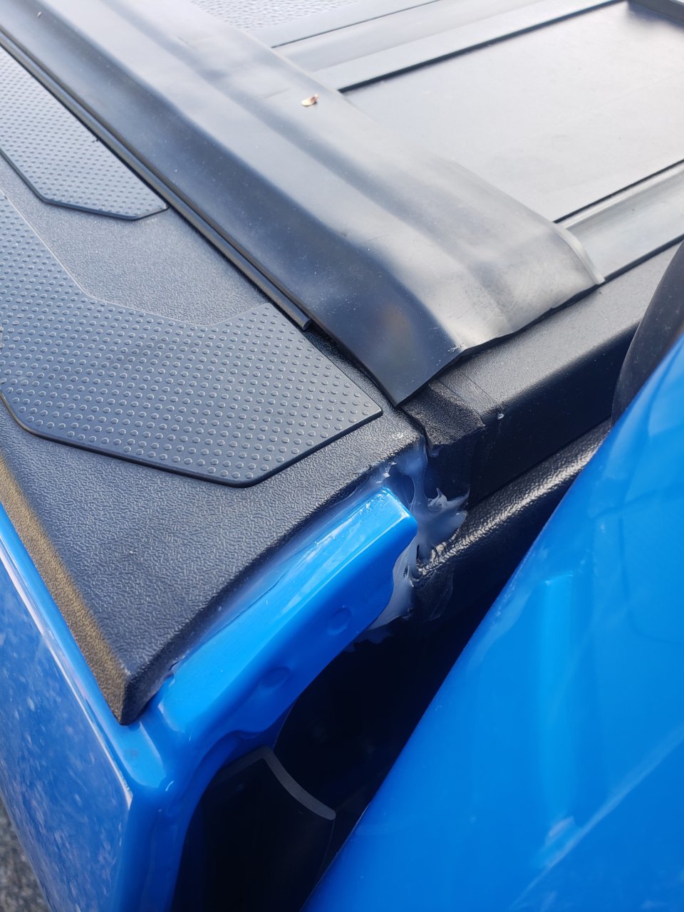

    I took some photos of the HF650 installed for your reference (for those installing themselves). Let me know if you want any other angles.
    Edit - the 2nd & 3rd photos show the foam spacer and silicone caulking to help seal up the gaps between the sidewalls and the front wall of the bed.
