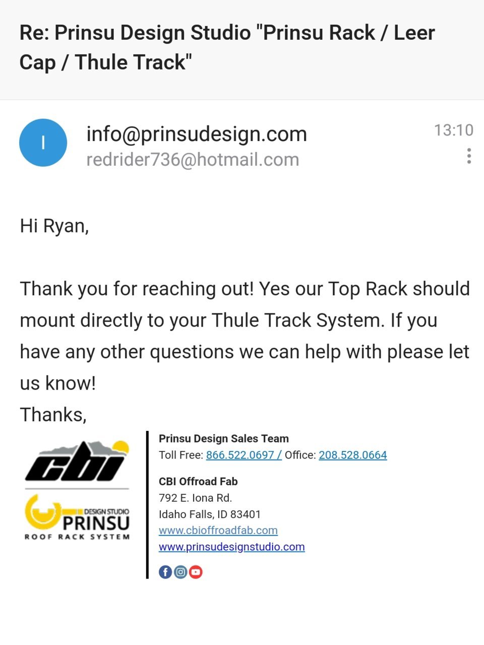

    Is that the Thule Track with a Prinsu Rack ?
    I don't know anything about the Prinsu, but dose it fit directly onto the Thule Track with out any modifications??

    Direct from Prinsu

    I don't have a Leer but a SnugTop with the Thule system and it works great! The rail system you have will work with most things. Thule, Yakima, Prinsu, Frontrunner, etc...

    @redrider736 hey bud. You definitely can, look at my build page. I have a leer 100rcc with a front runner rack.
    You will need to buy a different square nut that fits into the track or grind down the square nuts that come with the mounts for the frontrunner rack.
