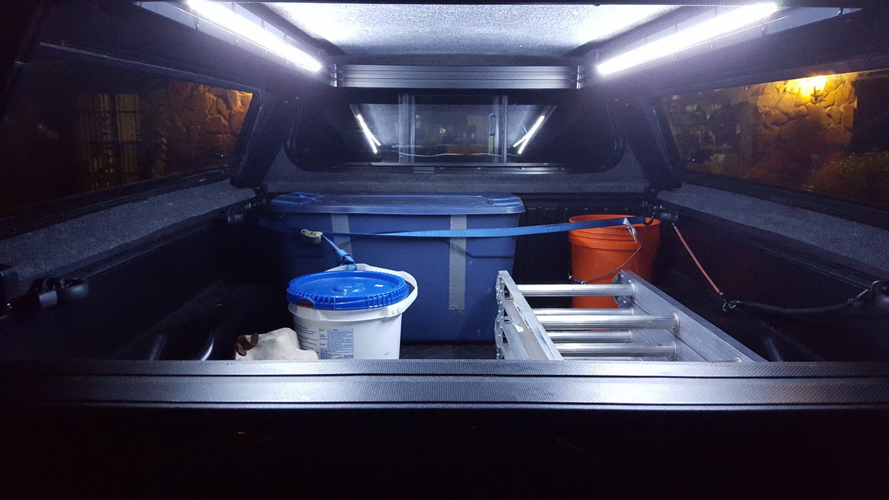

    What are people doing for lighting inside of the camper shell? I was trying to find options for LED lights when the back glass is open to light up the tailgate and part of the bed of the truck.

    My bed light kits include easy to follow install instructions with lots of pictures. If if the underside of your shell is carpeted, you would need to add Velcro to the back of my light strips. If its fiberglass, you would need to use silicone.

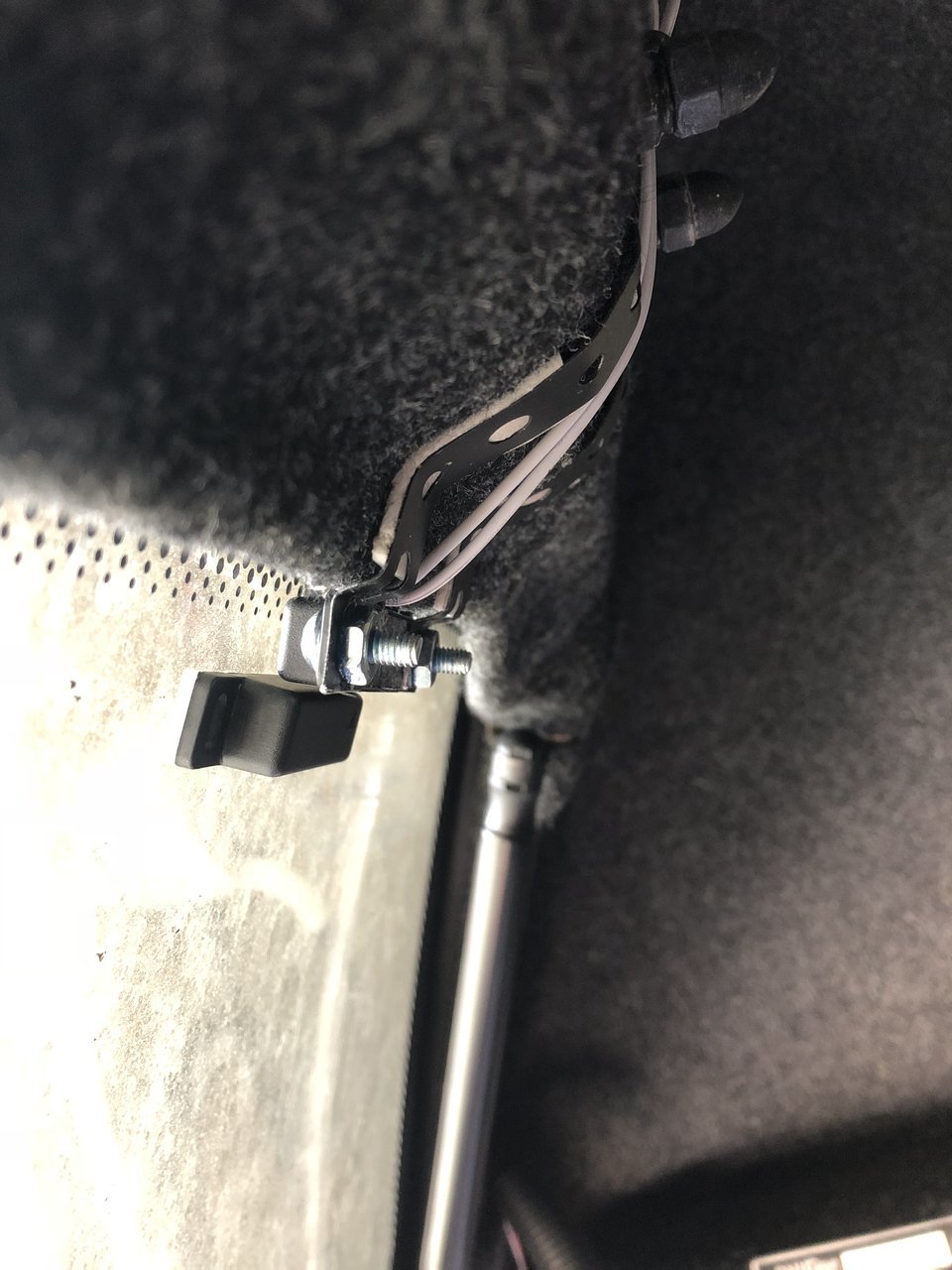

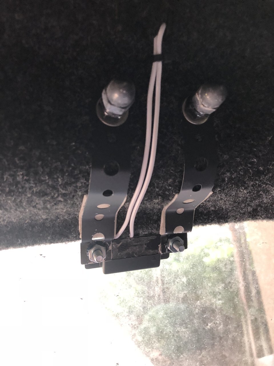

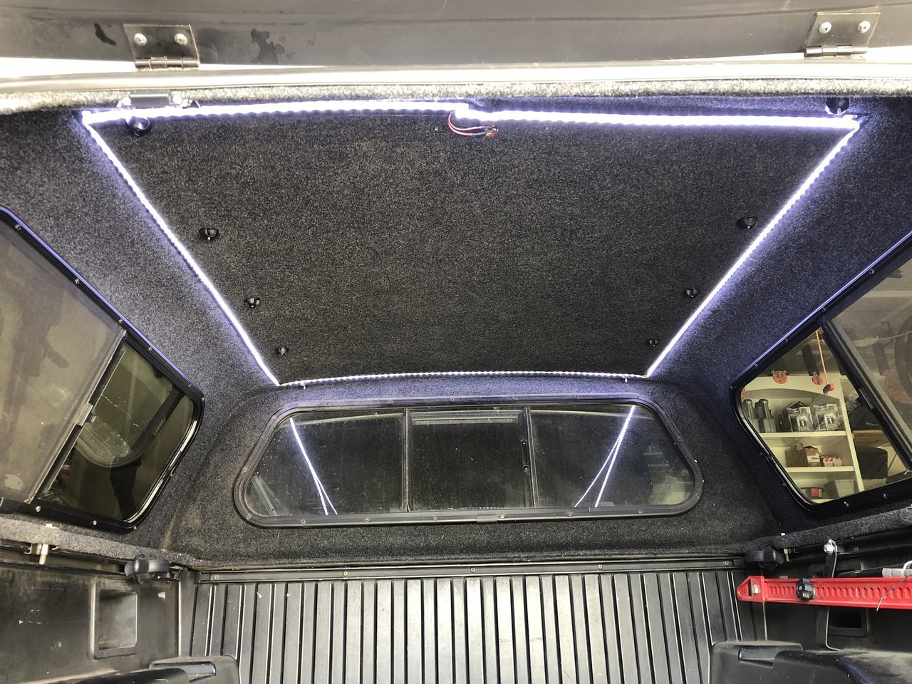

    Trying to install a LED light strip to the ceiling of my shell this weekend. I'm attempting to wire it to a magnetic switch so that the lights turn on when the shell window is opened. having trouble finding a location for the switch. @mattgecko or anyone else have any experience with this? here's the switch

    Installed my new LED strip lights today & i'm really pleased with the result. Purchased both the magnetic switch and LED's from Amazon. Used some duct strap to attach one side of the switch to the shell & the other to the glass with double sided tape. LED's turn on when glass is open, off when closed- simple & inexpensive.
