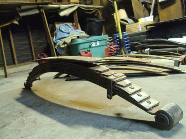

    So I bought a stock leaf pack with a 2" AAL from a local TW member and have decided to clean them up and use them for a little lift. Here is a picture of them when I got them, sorry if it's small, I can only view certain pictures with my work computer.
    The plan is to hit them with the wire wheel, sanding wheel, spray them with rustoleum primer, and paint them with Krylon flat black. After that, I will throw them on the back with some rear 5100's, planning to get a small group of TW members together near Houston to help, me providing lunch or something along those lines.

    After Completion Edit:
    So refurbishing leaf springs is really pretty easy, all you have to do is...
    1. Find some leaf springs
    2. Grind off the rust
    3. Hit the leafs with a sanding wheel (optional)
    4. For spots you can't reach, use rust converter applied with a paint brush to turn the rust in that area into a black primer. (This is only necessary if you do not want to take the leafs apart)
    5. Paint the leafs with a primer/paint combination meant for metal. I recommend Rustoleum or Krylon.
    And that's it! Much more detail and helpful info can be found in 4X4's thread, Tacoma Spring Refurbishing.
