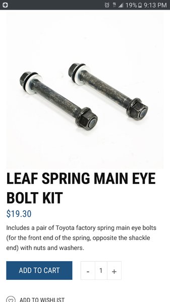

    Does this help? 4x1x1

    A little. I'm doing some digging online to see if anyone has ever posted the size. I guess I could always just take the new bushing to the store with me and figure it out that way. Is the bolt supposed to fit pretty snug in the bushing?

    It says 4x1x1.

    I think that's the rough dimensions of the packaging. The bolt is about 4" long from what I've read. I found an old thread that says they're an M14 x 1.5 pitch x 100mm. I just need to find bolts that have a long enough shoulder. If the hardware store doesn't have them I guess I'll order those ones from Wheelers.
