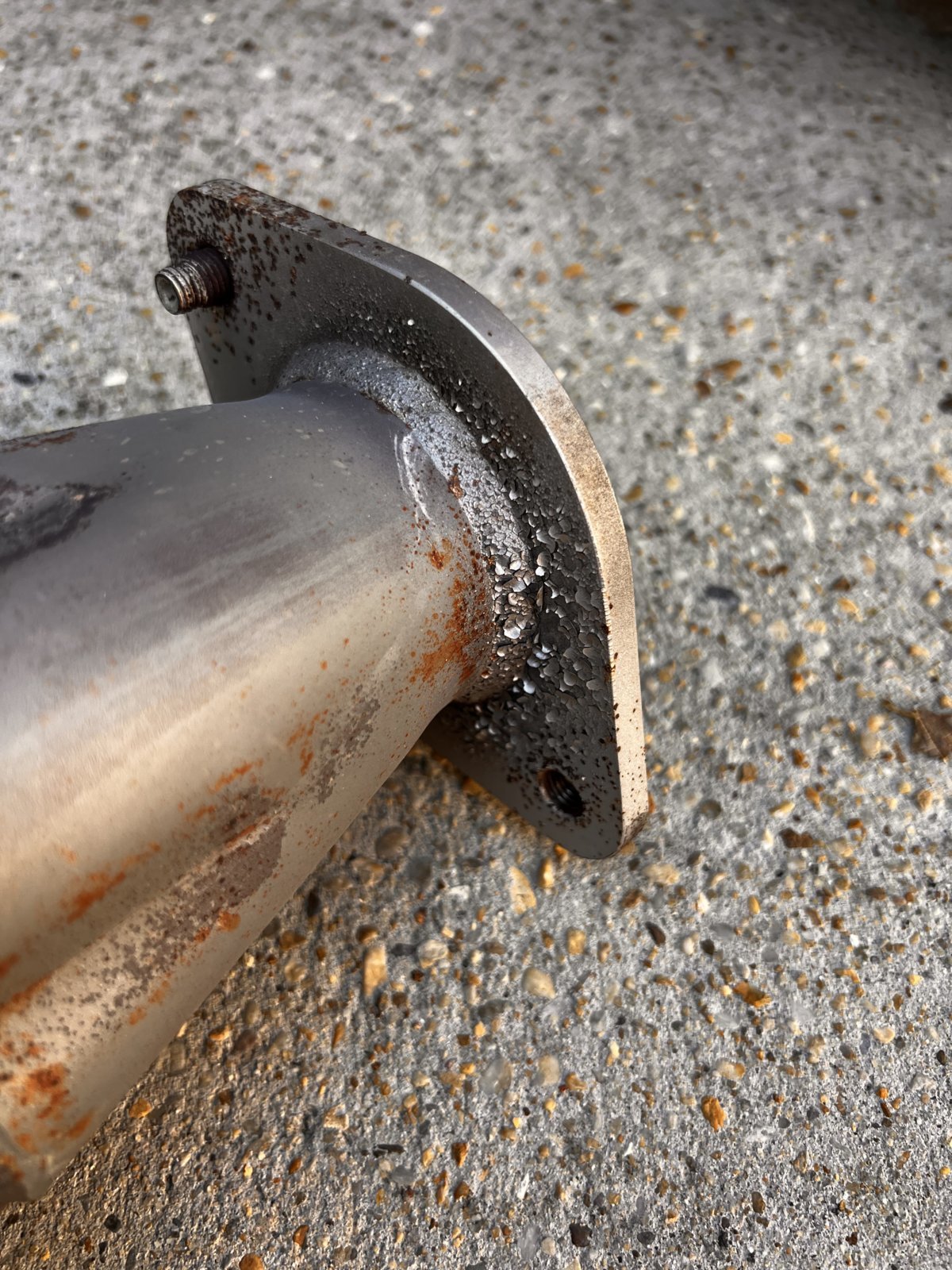

    The paint started bubbling within a month. It’s been a little over a year since I put it on and this is what it looks like. I am also not very pleased with their long exhaust studs either. For how much they cost it should have been of better quality. The OEM studs and nuts were corrosion free, and when I test fit the manifold they would have worked but I said fuck it and installed their kit since 1. I had paid for it 2. I had it 3. LCE recommended it. The stud kit is very basic untreated hardware.
    The long studs I can look past, but the headers hurt me for some reason and I can’t get past how the ceramic coating quite literally eroded away so quickly. It’s coming off soon and I’ll be painting it.

    Hmm. What part of the country are you in. I'm hoping it's just salty roads?

    I live in Maryland. We do see salt but it’s not as bad as more northern states. I also wash my undercarriage pretty regularly. My frame looks much better than this lol

    Took the header off. This shows clearly how the paint came off from the get go. It all flaked off. Seems like improper preparation or application. Based off other comments on how well it has held up I’m wondering if there is quality control issues. Seems like they either last forever or don’t last at all. We can also spend a minute laughing at the pro weld.
    Also bonus pic comparing the OEM stud(center), LCE stud(right) and the ARP LS1 studs that will be going in(left).

    Try Jetcoat?

    i gave this a serious thought but I ultimately decided to just do a paint and bake. I used VHT header primer/paint/top coat. Time will tell if it holds up. I really stank up the house baking this. For now it looks decent. I dig the ARP bolts.

    Same thing happened to mine. It's the paint, lce sent me a replacement, same thing, paint bubbles within days. LCE gave me choice, full refund or $250 discount.Tooters pic of how new they looked 10 years later, sold me, wish I had his results on the finish.
    I'd 100% stay away from their header stud bolts, throwing away time and $.
    Mine look absolutely horrible, totally rusted, look over a hundred years old.
    OEM ones studs I took off, gotta go back on, they are in way better shape then LCE stud nuts.
