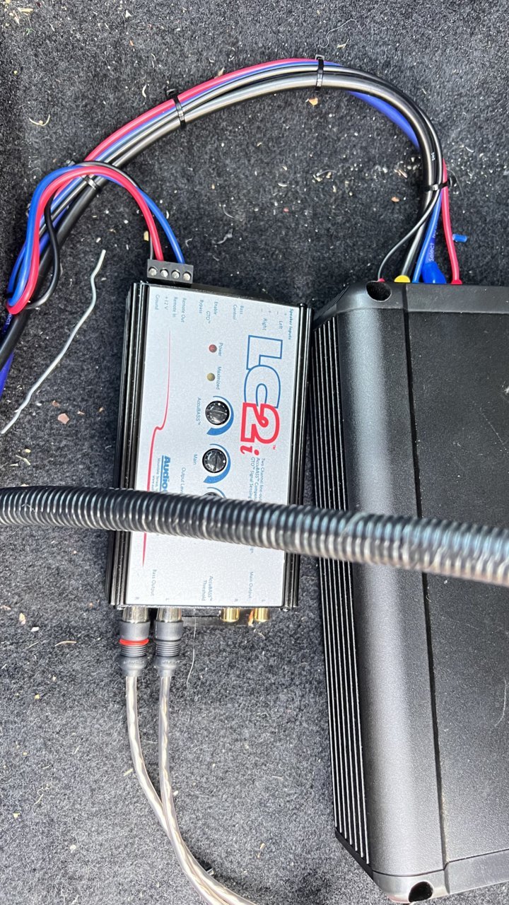

    So I finally made my mind to install an JL Audio 8 inch compact enclosure on a non JBL radio so I tapped on to the 2 front speaker wires to get signal to the LC2 Audio Control unit
    This was a pretty basic install and ended placing both the Memphis amp and the LC2 under the drivers seat.check out the pictures and let me know if you have any questions.AA183852-7DBD-413E-BAEA-5DC3309A6141.jpg78EE9154-C5BF-4976-989E-265DB357C519.jpgACCF6F32-4DAB-4D38-8537-12374ED9B124.jpgFF8A8FBC-9C39-47D0-A3E1-EDD4B2FA657E.jpg

    Well I have an update my whole set up consisted of 6x9 JBL 3 ways and the JL Audio 8 inch subwoofer
    And it was loud enough however once I was raising the volume the 6x9 were suffering from not enough watts and the clarity was suffering
    Solution: I asked for for help at Paradyme here in Sacramento and the rep offered me a JL Audio JD 400/4 amp since I have the LC2 Audio Control, this tiny unit has a sub and a main amp output which made the addition/install of the 4 Channel JD 400/4 a breeze!!
    Result: a complete new world !! The 6x9 JBLs and the 8 inch JL both have more than enough power I’m barely using 1/10th of turn of the gain controls and the sound is extraordinary +I will add pictures this weekend for you all to see it again this for my 21 access cab Tacoma Non JBL system and please believe me when I say I don’t need anything else I have plenty of punch and clarity and I was able to adjust the amp to maximum volume from the stereo with no distortion so I would highly recommend this set up to anyone trying to upgrade your non JBL system.
