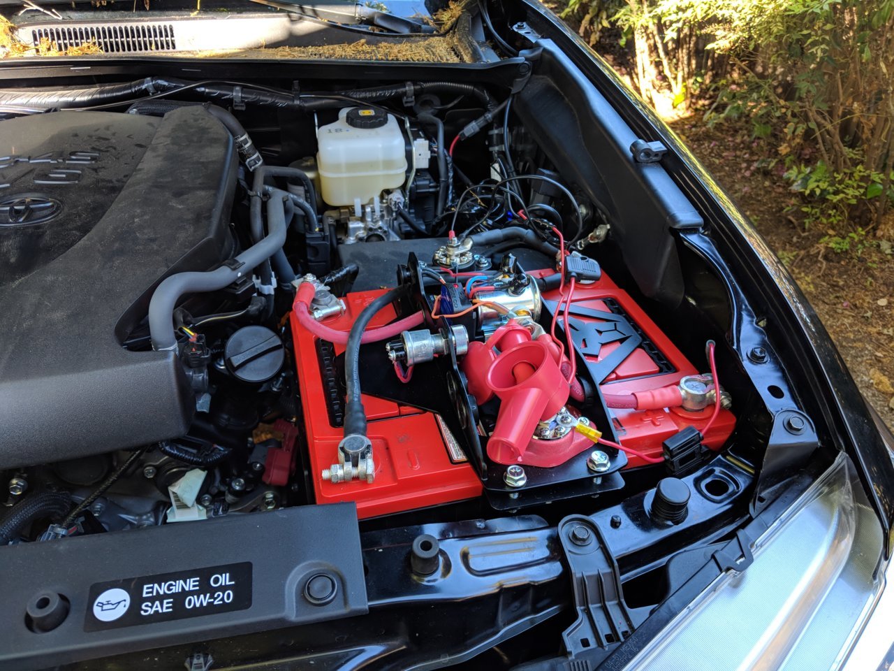

    Interesting. My friend has a 3rd gen Offroad and he's got a 34 in it. He's using a tray from Off-Grid Engineering. Look it:

    Weird. OEM did it for me too. I ended up getting the X2 group 31. Haven't replaced tray yet so it sits on top of OEM tray for now. I did need to replace the tie down rods though. Love it!!
