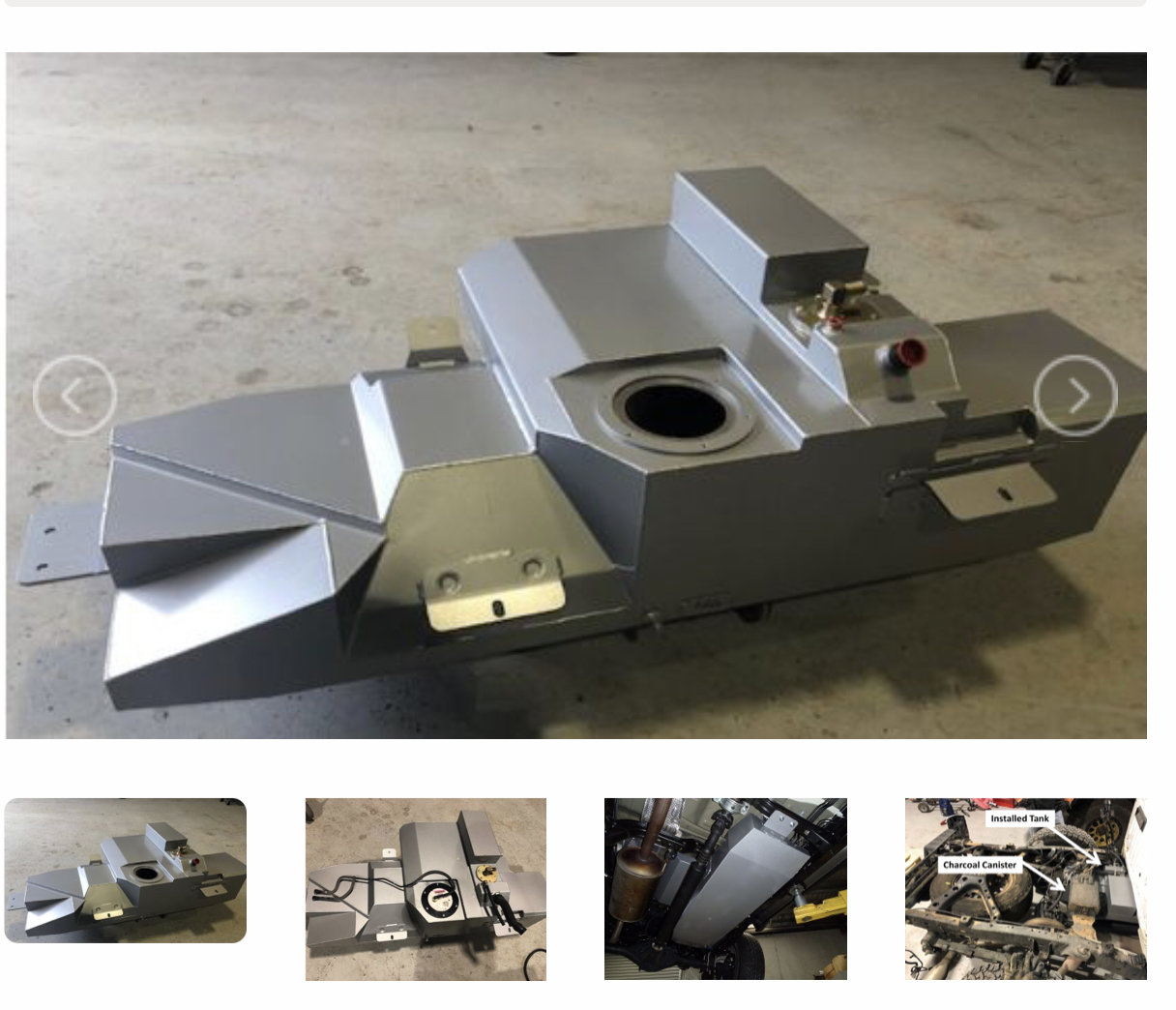

    OK so I tried looking through the search option but couldn’t find much on extended/larger gas tanks I was considering putting the larger tank on for long trips. And not having to carry gas cans on the roof and everything I’m trying to keep the truck simplistic on the outside. Does anybody have aLong range fuel tank., The other thing is I’m in California and I’m wondering if the stupid state is going to come down on me for having changed my gas tank. It’s also very strong or so I have heard. Any input or pros/cons would be helpful! Looking at something like this.
    https://longrangeamerica.com/prod/ttacdcr/5650264C-E58E-49F2-8A19-4A84E01FAF1E.jpg F661DB5D-A93C-4BB5-ADB2-EBB742742969.jpg

    the state should not be overwhelmingly concerned about a diff tank
    they will get their underwear in a knot
    if its not plumbed & ‘ vented ‘ properly on the feed & return side
    id check b4 i spend the $$$

    CA law = You can not alter your fuel tank.
    Now... the question is, will the smog tech even look? But the law says you can not alter it. You can replace with equivalent, but you can not alter it by changing sizes, location, etc, etc.

    You can do an auxiliary tank that feeds the original tank. Lots of agriculture guys and heavy equipment guys, that have the fuel transfer in their bed, have it set up on a float to feed their original tank.

    While I like the idea of the larger tank, it probably makes the taco-lean worse and is a fairly expensive mod.
    Now if it ADDED 33 gallons and sat on the passenger side I wouldn't be able to get my plastic out fast enough.

    My F150 has a 36 gallon tank and I like having it. But the only time it is helpful is when towing and getting 10 mpg. The extended range is minimally helpful otherwise. I've driven it close to 600 miles on a tank before, but normally stop enough for other things that the range isn't needed. It is sorta nice to keep driving through places with higher prices and fill up in areas with better prices. But even that isn't common.
    My Tacoma will easily go 300-350 miles on a tank of fuel. That is enough range for me. I've driven it on multiple cross country road trips and never felt the factory tank was a disadvantage. I just don't see the benefits of a larger tank being worth the costs and other negatives on a Tacoma. If it came from the factory with something around 25-26 gallons that would be nice for the guys who tow. But I can't justify the expense of an aftermarket tank. In addition to the cost you have the weight of a larger tank plus the added weight of the fuel. On a truck with very little payload to begin with.
