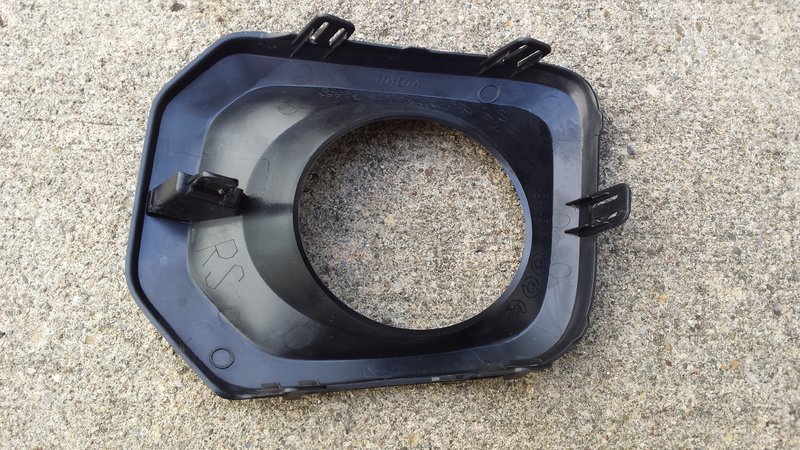

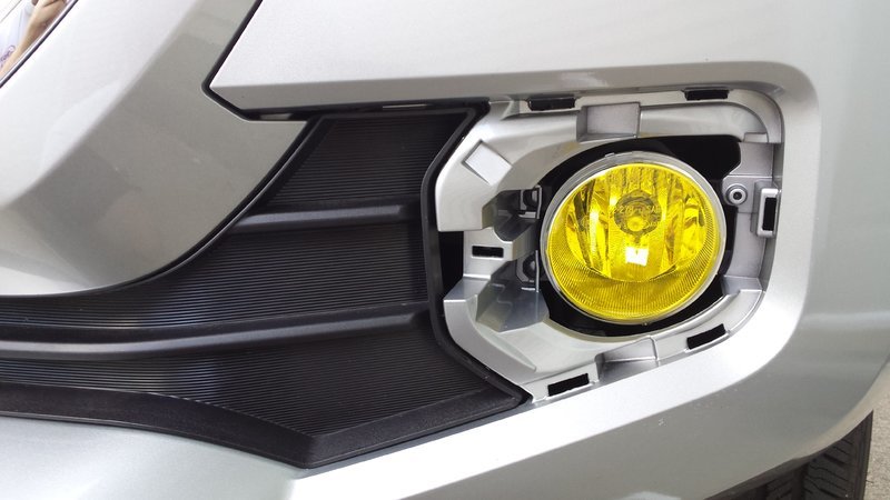

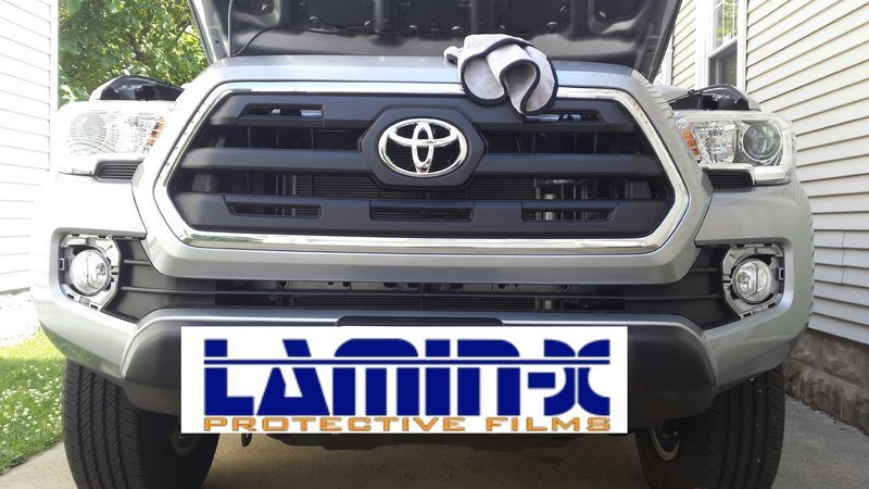

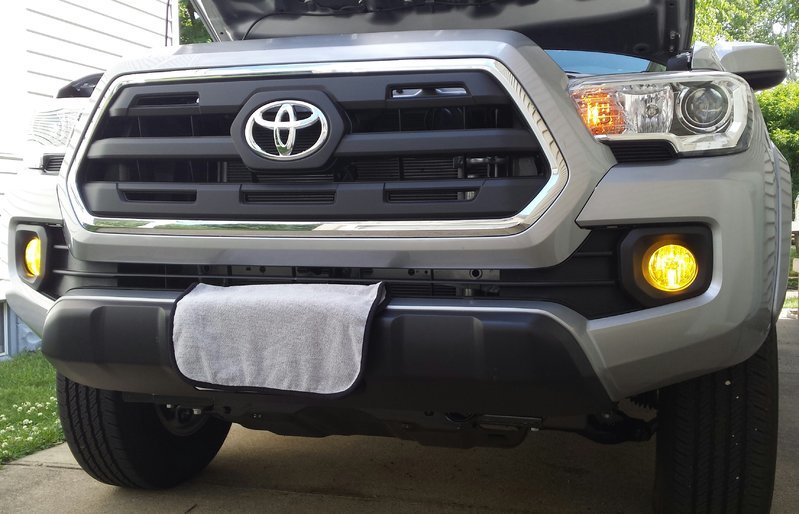

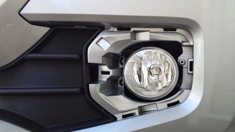

    Today i decided to install yellow LAMIN-X on my fog lamps. The complete job took me 35-minutes and could actually be done faster but i like to take my time
    1. Remove fog lamp bezels, there are 6 plastic tabs to release and they are easy to get to by reaching down from top (use a flashlight so you can see tabs)
    2. Clean fog lenses good, i used a micro fiber towel and isopropyl alcohol
    3. Peel backing off the LAMIN-X film and hold by tabs .. i sprayed a light mist of water/Dawn dish soap on the sticky side
    4. Center the LAMIN-X on fog light lens and work from middle out with your fingers to smooth the film
    5. Use razor blade to cut the 2 tabs off the LAMIN-X
    6. Re-install your fog lamp bezels by just pushing in till you here the tabs click
    ... and you're all done, this was an easy mod and i like the looks of the yellow lenses, iplan on adding yellow fog lamp bulbs here soon ... any suggestions? Mine take the H16

    Update : added Nokya hyper yellow bulbs to my fogs and also didn't like the amber DRL with the yellow fogs so i replaced DRL bulbs with Halo Solaris yellow halogen bulbs (Y-402)

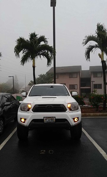

    This is what happened to my Lamin-X film after a couple months of use. Driver side fog has a burn mark. Snapchat-2279026732672188413.jpg :rolleyes:

    Wow that's crazy! are you running the original fog light bulbs or something different?

    Stock bulbs. Weird that it only happened on one side. The actual lenses are fine. Just the film got burned. Never buying Lamin-X again lol
