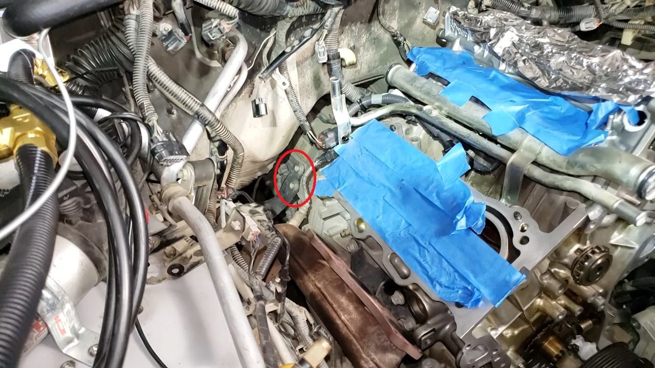

    Good luck doing this without pulling the heads. And not in a sarcastic way.
    Here's a photo with heads removed, hopefully it might help show what's going on down there.
    (Ignore the red circle, the picture is from a different writeup!)
    The stupid harness clips are a pain even when you can get your hands on them. Good luck!
