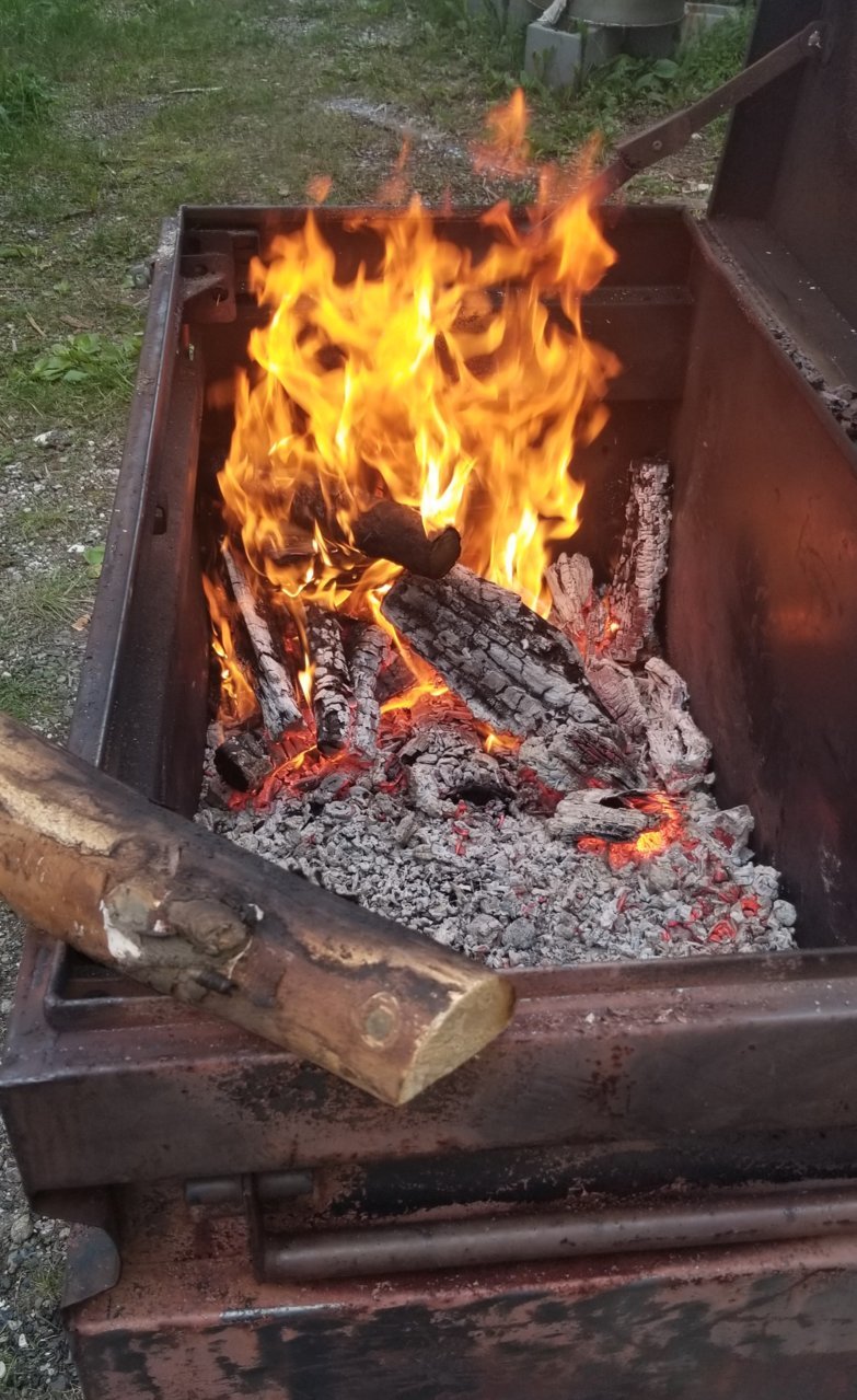

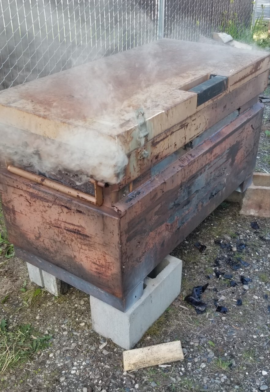

    Weed burner alone is not the answer. I suspected it wouldn't be enough but spent a few minutes anyway. I did notice the bottom panel was moving around pretty good as it heated up. I was trying to do the bottom with the weedburner...
    Next step is to put it up on cinder blocks, open the lid and build a cord wood fire in there.
    Looking like I will need (Visa chore) some square metal tubing ladder-like on the bottom to keep it straight when it is hot, but I might be able to use some of that same tubing as the tuyere.
    After it cools down I will get after the areas I heated with a wire wheel brush, but not holding my breath.
    I should email Knaack and ask if their powder coat is food safe...

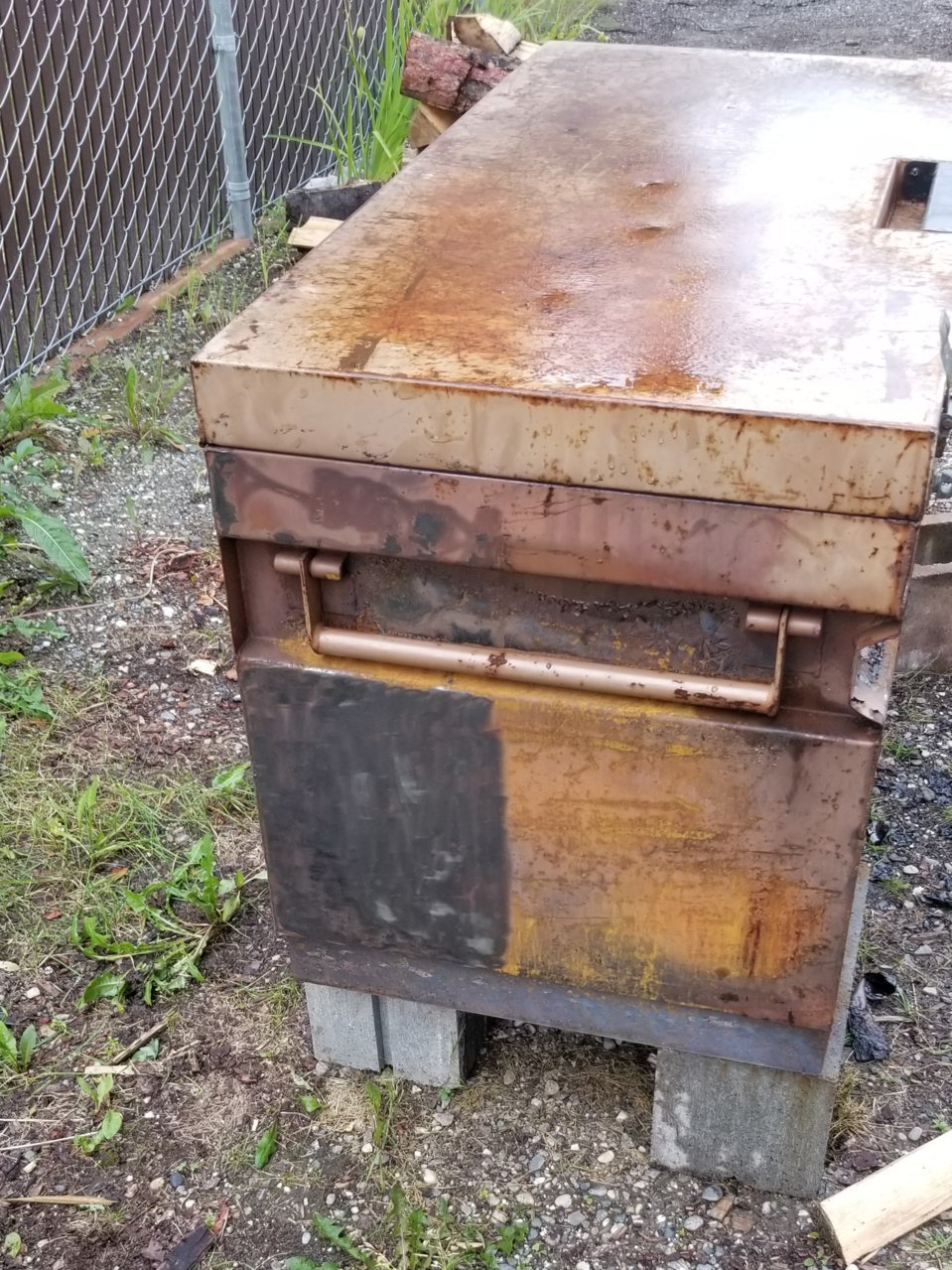

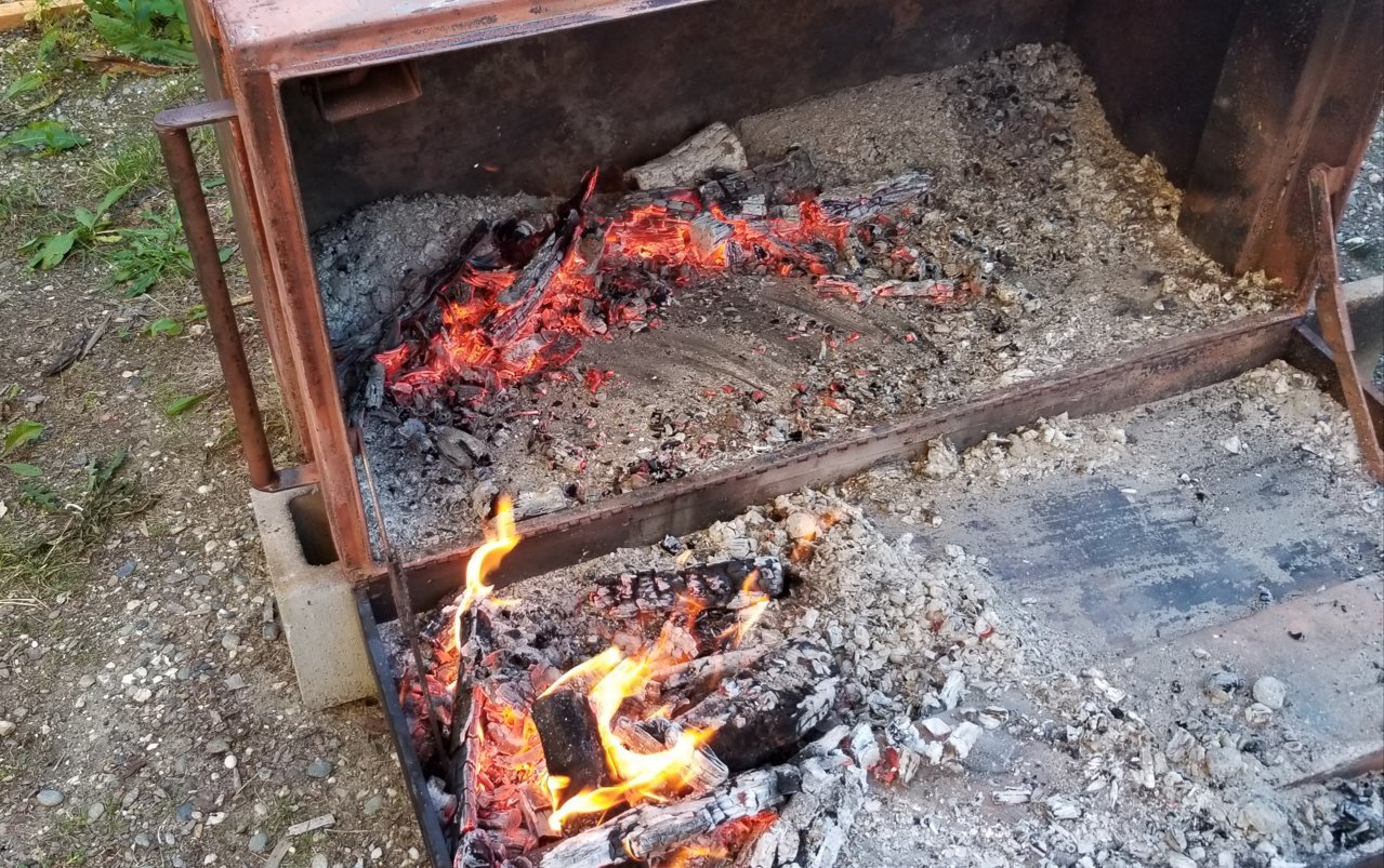

    No response from Knaack last I checked my email, so off the power coat comes.
    I did buy an angle grinder, never owned one before. The areas I had previosuly burnt with the propane weedburner came down to bare metal real nice, but the factory intact powder coat was pretty darn stubbon.
    So today was cordwood fire day. I ran about a basketbal sized blob of burning embers around the edge of the floor, feeding more wood every few mintues and scooching the glowing blob of hot coals every 10-15 minutes.
    I got the exterior pretty well bubbled, spread the coals out on the floor and clsoed the lid hoping to heat the lid panel up too.

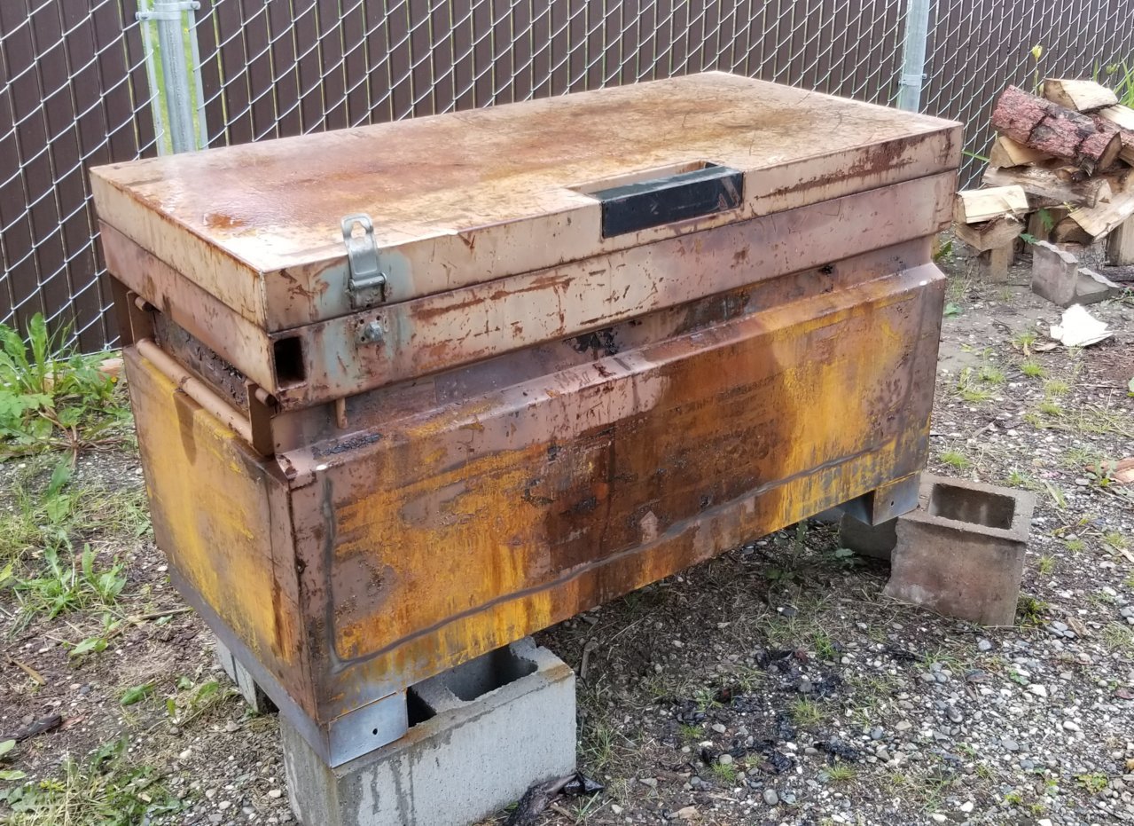

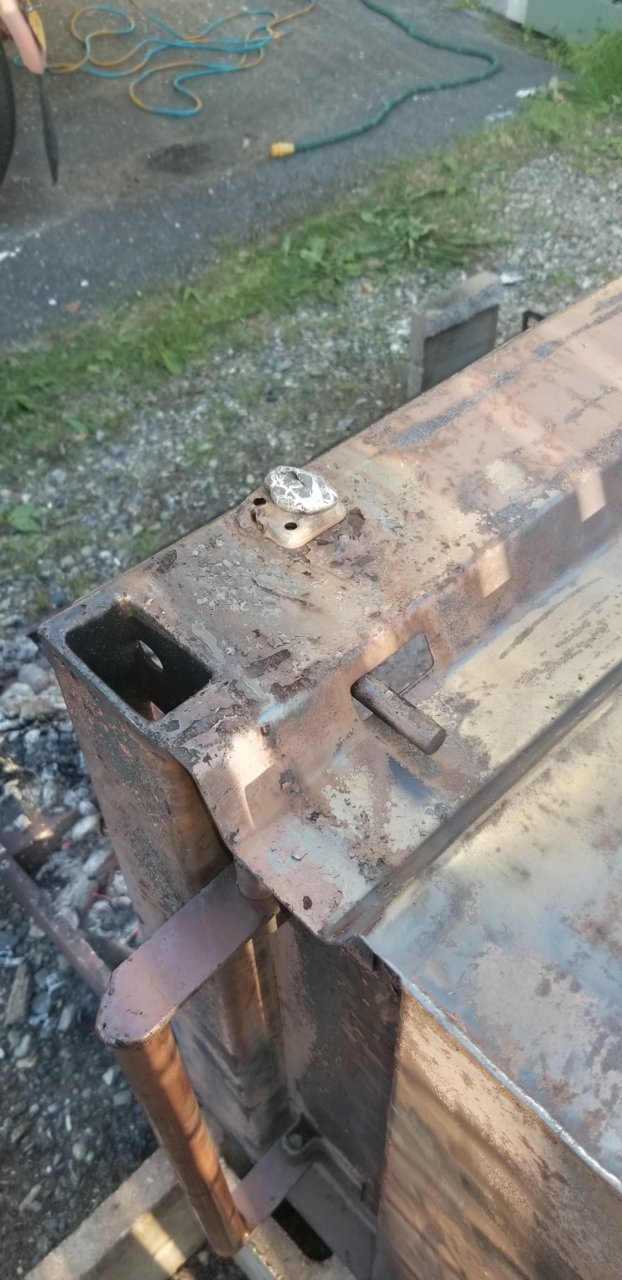

    So three updates. On the one hand I want to keep moving on this, but I don't see the need to create a post for every little thing.
    1. I did hear back from Knaack. I figured in an advance they had no idea this would ever happen and had not tested their powder coat for high heat food safety. So I figured I was going to have to remove it. Here is what the email said, copy/paste: Product Model 4824 is not to be modified. It is not intended to be used as a BBQ grill. No recommendation is made. DO NOT USE in this manner. End paste. I will say, having got about 8% of the powder coat off my Knaack 4824 the factory powder coat is tough as nails. I will think about fabbing the next one from scratch rather than face this removal process again.
    Full speed ahead!

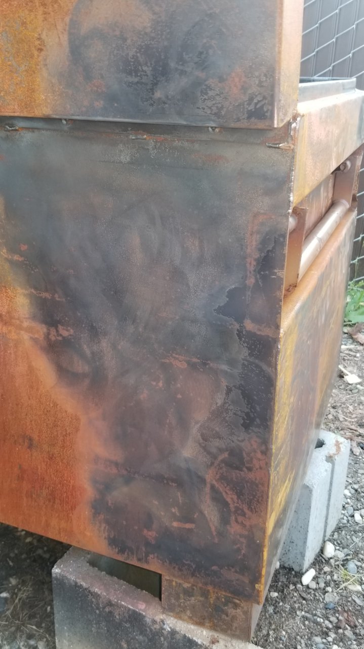

    2) Now that the unit is cooled down, and been rained on a bunch, I cut a very rough line with the wire wheel where I intend for the front panel to fold down and out on a piano hinge; and got busy on one of the end panels. I am going to focus on getting the front and bottom panels clean enough to go to the metal shop. I want some square tubing welded to the underside of the floor in a ladder shape to stiffen the floor, so I got to get that prepped for welding. I am planning to run the tuyere though one of the square tubes under the floor. I also think it will be easier on my back to get inside the thing with an angle grinder with both the lid up and the front panel down.
    I am going to have to do another cordwood burn to get the surface finish off the top too, hopefully better air flow in there with the lid down but front panel open.
    3) I found another show on Netflix with a real Argentine parrilla in it. It was "Street Food: Latin America" episode one, Buenos Aires. The first 90 seconds or so is a chef making an omelet (sort of) with cubed potato, eggs, ham, mozarella and panache. Electric guitar firing up, "boom!". That episode. The chef in the first scene has an authentic looking parrilla in her back yard and knows how to use it. It was about 40 minutes. Another good one, from a BBQ perspective, also on Netflix, but not edited by Norte Americanos was "Todo sobre el Asado." It is kinda wierd compared to normal television in the USA, but I drooled several times looking at the food. Imagine trimming all the deckle off all the ribeyes in a seven rib roast and treating it as a single steak. Both have audio in English, though they do let the kid sing unpolluted (and remarkably well) in the second one.
    I am rethinking my plan for insulating the sides. I want to brick it up to help keep heat in, but the metal of the Knaack box was moving around a LOT when I was burning the powder coat loose.

    I did run a second bigger burn with the toolbox upright hoping the powder coat at the top edge of the walls would bubble. No dice. This fire is bigger than it needs to be to bubble the powder coat on the lower 2/3 of sidewall height, but not big enough to get the top 1/3 to a bubbling.
    I also had a problem area on the back wall, so I turned the thing on it's back so the problem area on the back wall would be on the "floor", and I could move coals around on the inside of the lid too. This fire is "big enough" to get the powder coat bubbling with something like 15-30 minutes direct exposure per each area. I did have it burning a bit bigger for a while to get at the top third of the front wall, and had my propane weed burner running on the outside for a bit too.
    On the afternoons it isn't raining when I get home from work I have been getting after it with an angle grinder 30-40 minutes each day. I am getting something like 90-95% bare metal when I go over a surface with both a knotted wire disc and a knotted wire cup on the angle grinder, and no complaints from the neighbors yet.
    I am done grinding on the front wall and floor, but quite a ways to go with the wire wheels on the rest of the box.

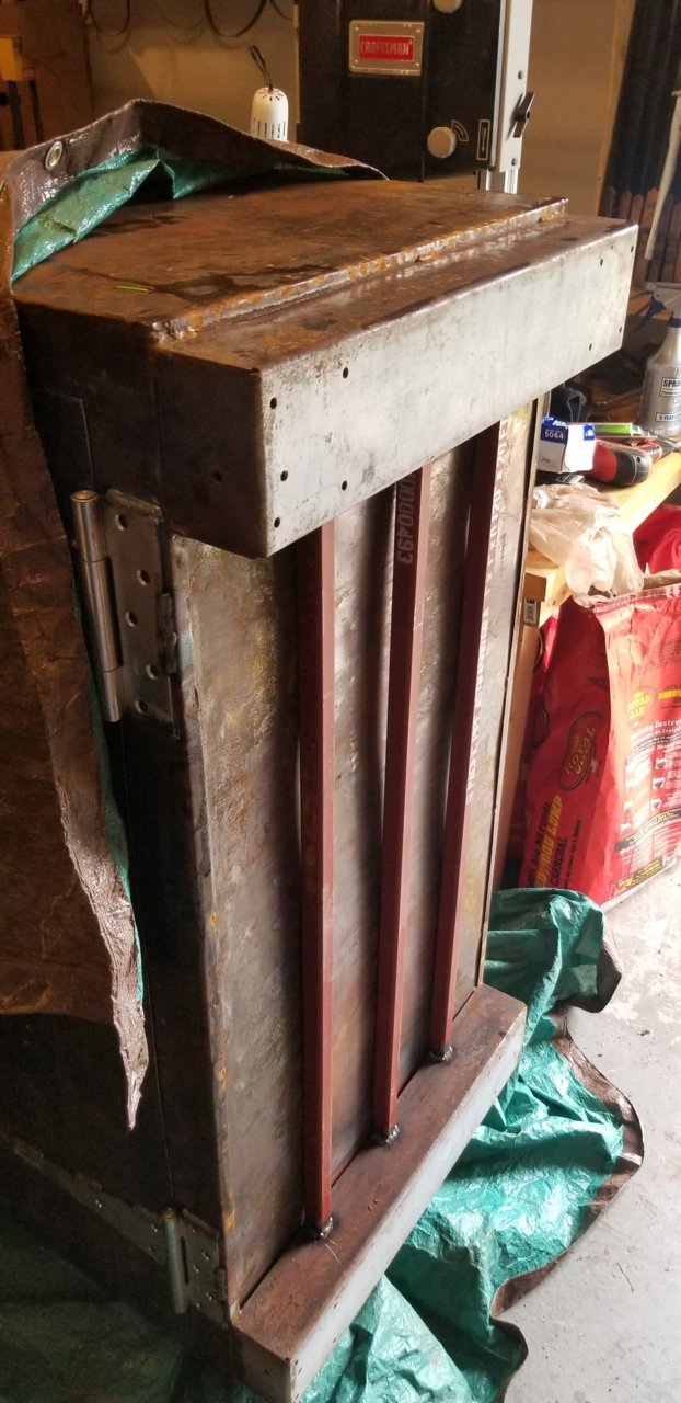

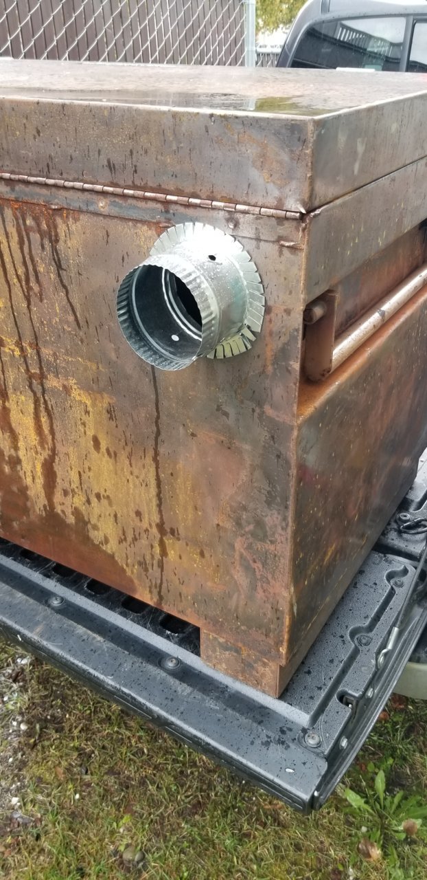

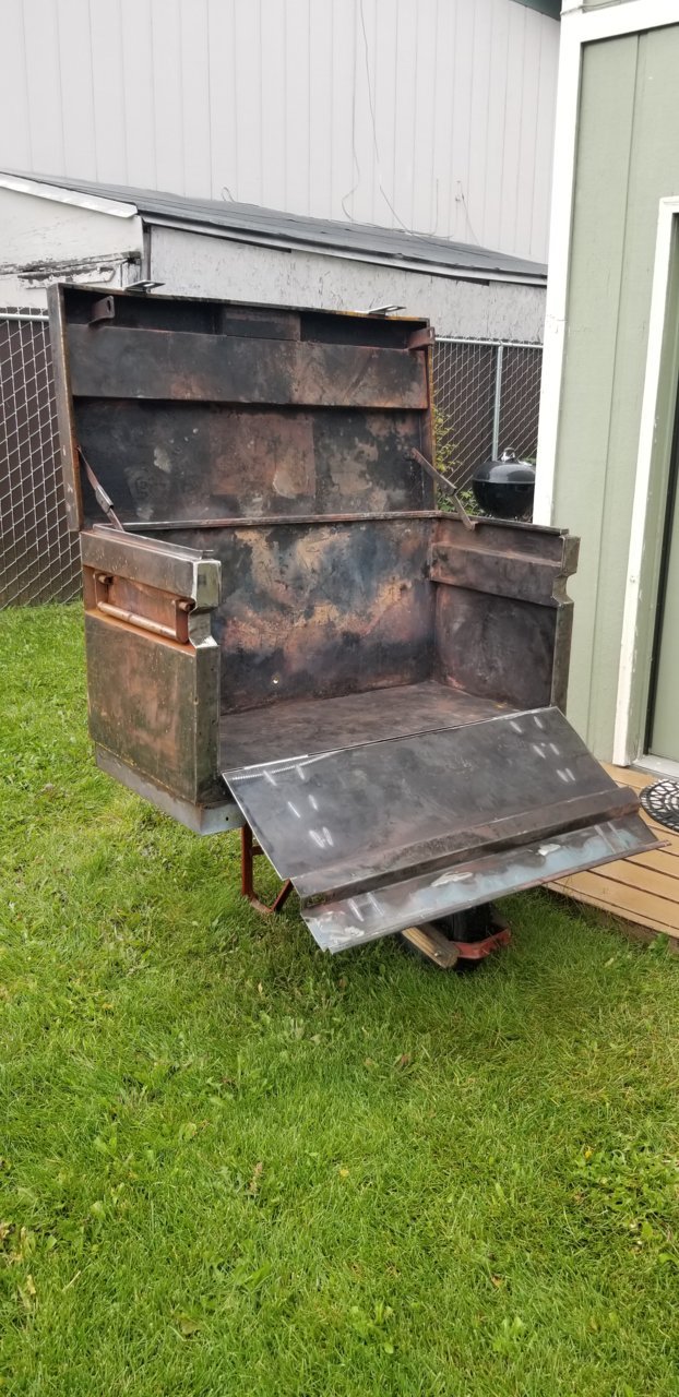

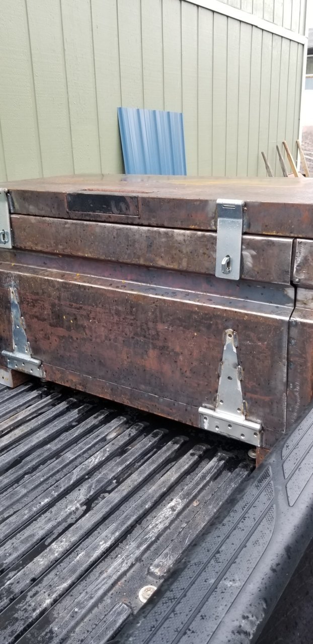

    And back from the fabricators. Next step is to final sand and paint the exterior. I have to do that in the garage as it is too cold here to be running a rattle can outdoors, and I need to get it done and the garage aired out before my wife gets home from the lower 48. So here we are.
    I got the 4" thimble on the back upper left corner as requested. It is from the HVAC section at Lowes-Depot but fits 4" single wall stove pipe just fine. It is like for clothes dryer vents, about 15 bucks IIRC.
    I have the cut, two hinges and two hasps I asked for so the front panel can fold down. And the factory latching system is removed.
    Here it is with the top up and fold down front panel on a wheelbarrow. The front panel is able to fold down 180 degrees so I won't have to reach over it use the cooking grate.
    And here it is in the garage with the reinforcement tubing for the floor welded in.
    I need to get busy with the sanding and the spray paint. I will replace the asterisks with pics when the charging port on my phone dries out.

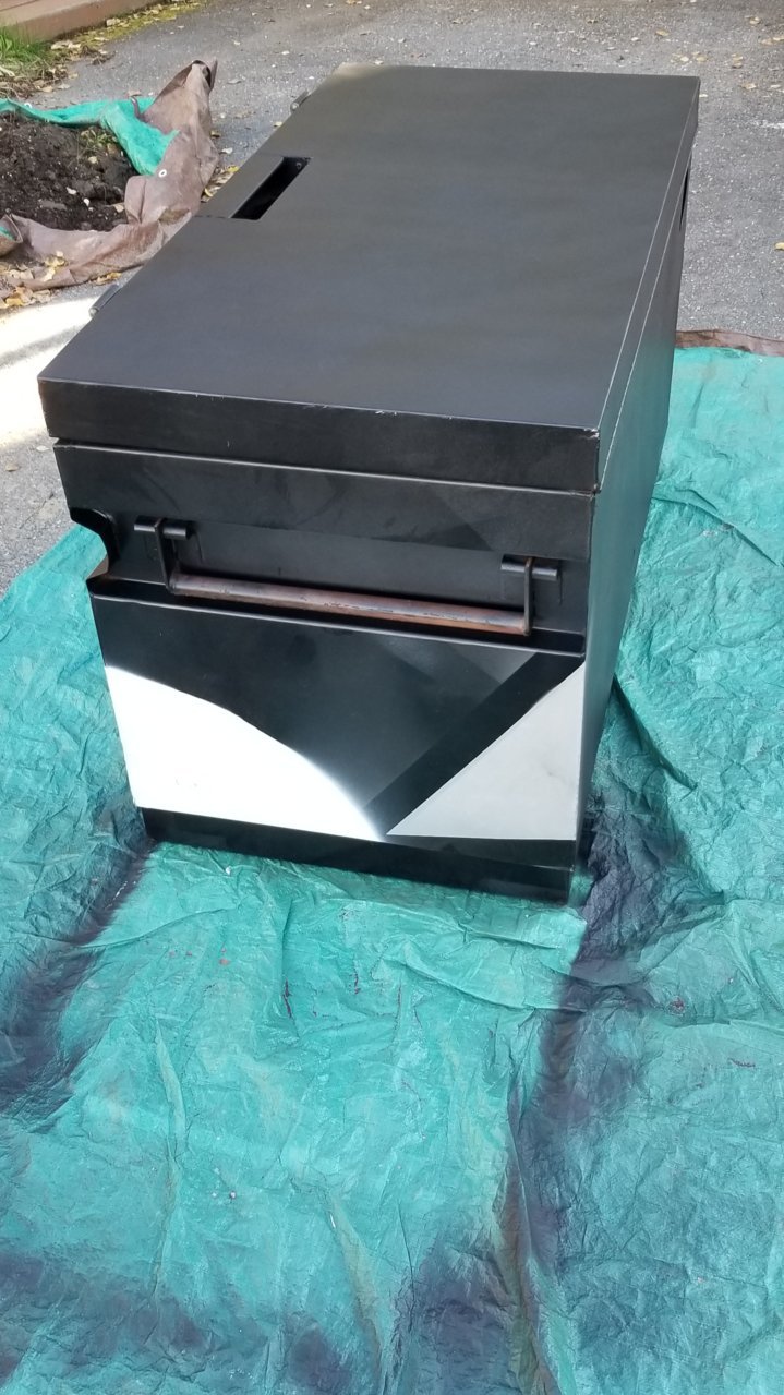

    So I have the bottom sanded and painted BBQ black. I figure very few hunters camoflague their boot soles, plus I can find BBQ black just about anywhere, so done.

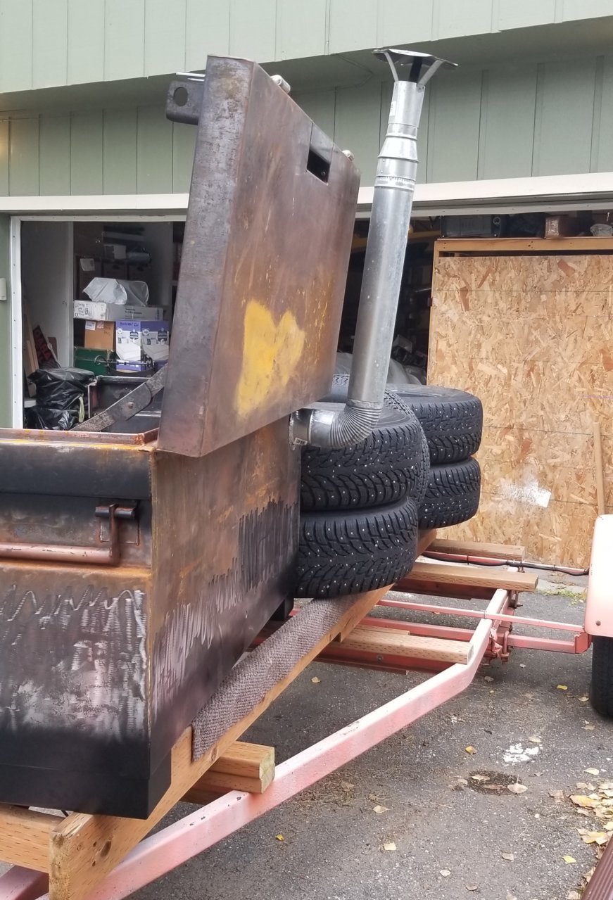

    Here is the Knooker on my boat trailer, kinda diagonal like with a couple cinder blocks for ballast, with the front folded down out of the way and the top up. Note the chimney top left rear.
    I think that is too much weight on the dryer vent thimble, and I can imagine circumstances where I would need even more stack height; so I came up with a cardboard full scale drawing of "a bracket" and texted that to my fabricator already.

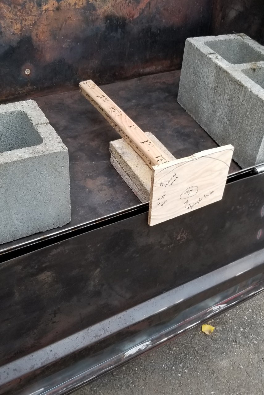

    And I came up with a full scale tuyere shop model. The two firebricks on the floor holding up the tuyere are pumice, I plan to line this thing with clay firebrick, but the nominal size is the same.
    My target temp at the cooking grate with the tuyere running is 1200 to 1400 degrees F. If I leave the tuyere in the hot coals, let it burn out and then air cool I would like to think (or buy the right steel) that I would just be annealing the tuyere over and over and over, not melting it down into the gaps in the firebrick. Is black iron pipe suitable for this, do I need to step up to 1065, or is this going to cost me a lot of money to get right?

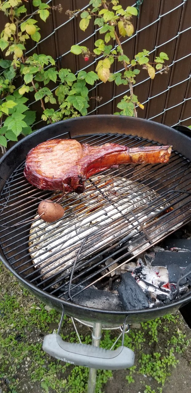

    With only nine weeks to target date remaining I used part of yesterday to test cook with the gear I have. One of the drivers behind the Knooker is to do a lot of menu items at once I end up having to teleport between the upstairs kitchen and the back yard charcoal cookers over and over. I have made all of these components before, but I haver never before plated them all at once.
    The whole cook took 4 hours and 29 minutes, pretty leisurely, and I didn't have to run up or down the stairs at all.
    Here is the mise en place for the Bordelaise sauce. It took 2.5 hours total cooking time after the prep work was done. Lots and lots of checking to ensure it wasn't simmering too fast. Once I had the wine reduced and the stock added to the reduction I had time to fool with potato.
    Once upon a time I had a perfect galette at some little humble unassuming inexpensive restaraunt and I have been chasing it off an on for years. Imagine uniform slices of potato cooked togther so the starch binds the slices in single item. Crispy on the outside like a potato chip, but soft and fluffy like a baked potato on the inside. This is where I need to focus my practice cooks over the next few weeks. I have made 20 or 30 of these since the Knaack box showed up on CL and these are two of the best ones. I don't "know" how to make these yet, but I do know how I want the finished food item to be, to look and taste and crunch and feel. Once I have this dialed in at the indoor kitchen, then I will try to make these out doors on live fire.
    The tomahawk is a familiar item, this one is about halfway through its smoking time on the way to getting reverse seared.

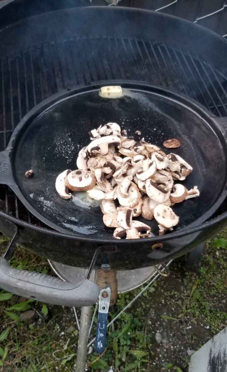

    I have been sauteing mushrooms on a cast iron grill over live charcoal all summer. We did some bacon mushroom swiss burgers at the August church picnic, my team picked it up pretty quick. Just stick a cast iron grill over hot coals and let it warm up for several minutes. Make darn sure that if any butter overflows the low end of the grill it doesn't drip into burning charcoal, that would be a big mess in a hurry. I use a regular spatula for the cook and same spatula and a pastry knife or dough knife to moved the cooked mushrooms from the grill to the cambro. Once the grill is hot, 1/4 stick of butter, let that pretty well melt, swirl it around, then one grocery store packet of mushrooms about the size of a pound of hamburger, swirl that around in the melted butter. Leave the lid off and the mushrooms alone for about a minute. If they aren't cooking, put the lid on for another minute and look again. I like to have the mushrooms cooked in four minutes or less, so hot fire and preheated griddle. If they cook much longer than 4 minutes the mushrooms absorb more butter than I want. About half way through add another 1/4 stick of butter.

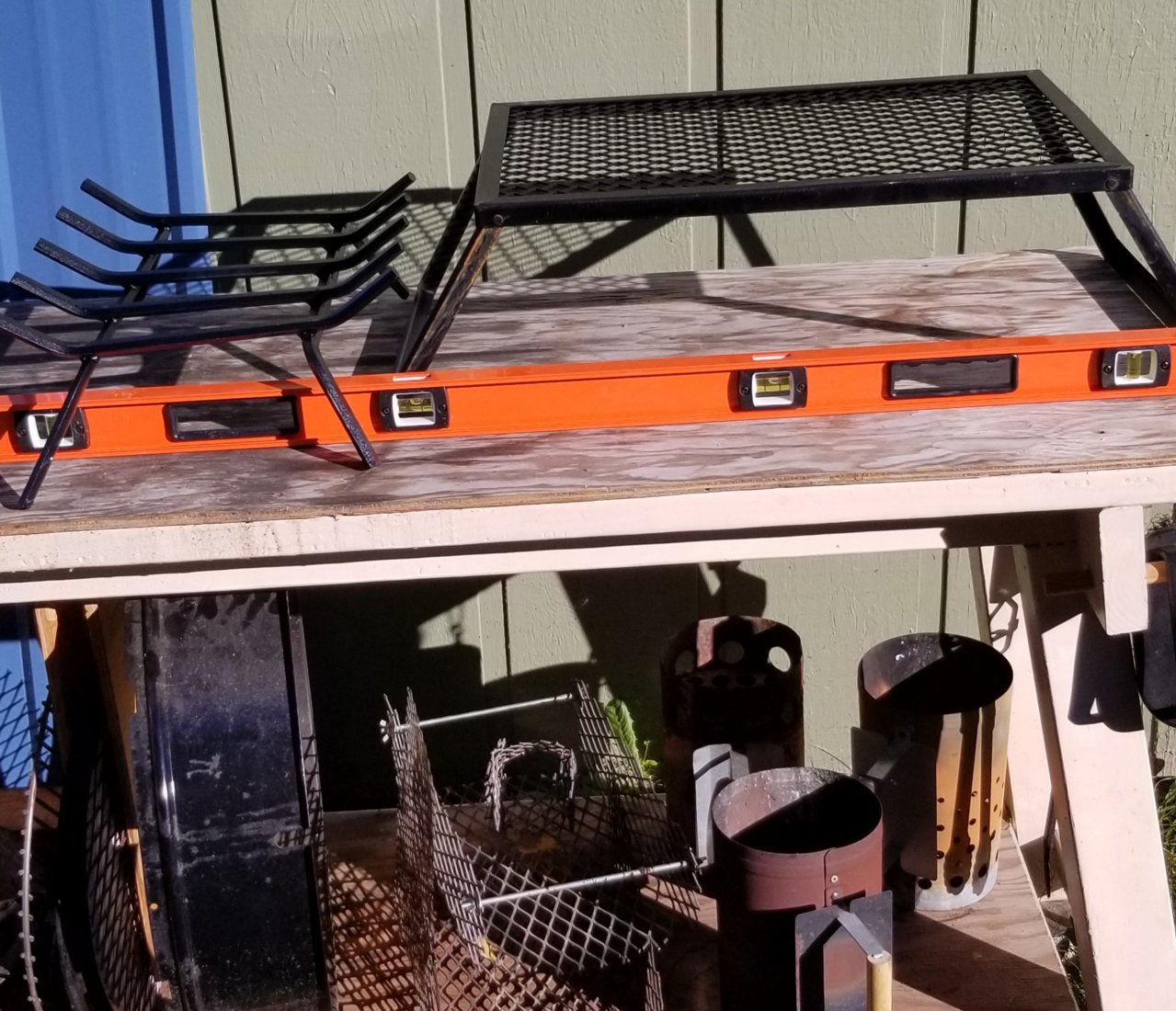

    In other news the fire grates came in to Kroger today, but no fire brick at Lowes-Depot yet this fall when I was there yesterday. I picked up an "over fire cooking grate" at I think Kroger a few weeks ago, so my basic/ starter iron hardware is ready to use.
    I expect I will end up hating both the fire grate and the cooking grate with a white hot hate. But I will know why, and knowing why I hate them is the experience I need to specify the higher dollar things I will want to replace them.
    And I finished sanding today. I had started in three color paint on the one end but it took forever to apply three colors and the weather is cooling off pretty firmly, so as of today I have all six exterior faces sanded and painted BBQ black. I brought it into the garage overnight for the paint to cure fully. Tomorrow, it is going outside so I can put my garage back together and get going on a wooden support table.
    Once I have a wooden support table ready to go I'll get busy sanding the inside of the Knooker in preparation for oil baked finish. My fabricator is not ready for me to bring this back in to his shop just yet. He is looking forward to having it back, and I did peel off Benjamins within two hours of him telling me it was ready last time, but custom BBQ cookers is not the core of his welding/metal business. Sanding the inside of that lid is going to be a pain in the neck.
