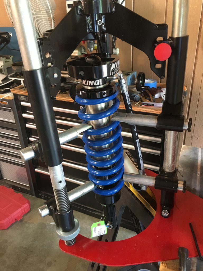

    For sure. Since I have a Branick, I'd rather just pull the shocks to adjust ride height. And on the branick, it still gets harder and harder. Even with the shocks fully extended, your springs are still under compression. Your adjustment ring is aluminum and the shock body is steel. The aluminum will wear eventually. A few squirts of lube will help.
    These are the kings on my wife's 4Runner :cool:
