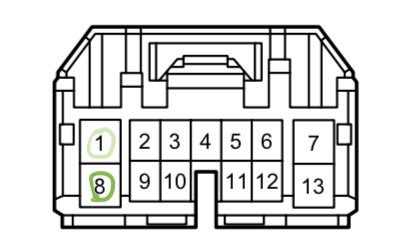

  17. Sep 6, 2018 at 5:12 PM
    #37
    destin_meeks
    destin_meeks I used to fix people's crappy stereos
    Jul 14, 2017
    #223997
    3,931
    Destin
    Tuscaloosa, AL
    2017 SSM DoubleCab TRD Off-Road 4x4
    Looking for a 13 pin white connector in the drivers kick panel.
    Some wire colors may include
    Pink
    green
    sky blue
    yellow
    red
    purple
    another green
    beige
    light green
    may be more, those are just the ones i see
    You want the green and light green in pins 1 and 8. they will be right on top of each other.
    Green is +
    Light Green is -
