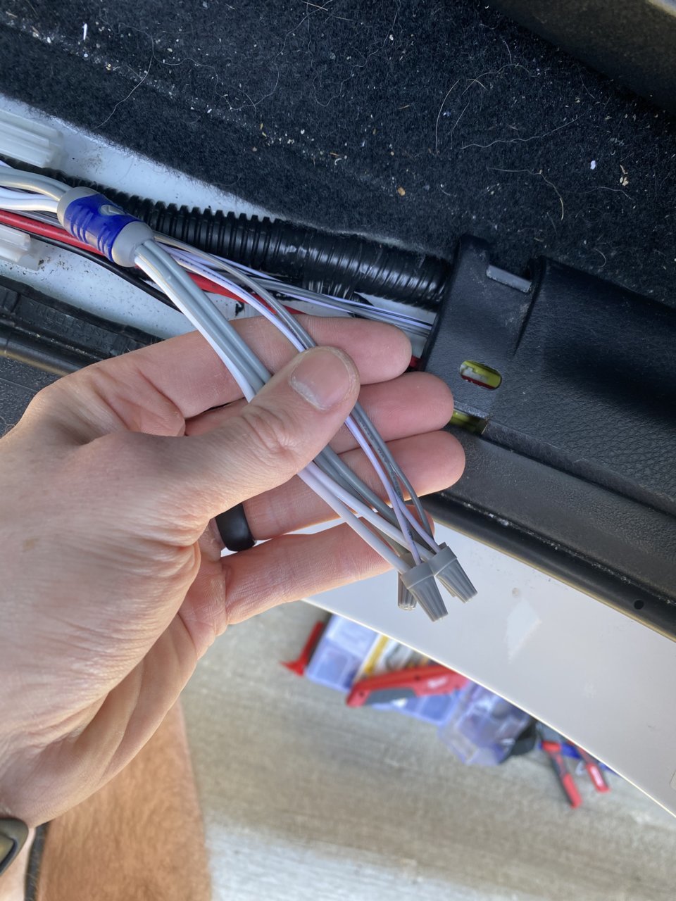

    Yea that’s what I came to the conclusion on. I ended up getting power to the amp once I plugged that wire in with the red (just to see if amp itself was bad)
    now I’m just wiring it up. I found the remote wire to my pioneers harness to wire up to (blue and white) but the power antenna wire is currently wired with those.
    Can I wire al 4 up together or is that too much.
    Pictures is my current wiring (pioneer unit. Maestro kit. Stock antenna power wire)
    have not connected turn on wire yet
