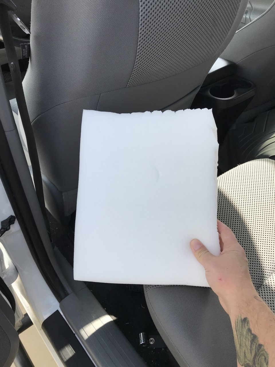

    A couple questions. I’ve had this installed under my DS seat for about a month and I like it. I put a 1” lift on the rear of my DS seat and I lost about 1/2 the bass it was producing!!! Took the spacers out and it sounded good again. I did this several times to make sure I wasn’t imagining it. The sub almost sounds blown when I put the spacers under my seat. Why is this?
    Also, when I have the remote bass knob plugged in, isn’t that supposed to cancel out the gain dial on the side of the amp? Mine doesn’t cancel out when the remote bass knob is plugged in. I can still adjust the sound using the knob AND the gain dial on side of amp.
    Thanks!

    For the remote, it is acting as it should. The gain control is for input gain, the the bass knob is for volume. Typically, the gain should be set when the bass knob is at 50%.
    For the spacers, I'm assuming it's about the gap between the speaker and the seat bottom. That's crazy that it loses so much sound when the seat gets tilt up that tiny bit

    It sounds better than good when seat is normal height. It sounds weak & almost blown when I lift it 1" with the spacers. It's an amazing difference!
    I really like the seat up 1" so it looks like I'll have to find a way to mount it under the passenger seat.

    So I really didn’t want to rewrite this sub so I got to thinking. What’ll make the sub think the seat is 1” lower?
    Seat foam pad! Went to Walmart and bought a piece that’s 1” thick and cut it to size. Now the sub acts just like it did before the seat lift!
    siKjiTz likes this.

    Resourceful! Love it!
