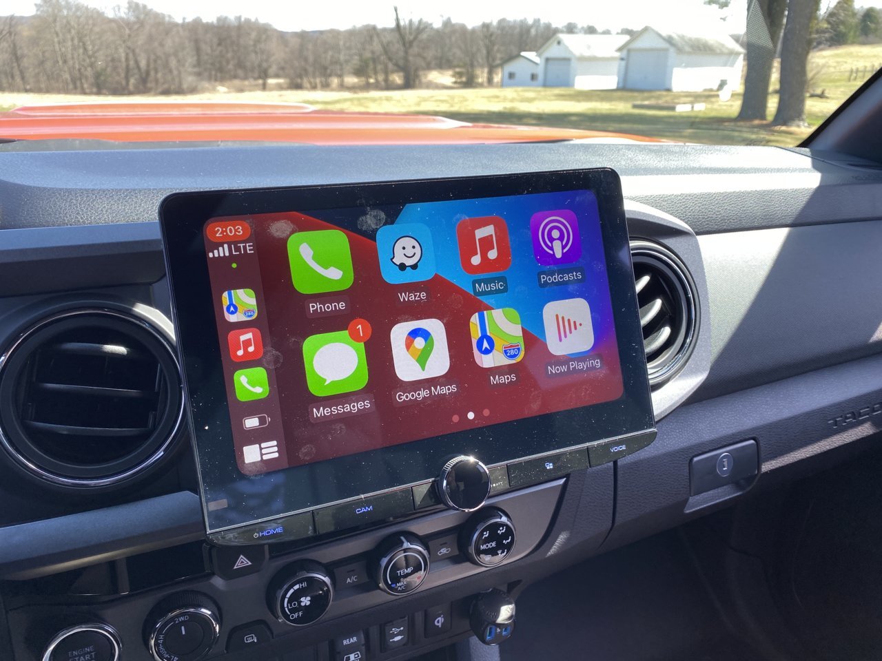

    Hi all,
    I finished installing the DMX1057XR in my ‘18 Tacoma today. All in all, it was a fairly simple install. The toughest part is routing the mic, dash cam and OBDII cables under the dash and up to the radio. I only had one hiccup: I couldn’t get my backup camera to show up. But it was my error - I forgot to make one of the connections on the backup camera harness from iDatalink. Fixed that and all was good. The image from that camera is so much better than it was on the stock screen.
    I also installed a Kenwood DRV-520 dash cam. Nice camera! Three wires for that have to be spliced in to the radio harness, and one pin connector goes into the back of the receiver. A yellow RCA jack plugs into the yellow dash cam connector on the receiver, and that’s it.
    The head unit is really nice. I installed it in the retracted (out of the box) position and raised the screen up one setting. It’s really easy to connect, but I did have to fit the receiver a few times to get it flush with the dash kit. The Metra kit I was planning to use did not fit at all, so I used the American International kit Crutchfield included in the installation package I purchased. As Dean from 5 Star pointed out in his recent video, the radios are angled a bit on the Tacoma, so I needed to shim the right side of the dash kit with washers to get it flush. Two on top, three on the bottom.
    I installed the mic in the factory location but I don’t think I’ll keep it there. My daughter said I sounded muffled. That may be because I put foam on the sides of the opening. I’ll try it without the foam, and if that doesn’t help, I may just mount it on a corner lip of the overhead console.
    I’ve attached some photos (wireless CarPlay is soooo nice!). I’ll also post pics of the mic setup I came up with along with some other installation notes.
    The only advice I’d offer anyone considering doing this is to watch some videos and to pay very close attention to the instructions and wiring guide you get from iDatalink after you flash the Maestro (which you can now do on your phone or tablet).

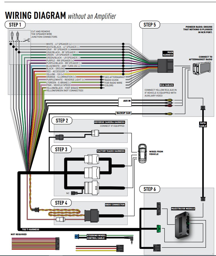

    Here’s a photo of the wiring guide. The OBD harness plugs directly into the truck’s OBD pin connector under the dash. There are also two small 2-pin connectors (one white, one black) that connect into the iDatalink T-harness.

    The instructions tell you to unplug the black connector on the harness and plug it into another black connector (the wire colors are the same). Then you make a white plug to white plug connection.

    Got to installing today. Couple of questions:
    1. The unit is not switching over to the reverse camera when placed in reverse
    2. Steering wheel controls aren't working
    There's some other issues, but I think I know what's going on with those.
    To fix those two issues above, I have a feeling I know what the problem is. On the back of the headunit there's two plugs for the Maestro. A multi-pinned plug and a 3.5 headphone jack. I only plugged in the multi-pin and now wonder if I should have used the other one as well. I'm guessing so. There is a blue-ended plug in the Maestro box that I believe is the right one. Am I right? And if so, what does the loose wire get connected to?
    Thanks guys. I wish iDatalink was a little more specific in their instructions.

    I had the same problem with #1. Make sure you plug the yellow male RCA plug from the backup harness into the yellow RCA female plug marked Backup Camera (or RearView Camera) on the head unit. There's also a multi-pin connector on the backup harness that connects to the Maestro harness (that's the one I missed initially).
    For #2, make sure you flashed the module correctly with the correct serial # and double-check all your connections. Follow Step 4 in the Maestro installation instructions VERY carefully. Lastly, reset the Maestro per the instructions on the bottom of the Troubleshooting table.
    Note: You don't need to do anything with the 3.5mm headphone jack. All you need to do is plug in the pin connector to the head unit. You don't need the blue-ended plug. All you need is is the data cable (that's what gets connected to the back of the head unit).

    When you flashed the module, it should have resulted in a set of instructions and a wiring guide (see above in post #44). The wiring guide tells you what to do, as well as which cables and harnesses in the package you need and don’t need. Let me know if you need it and I’ll upload it for you.
