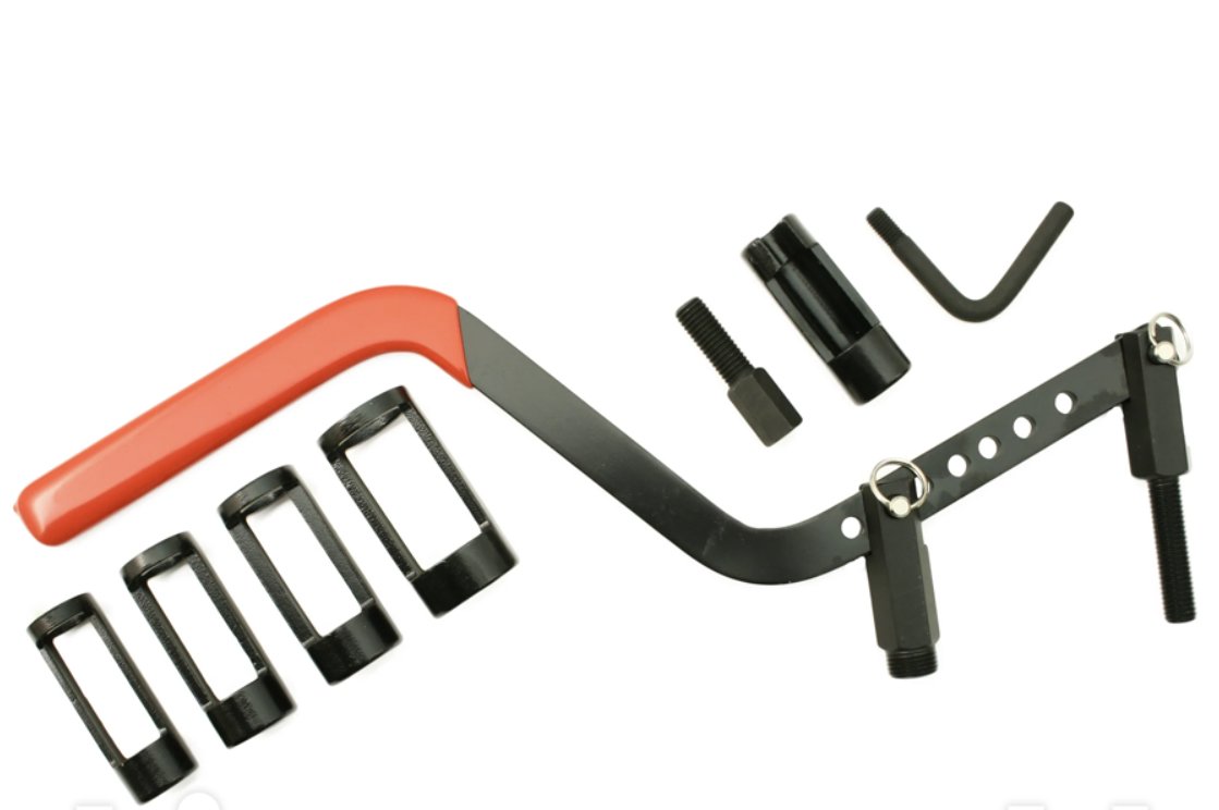

    There's a brand that @Torspd has that might work.

    Mine would likely only be best used with the head off. It is similar to the Lisle brand.

    this when modified was capable of removal only.

    I have this and used it a bunch on vintage moto engines, but that doesn’t even fit the Tacoma head. On Jesse’s truck we ground it down to make it fit. After that it works pretty well for the stock springs but you can forget about getting the super stiff Kelford springs in with it. Especially forget about it if you’re doing it in the engine bay without pulling the heads. We ended up getting this:
    https://www.jegs.com/i/JEGS+Perform...MIvrX3rt3l_AIVwh6tBh2VIQiOEAQYHCABEgKUoPD_BwE
    Still a two man job, so if doing it solo, I’d look for something with a screw type instead of the lever handle. And get a topside creeper. Your back will thank you.
    if I’m getting the 2UZ cams in this GB, I’m pulling the heads that’s for damn sure.

    I like the lever style spring compressors better. Fortunately I have a spare engine I'm building so don't have to do it in the truck.
    like dis.

    OMG as a short dude, why do I not already have one of these!!

    Maybe you a glutton for punishment like me. I don’t even have a regular creeper. Just the ole endless supply of Amazon cardboard. You could always deflate front tires or just take em off…. But for cams, AND doing them on the motor in the engine bay, just get the creeper :)
