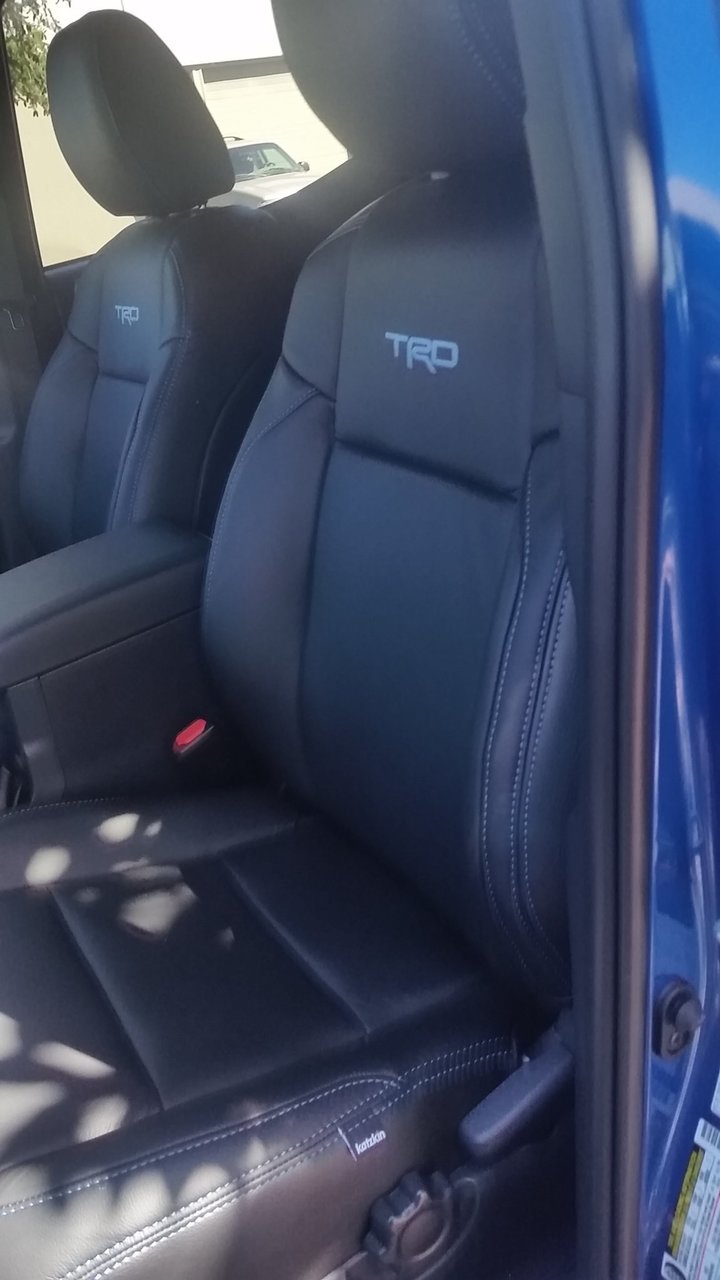

    4
    2017 Tacoma DBL cab TRD off road
    I went with black with blue stitching to match my truck.

  11. Jan 14, 2018 at 6:26 PM
    goose443
    goose443 Well-Known Member
    Jun 8, 2016
    #189076
    741
    Austin
    Texas
    2016 Tacoma TRD Off Road 4x4
    That looks awesome

    Looks great. I never got mine to look at crisp. Did you steam it or something?
    I had mine professionally installed... I figure buy once cry once :<)
