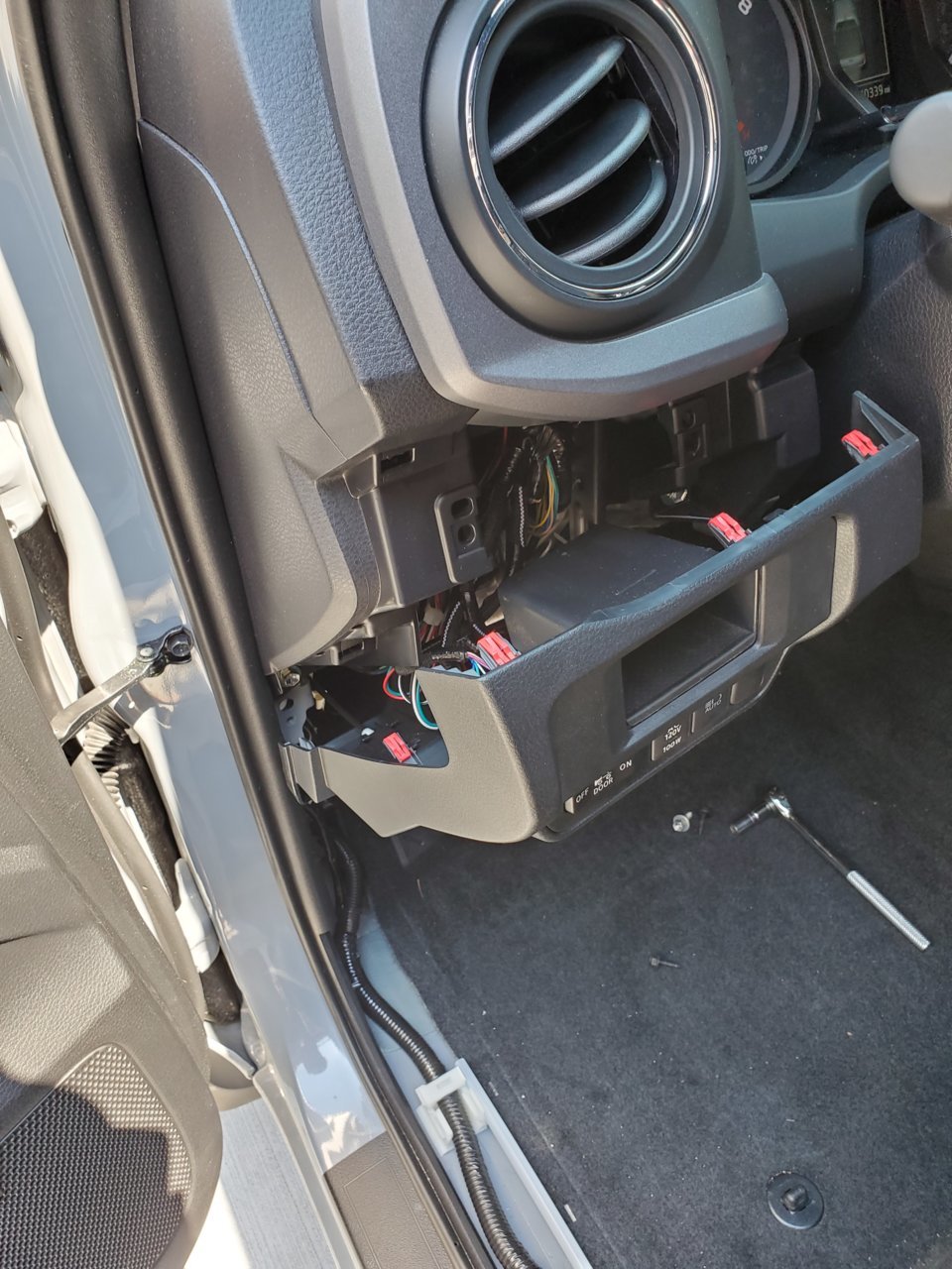

    Thanks OP for motivating me to revisit this. That article is what made me suspicious and investigate. Looking from the bottom up, I was pretty sure my truck had this device installed but there was no way to get to it from below. What I had to do is remove the kick panel on the lower left - one twist off plastic nut and remove the lower dash - 2 phillips screws/ 1 10mm bolt. The lower dash can just be popped down out of place after removing the screws. Once I did that, this is what I saw:
    It was double sided taped on that ledge way up there with the green square. Cut two zip ties, pull out all the wiring. Unhook the harness from the trucks OBDII port and replace it back in the OBDII holder. I just yanked the module out and it was all gone. End result:
    Thankfully the dealership was smart enough to use this OBDII harness and NOT tap into factory wiring.

    Thank you so much! I'm in the process of doing it right now. Looks like I have the same model installed, they didn't splice the wires either just plugged into the OBD

    And it's out!!! Thank you so much for showing me what to look for, I really appreciate it.

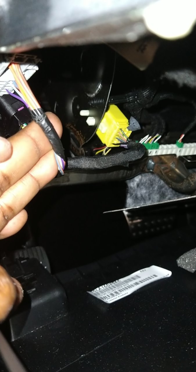

    Anyone can help with a 2019 challenger. I definitely have Kahu installed but can't fine it???

    Look at the OBDII port for a harness and zip ties behind the dash and follow wires. You’re most likely going to have to pull out dash panels.

    This looks suspicious but it doesn't look like the other ones you guys posted.. it's the only thing wrapped in electrical tape directly on the wire.
