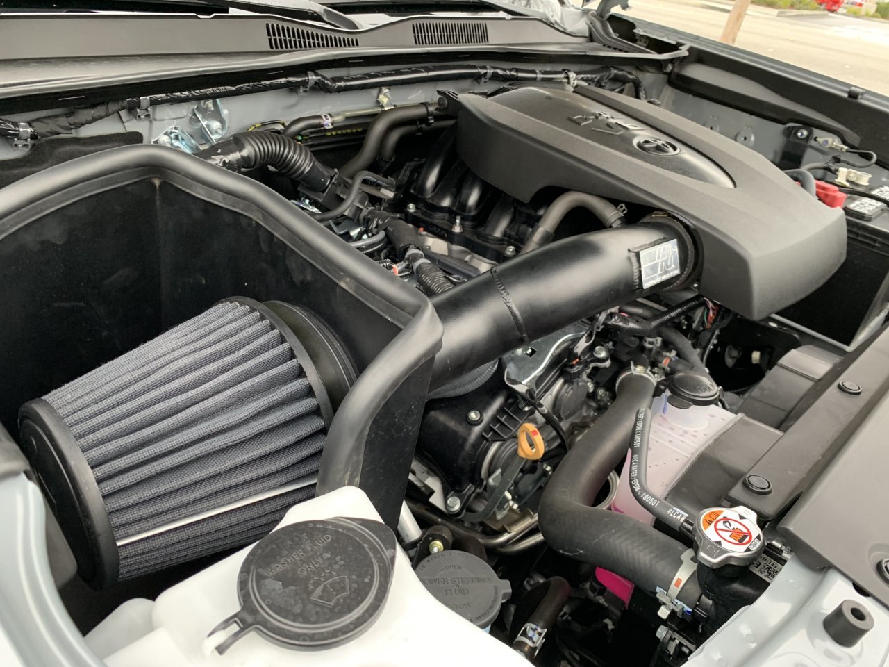

    Hey guys I had the same issue about a year ago with my black hawk K&N intake. Same warning ⚠️ signs and everything. I was pissed so, I contacted K&N directly and they took my truck in for observation for about a week and gave me a loaner (true story).
    The outcome was the K&N intakes just gives TOO MUCH AIR, giving the sensor a false reading. K&N ended up have to modify my intake piecing two different intakes to make one. By doing so it controlled the airflow but, still gave me the Aggressive Rohr and performance.
    Here are a few pictures of warning ⚠️ signs and my original Black Hawk intake. I’ll take pictures tomorrow and post what they installed for the fix.
    Contact K&N ask for Kyle. My case number should still be on file K&N (#4161). Customer Service was awesome and everything was free. I have nothing negative to say about K&N!
    Feel free to message me if you have any questions.
