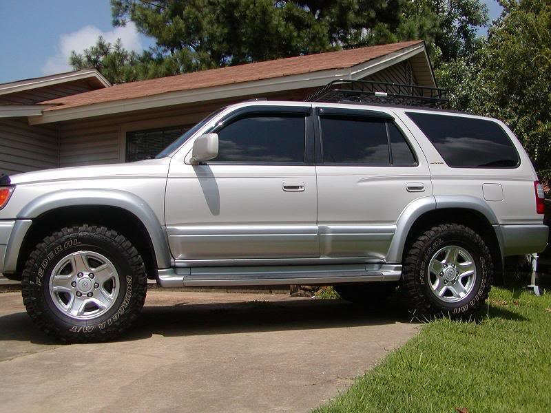

    Sick 4runner. How did you like those federal mud tires?

    The federal tires were extremely loud, even brand new. They balanced well though, slung mud, and had good traction on the main trails. I never used them in the rocks. All that and they're cheap(ish).

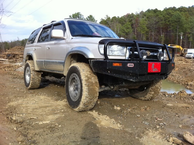

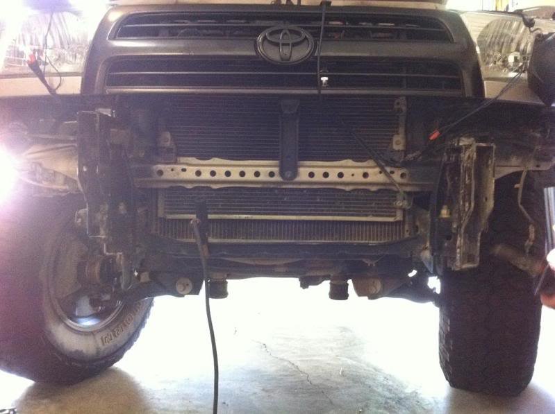

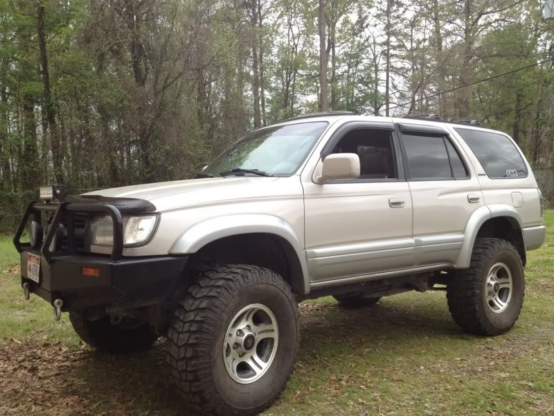

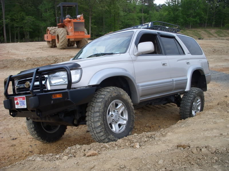

    How'd you redo the mounts for the arb to accommodate the bl?
  11. Jun 24, 2012 at 4:25 PM
    JWaldz
    JWaldz [OP] It puts the Joe Dirt in the hole
    May 23, 2012
    #79405
    2,015
    Waldo
    Colo Springs
    99 4Runner LTD
    WPS! Thanks bud
    A buddy and I took the bumper off and cut the mounts in half, welded them back on 2" higher, and gusseted them. Lined up perfect. I don't have a winch (yet), but if I do get one I'll probably plan on reinforcing the end of the frame rails.
    Left raised, right stock

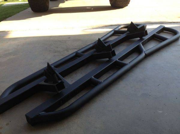

    Well here's an update.
    My not even a year old Die Hard Platinum died. Truck had been having issues starting. So I took it up to Sears and they confirmed it was dead, and warrantied it. Just strange why it died and it got me thinking, maybe I need to clean up my rats nest of accessories. So I ordered a Blue Sea Fuse Block and breaker to aid that. I also treated myself to a new Milwaukee Impact Wrench so I can quit borrowing impacts on the trails :D

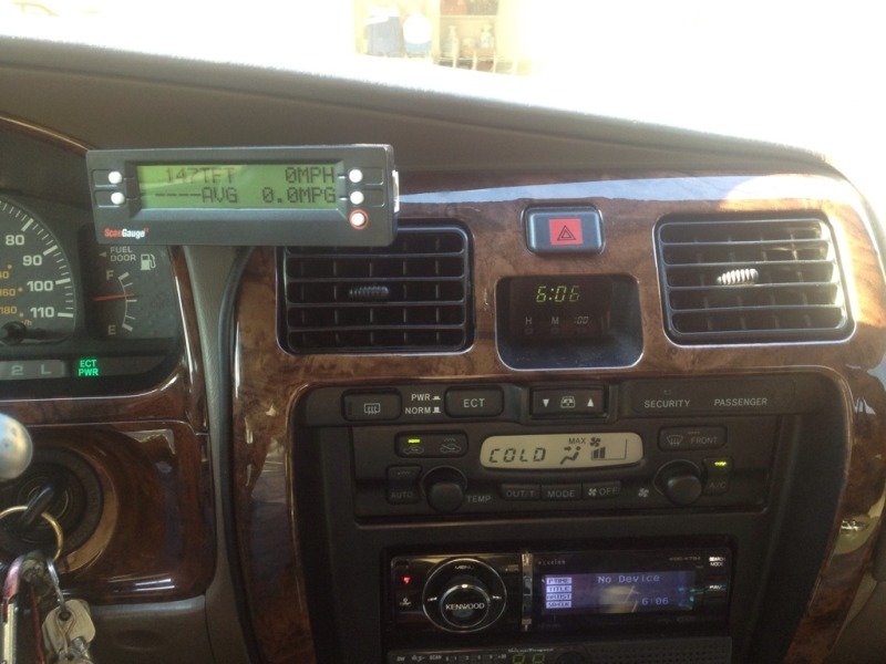

    I wanted to keep an eye on my Trans Temp since my truck is getting older as well as have a little better idea of how fast I'm going since tires kinda throw that off. So I bought a ScanGaugeII for like $80 bucks. Couldn't pass it up.
    37C8E668-06C7-4584-BB65-59DA84D9430E-225_b0f4b9cf01b0ae87106d26ce0236e32a84eb9d96.jpg

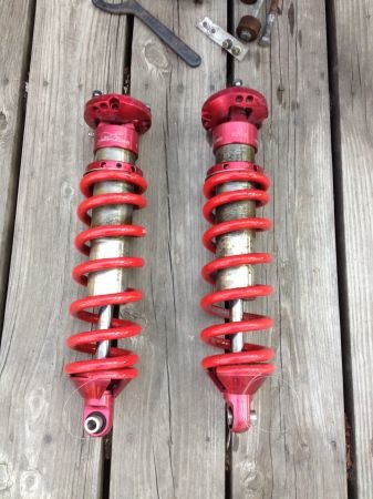

    I was scrounging craigslist for tires, just to see If I can get by not spending a small fortune for new ones and I found these. $300 smackaroos and a 30 min drive later
    Sway-A-Way 2.5 CO's
    Lastly, before I left to pick up to CO's, I got home and found these at my door step. Man they're sweet!!
    B.A.M.F. Sliders
    Welp, that's about it.
