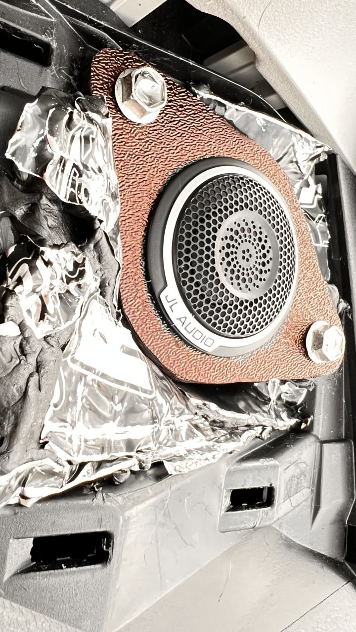

    Ok I know Im Arriving late to the party on this comment
    But after spending money on numerous combinations of tweeters and mids this is what worked better for me
    I did installed the 6x9 JL audio speakers shown in this picture and I had no problem whatsoever they fit perfectly with the meter brackets provided by Crutchfield
    I also have the C7 tweeters on the dashboard actively powered with a JD 400/4 JL audio and Mosconi DSP (possibly getting a cleaner amp in the future but this is more than enough at this point)
    I can assure anyone this combination works I’m able to equalize through the dsp and dial the sound I was looking for.
    plenty of mid bass and clear and loud mids and highs.
    You can get so much midbass that you won’t even need a subwoofer at times!
    However I’m running a tw3 12 inch JL audio with the RD500 amp
    If you’re still looking don’t waste your money with anything else.
    I obviously invested in some sound deadening material for the two doors
    After I showed a few shops in my area they were surprised how good the system sound and they thought I had more expensive speakers
    I don’t have pictures of the 6x9 installation but I do for the c7 tweeters
