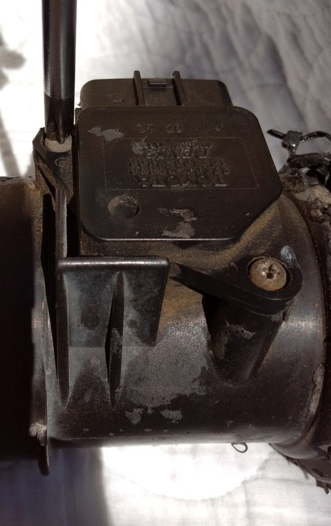

    The Vessel ratcheting driver set turned out to be the most useful because it contains 1/4 bits that I can use with my existing offset driver set. The Vessel #2 and Hozan drivers are great for regular use. In the next picture, I will show how I recently used the Vessel set to remove the MAF screws.
    Here's a picture of the Vessel #2 driver that I used to remove the MAF screws.

    If you plan to work on Japanese vehicles, you will benefit from having a JIS driver set in your toolbox.
    Having the right tool to do the job will save time and avoid problems associated with using a Phillips driver on Japanese Industrial Standard (JIS) screws.
