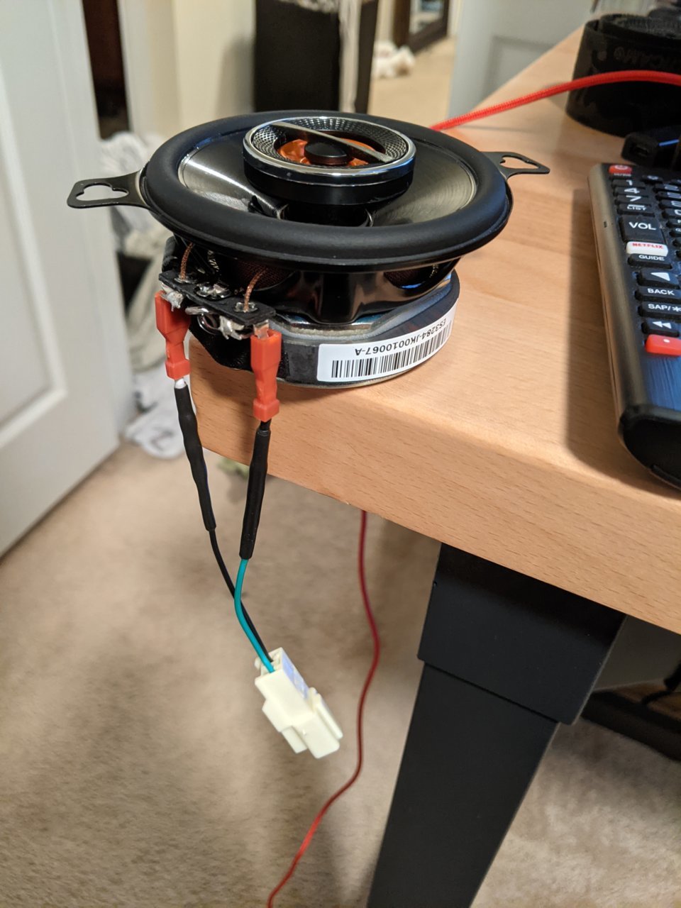

    So, the link posted from Amazon on the tweeter connector is the actual missing link to making the upgraded speakers PnP?
    Thanks!

    I'm assuming it should be the correct one. Hard to tell.

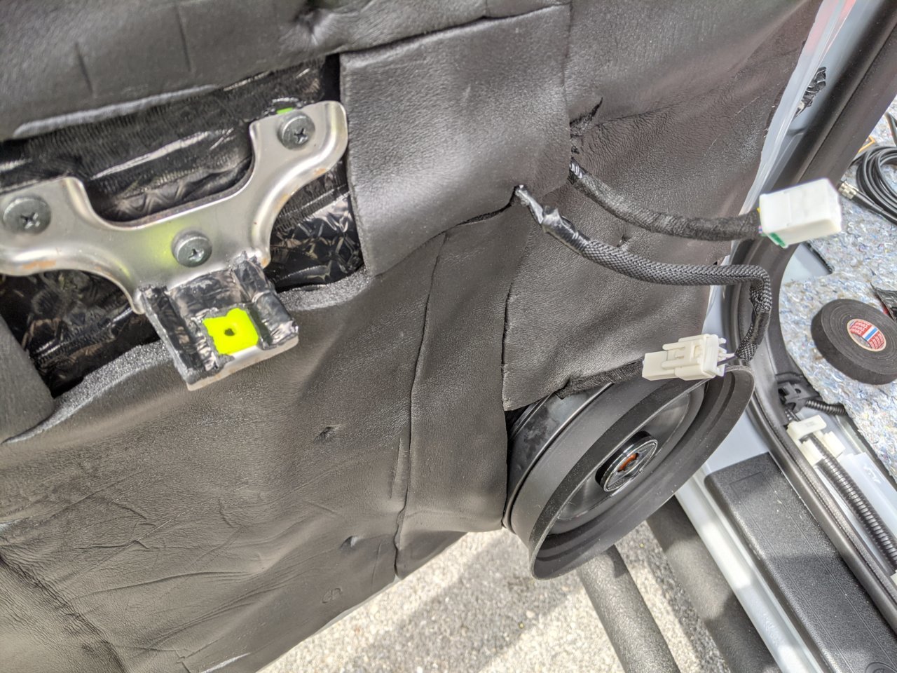

    Tesa Tape all the things!

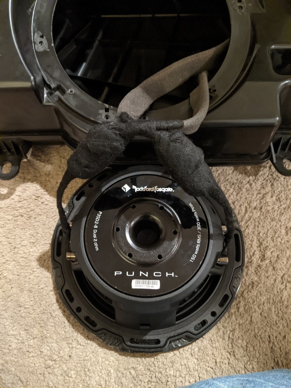

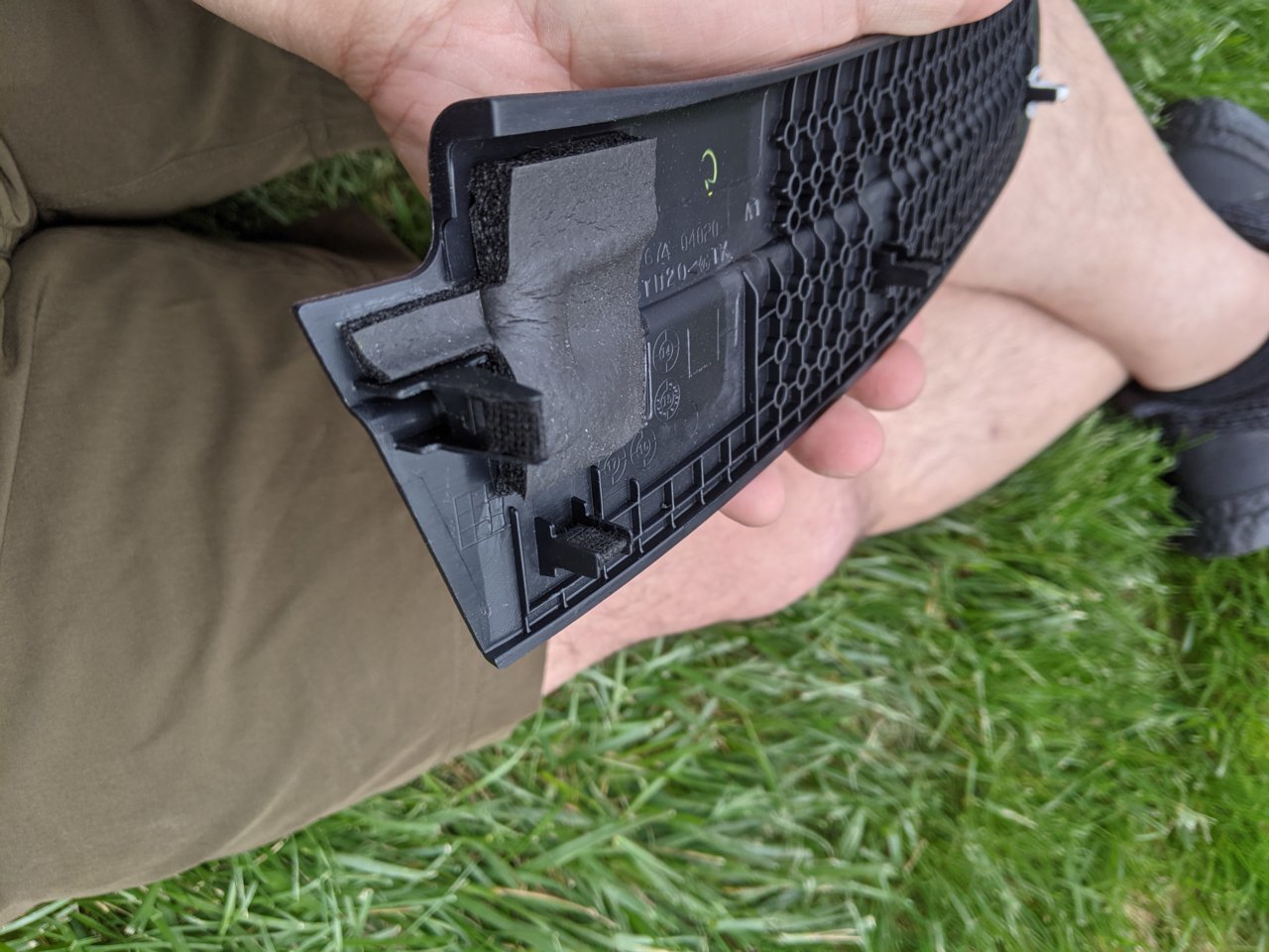

    Took the sub apart again. Wrapped the connectors with open cell foam and wrapped it in TESA TAPE! Throw some on the door panels for controls and every v-clip I pulled off. Throw some butyl around. Hope I went far enough to the sides. Should I take it out further?
    GRNT4R likes this.

    Looks good. Should def prevent rattles

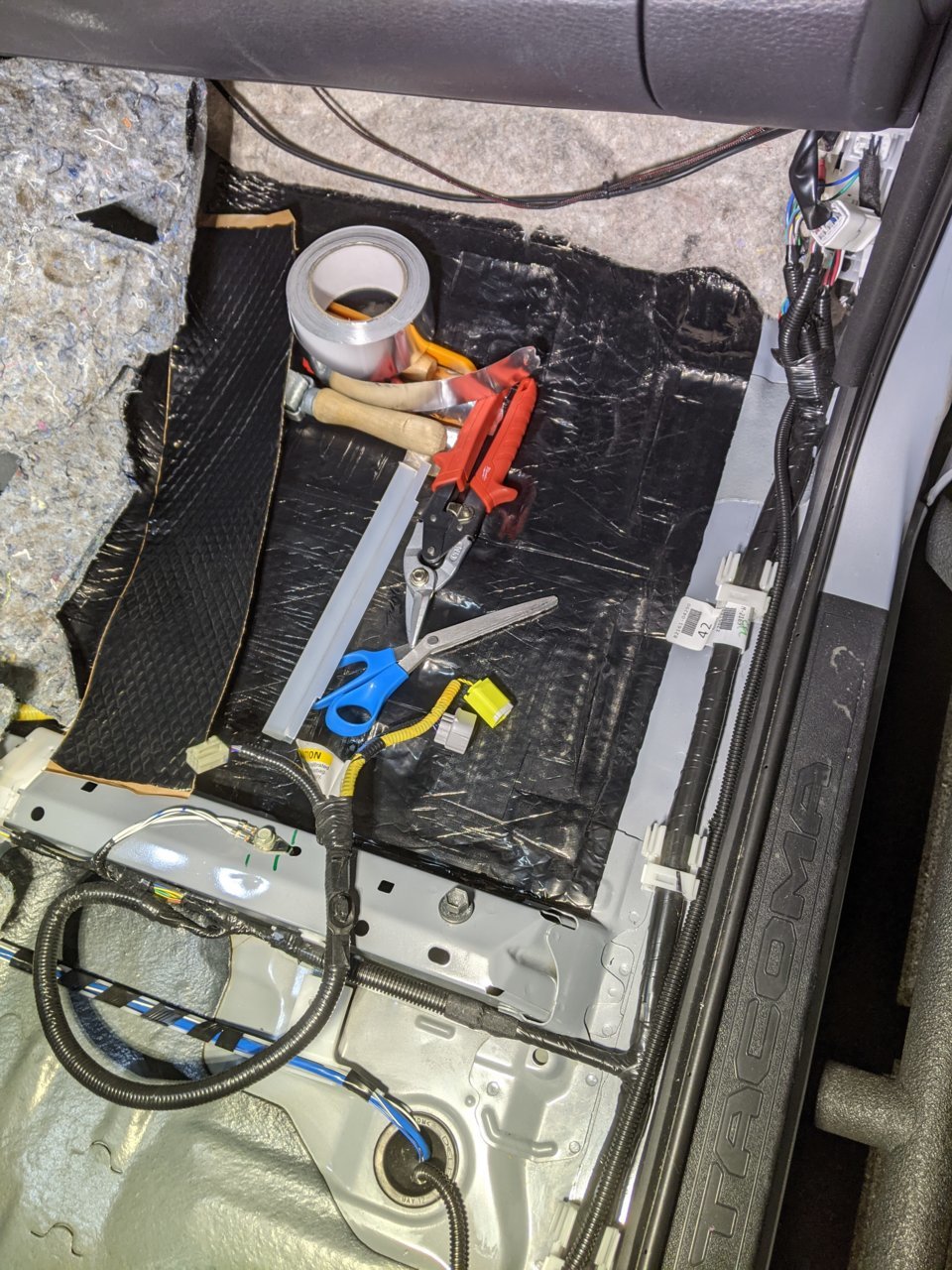

    So Hushmat is pre-cut to your specific vehicle? I didn't see any mention of it pre-cut. Details state universal fitment and no mention of it cut. Picture shows it folded in full sheets. I figured maybe going by model numbers would show it for specific vehicles, but search showed it also fit older model Chevy Colorados. I know that the factory amp impedance is 2Ω for the subwoofer. Wanted to try to keep things looking factory and not go for another box. That would put my wallet into a whole new world of hurt. I'm big on buy once, cry once but the JBL is a curveball. So I'm gonna half-ass, cheap ass this one and hope it sounds good enough.

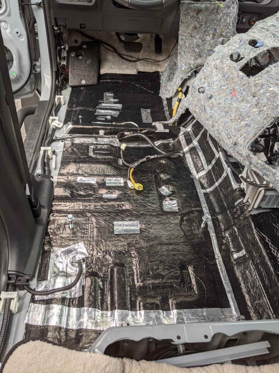

    Some more progress today. No one said how sore I'd be. Maybe it's just the Covid dragging out.
    1. Whoever said it only took a couple hours to do this, you're a fucking liar. You're not cool. You're not impressing anyone. You're own mother hates you.
    2. If you're OCD, just stop. Don't even return the stuff to Amazon. Just take it as a loss and give up.
    This asshole saying let's do this whole project. Not helping like he said he would. Just lounged up chillin'.
    Maybe I was a bit extra to foil tape every edge it meets and any holes that got poked. Guess I lost a lot of time doing just that. Maybe it's not necessary at all. But in my mind, if it's to lessen vibrations the foil tape will seal out the tinier vibrations!
    This stuff is lame. Very soft. It shreds just from weight on it and the adhesive is done once it touches something. There is no reapplying it.
    So I started shaking these around. I heard the modules rattle ever so slightly. So I Tesa taped that too. Might as well while I'm in for the night and watching TV. Also Tesa taped the air ducts that run down and under the seat. Just where they connect. You know why? I shook it and it made a noise.
    drizzoh, TRP and GRNT4R like this.

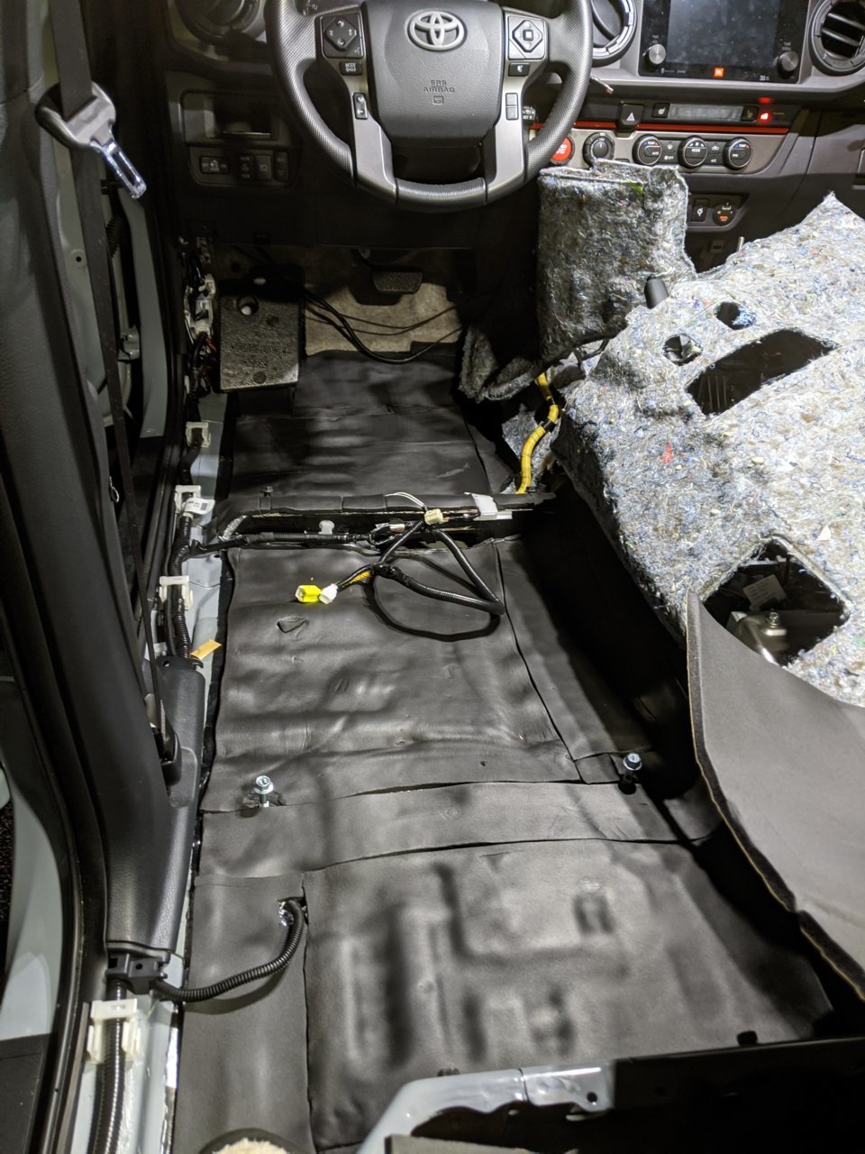

    Am I overdoing it? First time sound dampening a vehicle. I'm just winging it. Probably offset the weight by not putting everything back in because I don't know where it goes. Lol.
    Also debating on the roof. Should I do it? Ughhhh.

    Hi,
    Still sorry about the COVID. I would be in bed crying to the wife.
    I would do the roof. It is just sheet metal with not much support other than a few cross bows and a few contours. Plus may reduce wind noise.

    What I have in material:
    2 - Noico 80 Mil - 36 sq/ft
    3 - 315 Mil Closed Foam - 16 sq/ft
    2 - Noico 80 Mil - 18 sq/ft
    1 - 118 Mil Closed Foam - 16 sq/ft
    Which should cover everything from the firewall, floors, back wall, doors and ceiling. All around $300 + the roller. That alone is the roof kit. Wish it wasn't so much. Lol.

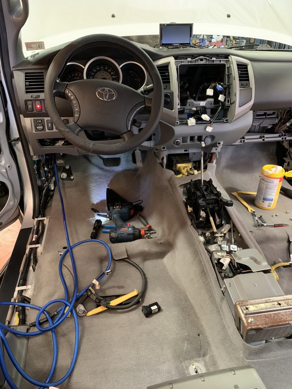

    I dont know if you are overdoing it but you are doing it right. I started on mine sunday by running amp wires and new speaker wire, changing the head unit and adding noico to the doors. hadnt gotten around to swapping out my speakers yet but the Kenwood radio and noico really woke up the factory speakers. Once i decide on the amp, i'll be adding that and my Hertz components. I'll start a write up soon once i get some free time.
    Your thread has been inspiring

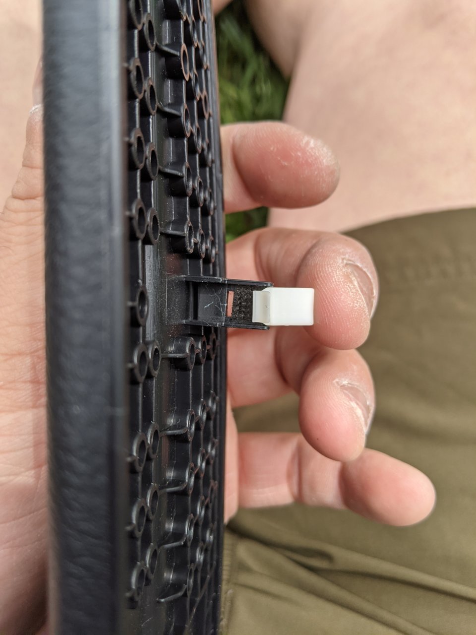

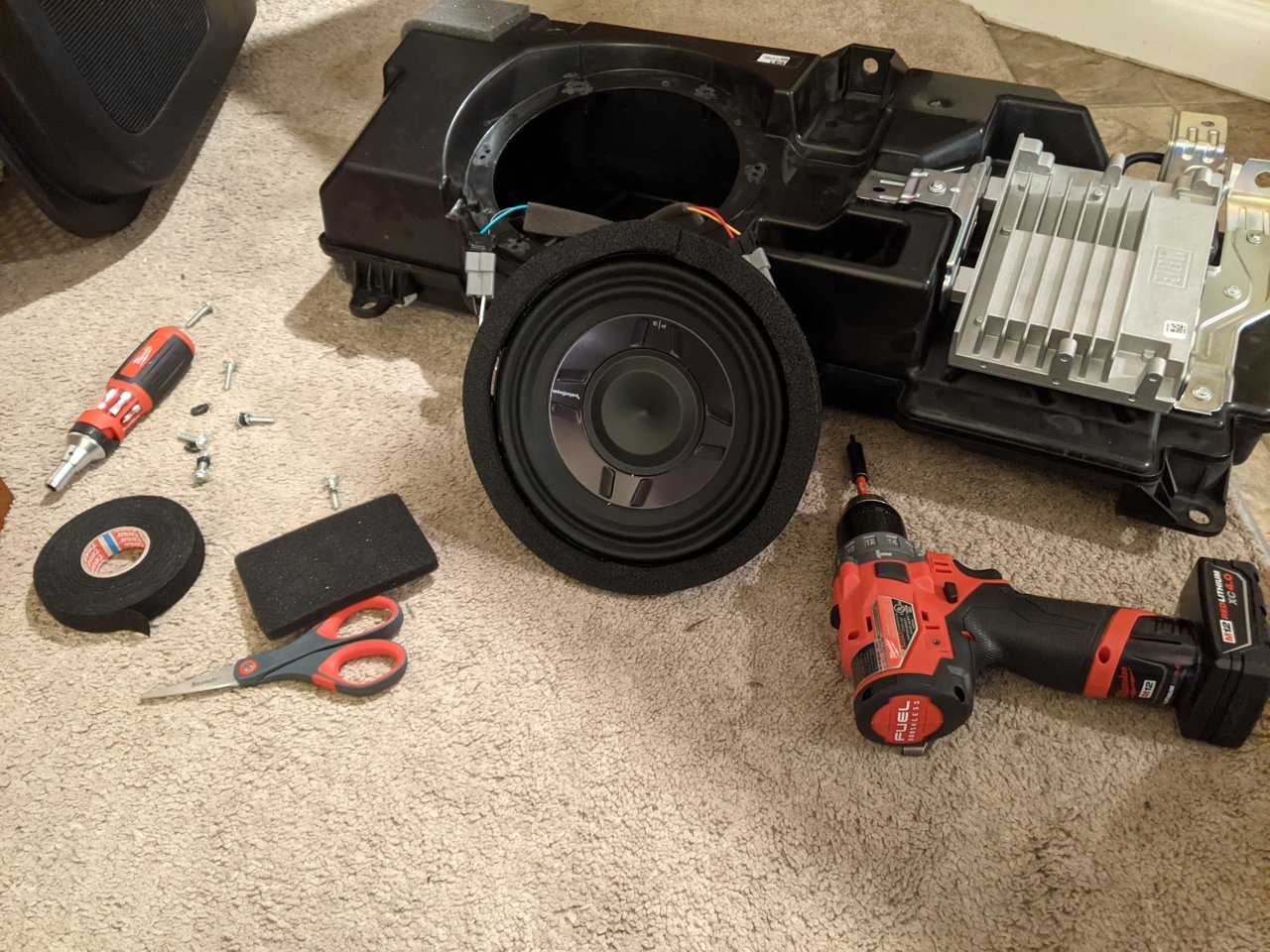

    Got the GX328's in. I ended up cutting more from the dash plastics on the passenger side and removed a tab from the speaker. Took a bit more trying to fit the speakers. Once I cut off enough material, I added Tesa Tape to where I cut. I put spacers /washers on the driver's side to lower the front for clearance. I did remove the metal tabs on both sides towards the front then cut those parts off. Maybe the GX302 is a different size than the GX328 or there are slight variances in manufacturing Tacoma wise. Like the backwall insulation. Some have the nice black liner. Mine had the crap fabric blend.

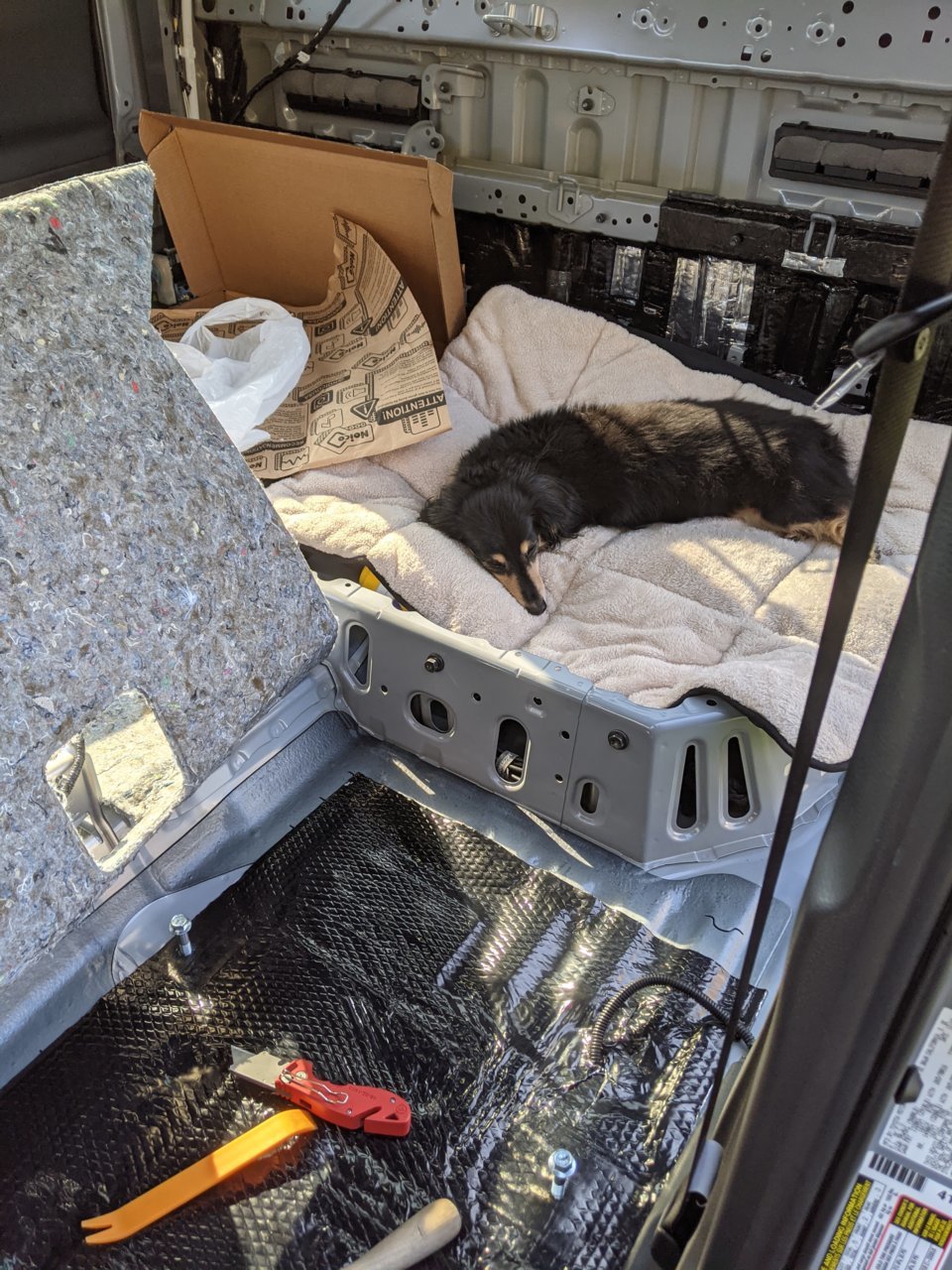

    More Tesa Tape.
    Driver and passenger done. Now the backwall. Beginning to worry where all the screws go when I put things back in...
