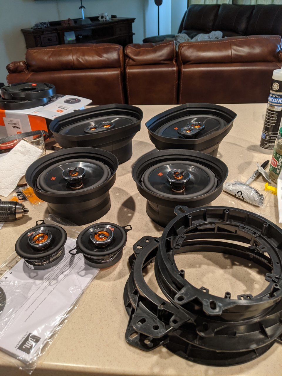

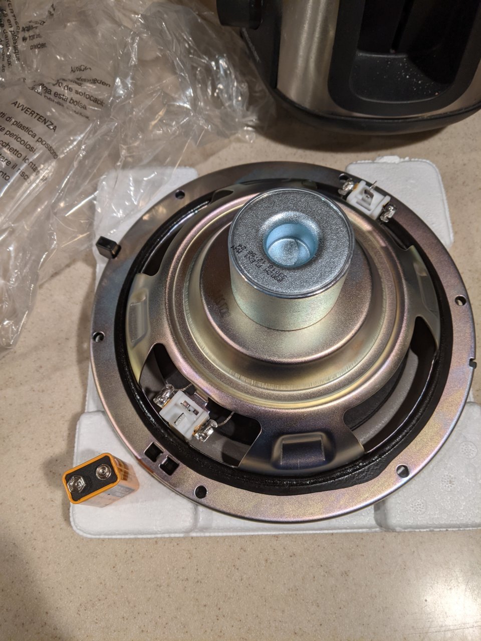

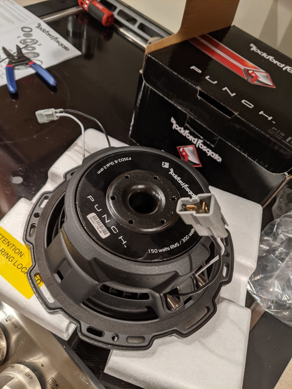

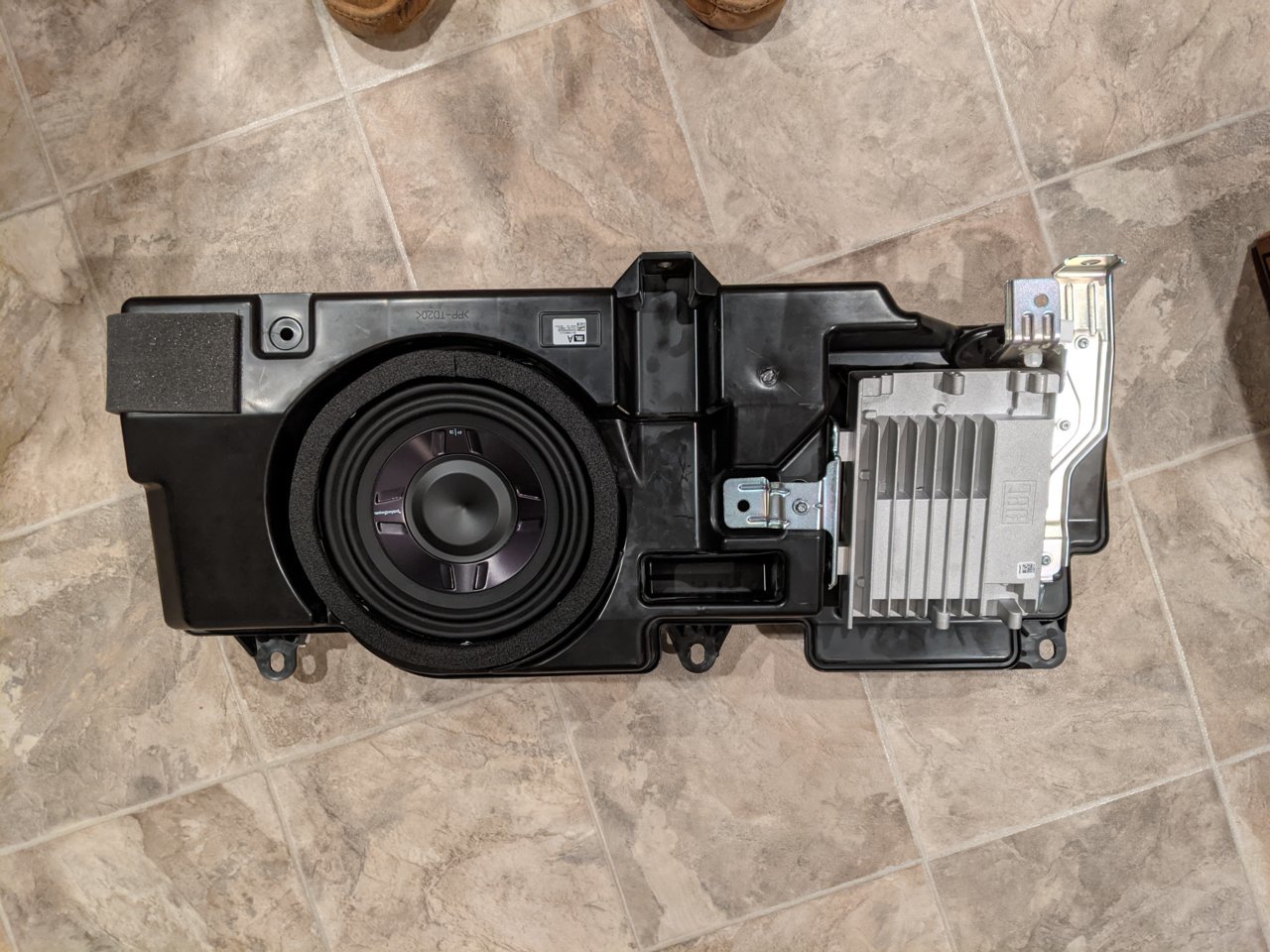

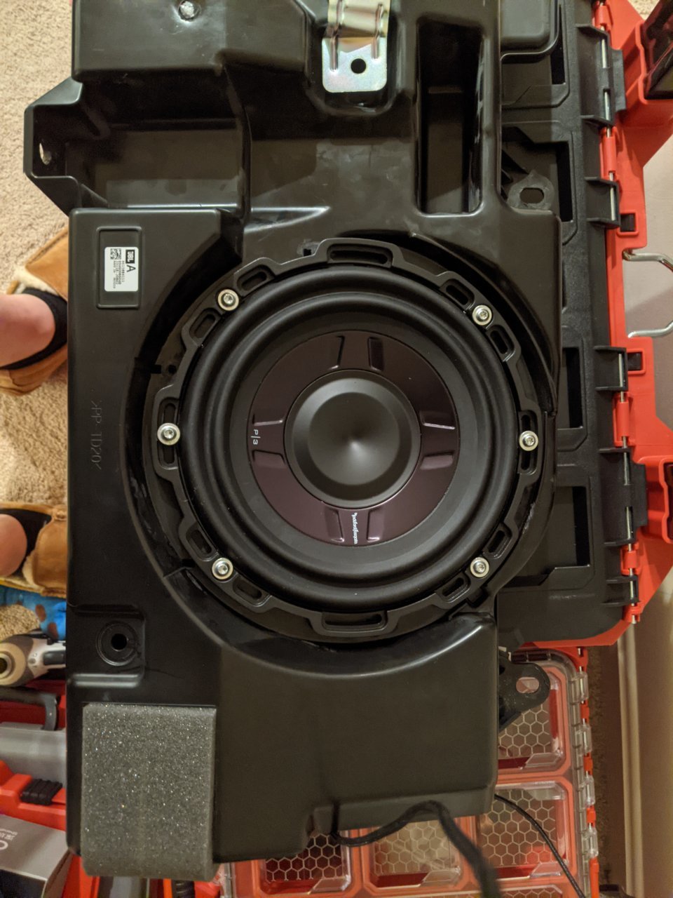

    After following all the upgrades for a while I finally bit. Started with the subwoofer. There's always been mention of this replacement. No one took pics. Figured I'd share hoping it would help someone.
    I'm keeping the factory amp. I'm only swapping the subwoofer and speakers. Hoping for better sound quality.
    2019 with JBL Premium

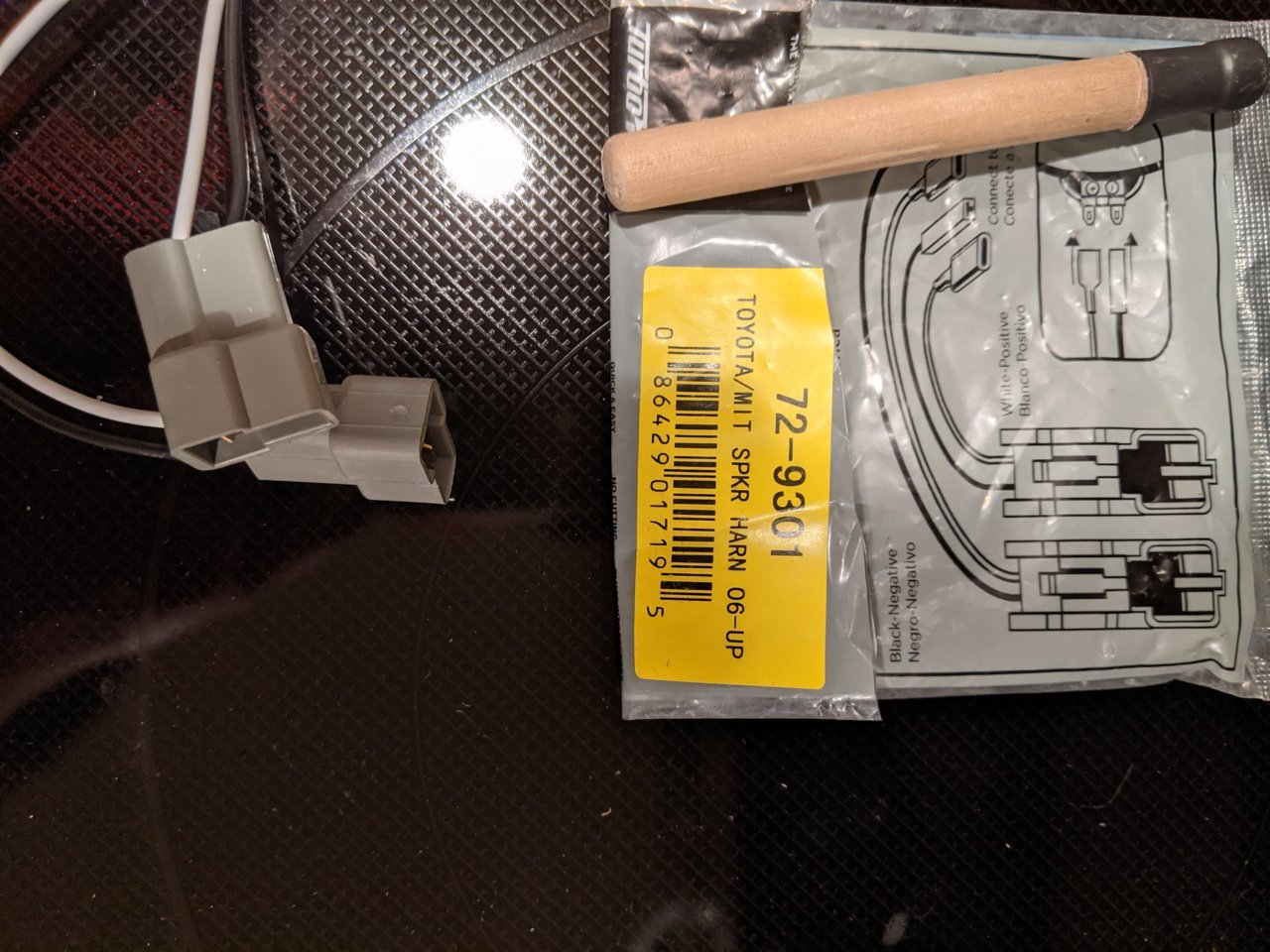

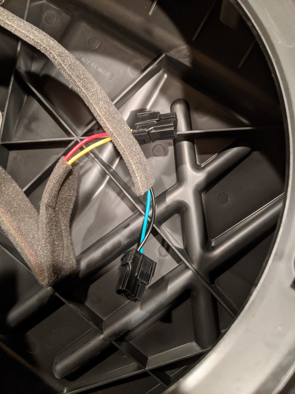

    Connectors:
    Upgrades:
    Have to give credit to @TacoManOne. He took some time to answer my questions and even checked up on me to see how things were going.

    Any noticeable difference in sound? Did you add a different amp for the sub or is it still using the factory amp

    Stock amp power that sub? I added a 12in to mine but had to add an amp.

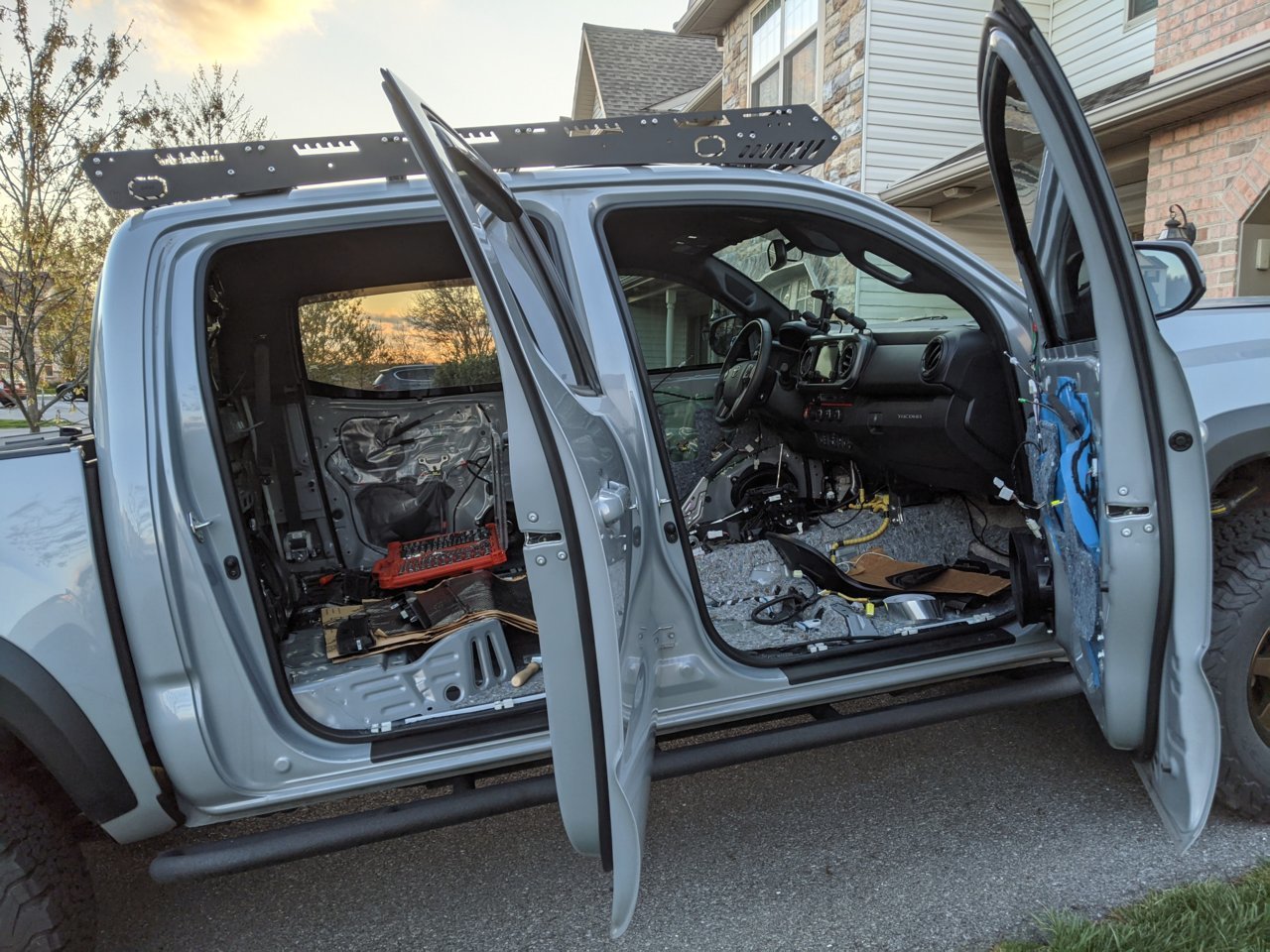

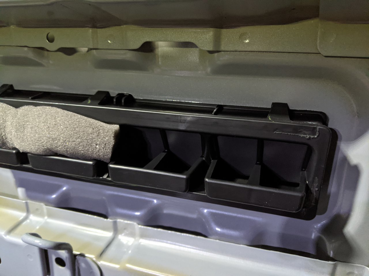

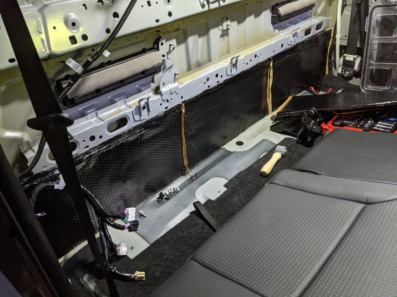

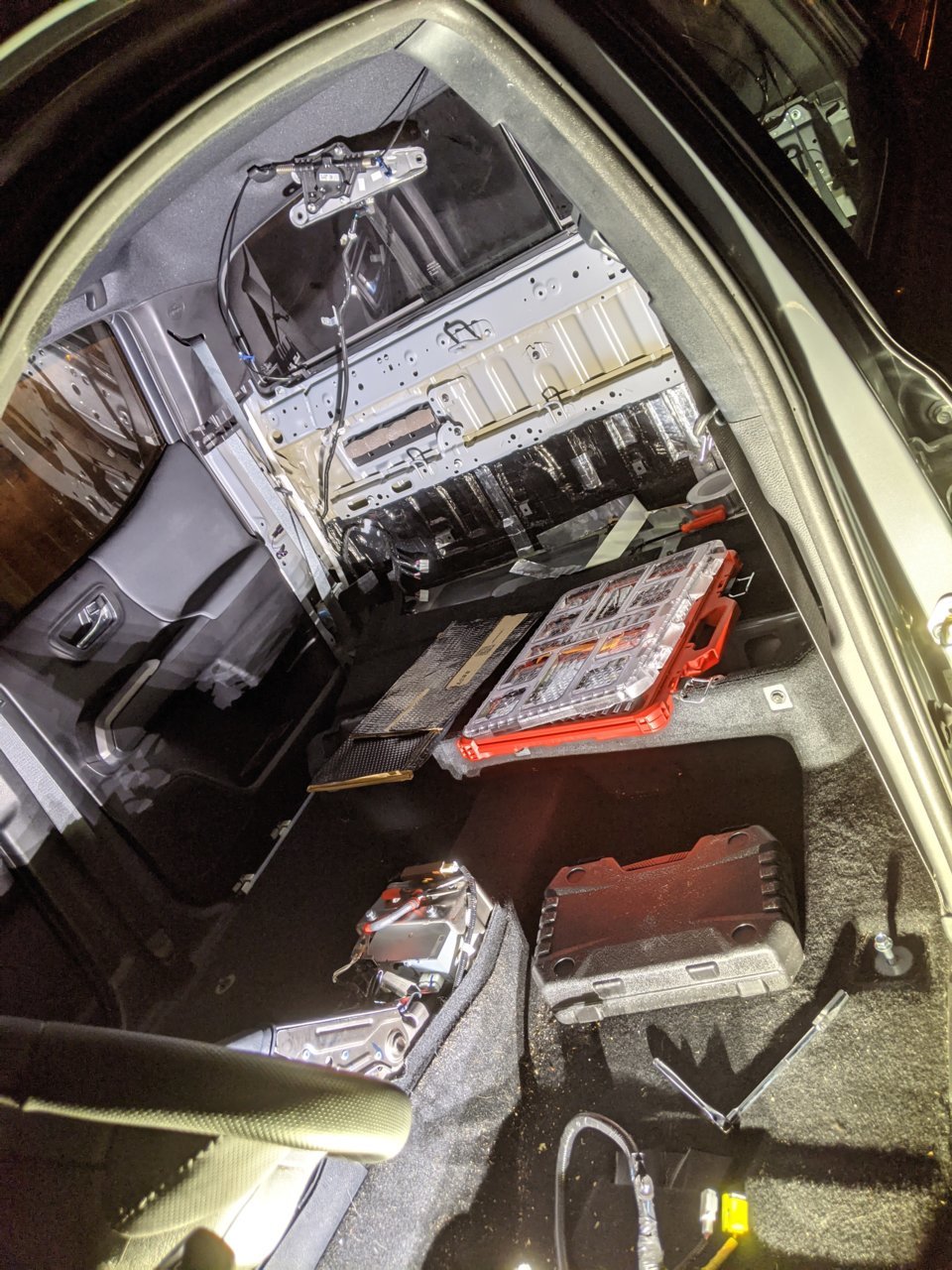

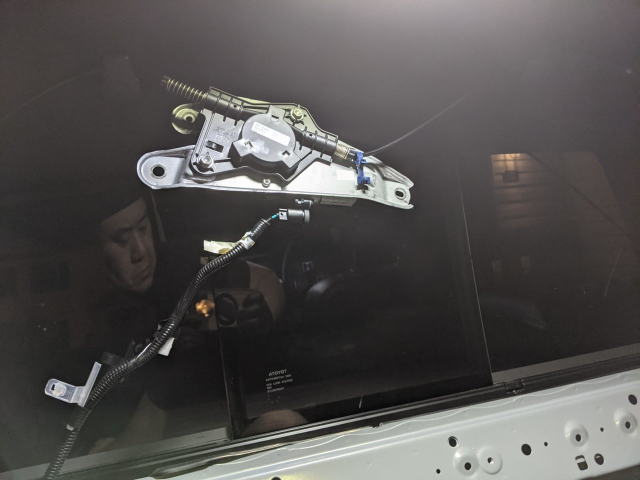

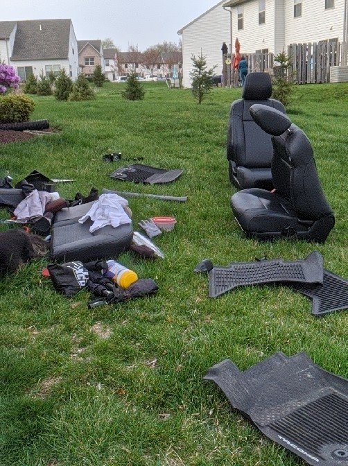

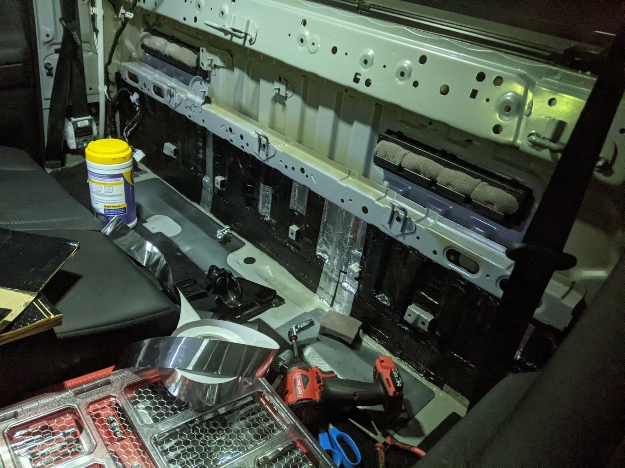

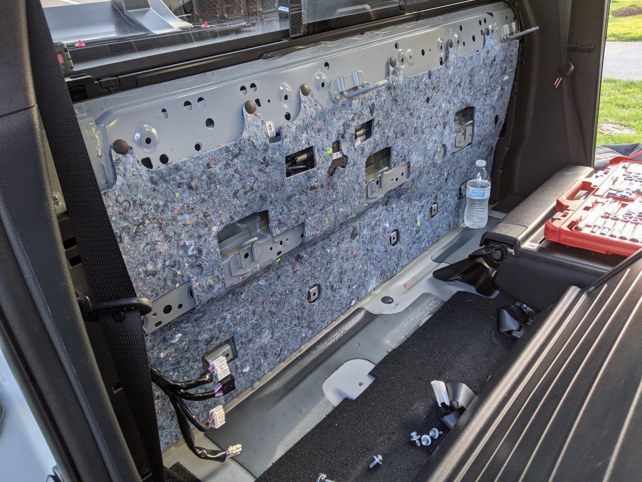

    Take the seats out. Don't have to remove the bottom. I'm skipping doing the floor.
    Hang slider motor and pretend to be a ghost.
    Tell dog he's a good boy and have snacks.
    Degrease and foam.
    NOICO 80mil sheet cut in 1/3 fits most of the bottom.
    Open cell A/C foam to seal vents. Just play around with it. I figured I'd would be best if they weren't just held open. Check between cab and bed.

    Still going... 10/10 not recommend. Was planning on just the back wall. Audio friend talked me into doing more. Skipping the ceiling though.
    Obnoxiously throw things out of the truck piece by piece to upset HOA people.

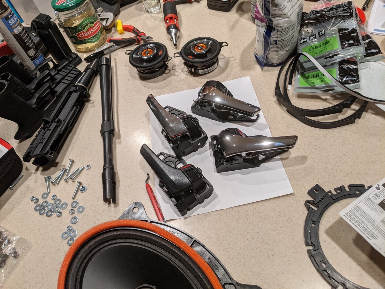

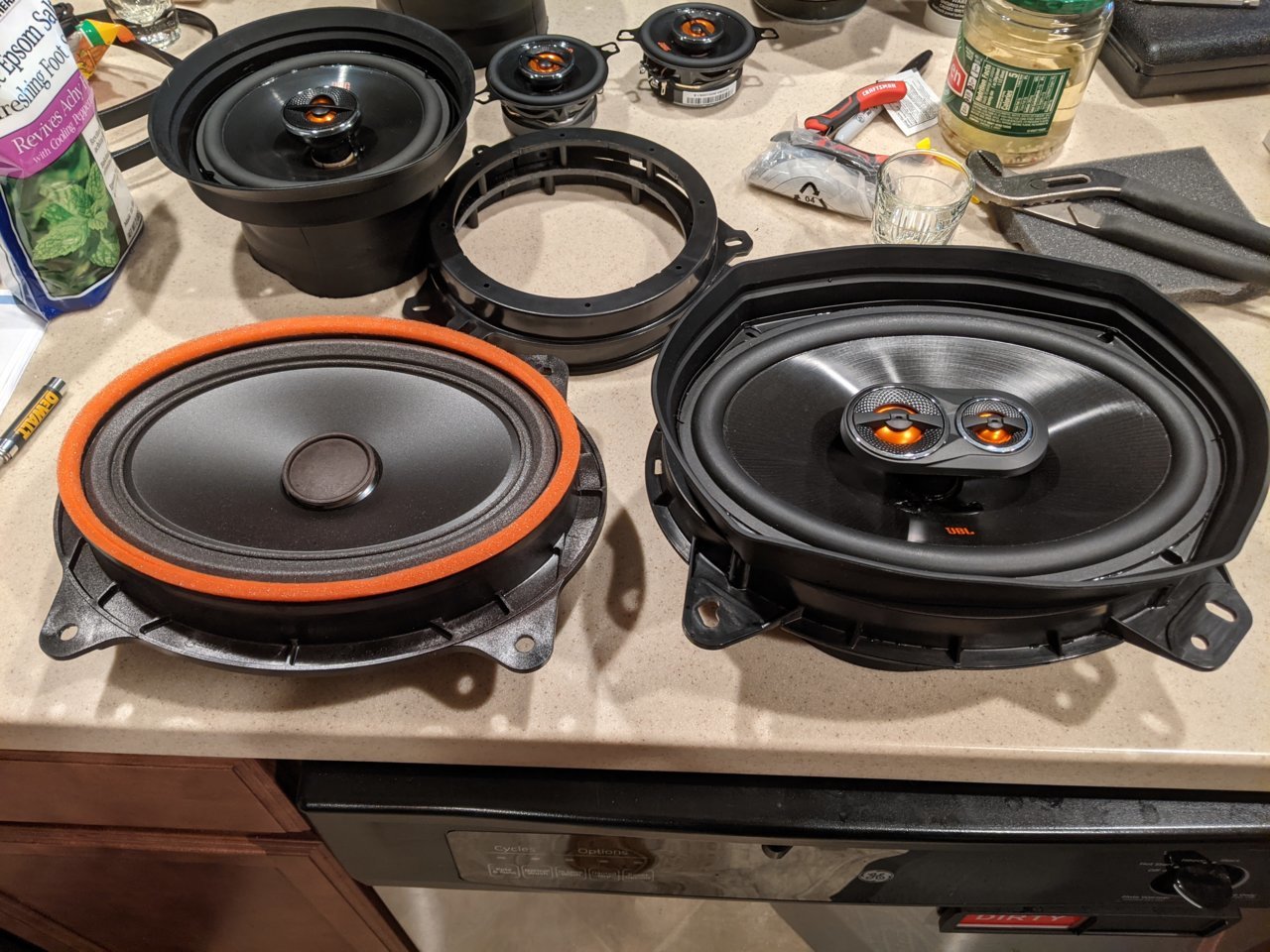

    Front and rear speakers are in. Sub is in. So far seems to sound better. Need to play with EQ and also finish putting things back together. A lot of noise is added from being apart.
    Might as well swap these in. Removed the rest of the chrome left. Now going to try to sell these to the 60+ crowd. Old people love chrome.
    Link got a haircut. I did an OK job during all of this. I get distracted way too easily.
