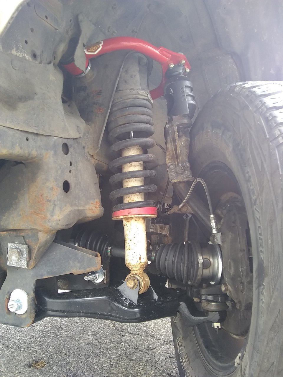

    Top is tilted in. I have a bunch of pics if you need more view.

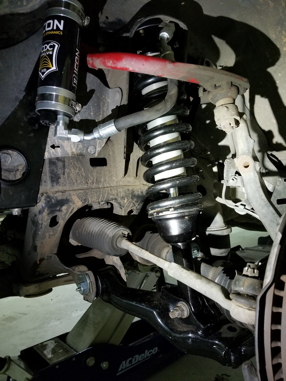

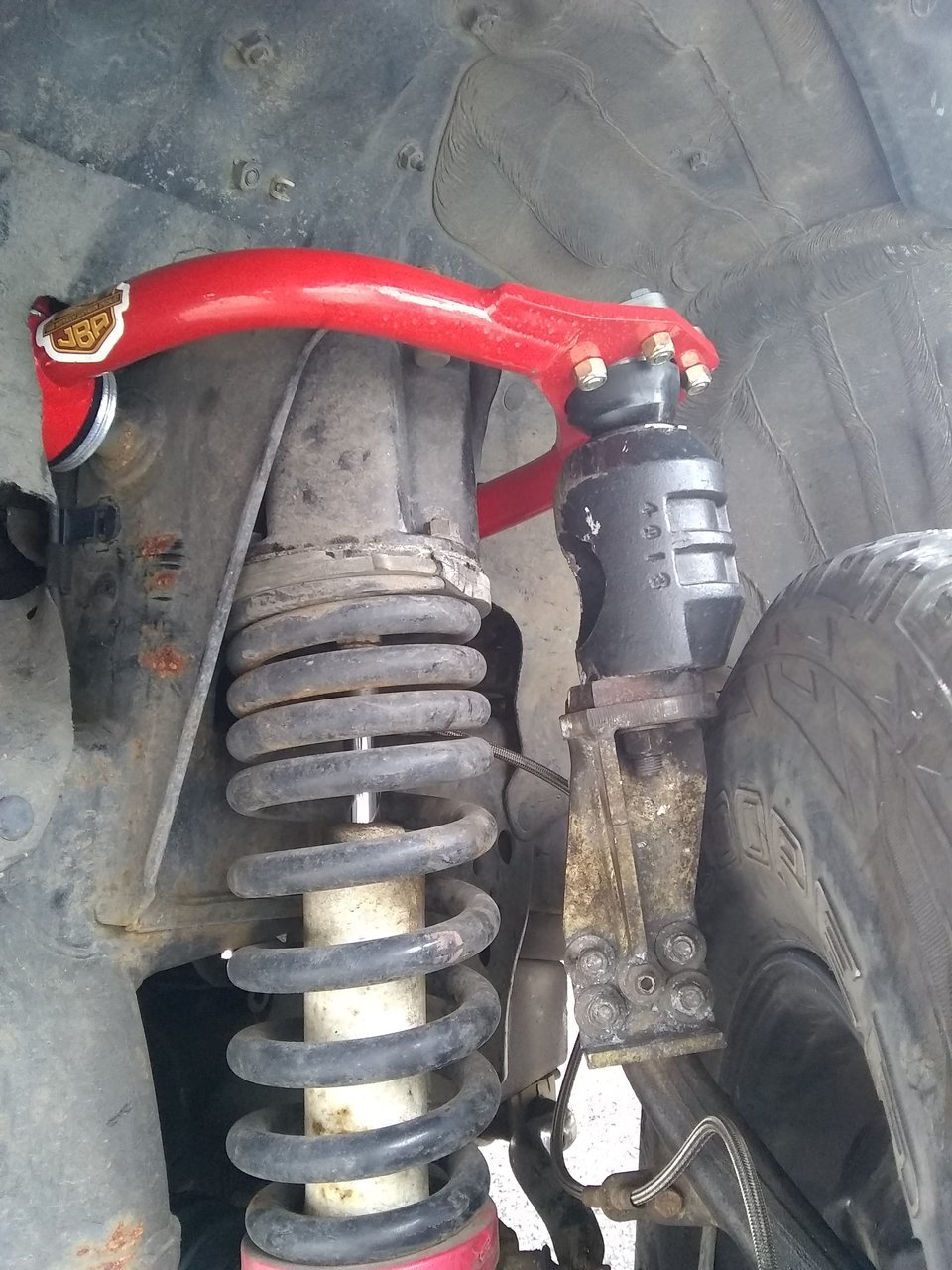

    What the hell is that spacer/block thing connecting the spindle to the UCA?
    Not my pic, but your setup looks different from other peoples...

    Well I have a 4" pro comp lift I'm replacing. Can't find 4" lift spindles. So pro comp comes with those scary ass spacers.

    This is current. Will be king coilovers in there end of the month.

    Well, the problem is obviously that you've installed some sketchy junk spacer kit.

    I still can't believe they added spindle extensions for gen 1 DB lifts, that's horrendous. Sorry man

    I don't think those spindle spacers are actually adding lift, they're just movingly the UCA up and out of the way, presumably so it doesn't be hit the coil. In order for the spindle to add lift, you have to move the hub in relation to the Lca- that's how lift spindles work.

    I don't think the UCAs are the problem. It looks to me like stacked lifts. Drop bracket and spacers on spacers. Once you get your suspension sorted out as a whole, then I'd start worrying about alignment numbers. Not bashing, just giving you some honest feedback.

    Woah, didn't even notice it was a drop bracket.
