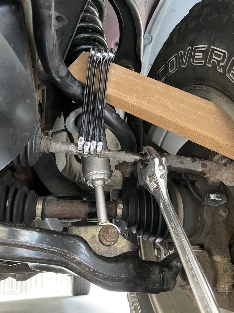

    With the four wrenches on there and a piece of scrap to hold 'em, got 'er done. A little penetrating fluid and some muscle (such as it is) and I got it backed off enough to make the adjustment.
    Thanks for all of the suggestions and encouragement. But I think I'll get a nice wrench like @6 gearT444E has for a more general-purpose solution in the future. :thumbsup:
